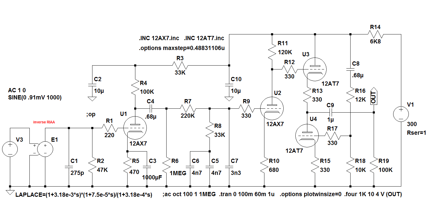

BTW, here's a Laplace with a correction factor for gain. I.E. 5mVin=5mVout.
Code:LAPLACE=(1+3.18e-3*s)*(1+7.5e-5*s)/((1+3.18e-4*s)*9.8759)
Thanks for this!
To use this, do I place an input signal AC voltage in my schematic and place this LAPLACE= string as a spice directive in my schematic? Or does this string have to be written into the .ac directive?

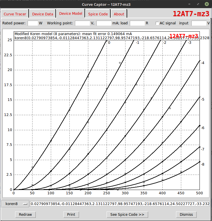

Try this 12AT7 Mazda model:Using your 12AX7 model (from the Mazda datasheet), I've been able to get an RCA-style RIAA (with Ayumi-model 12AT7 cathode follower) to output 1V RMS with <0.05% THD (all 2nd harmonic) in LTspice. Assuming that that result is 4X more optimistic than real life, I could expect something around 0.2% THD at 1V RMS out into 100k ohms in real life. That's my figure to beat.
Code:
* 12AT7_mz3 LTspice model
* Modified Koren model (8 parameters): mean fit error 0.149064mA
* Traced by Wayne Clay on 3/3/2014 using Curve Captor v0.9.1
* from Mazda Belvu datasheet
.subckt 12AT7-mz3 P G K
Bp P K I=
+ (0.02790974004m)*uramp(V(P,K)*ln(1.0+(-0.01128450125)+exp((2.13112283)+
+ (2.13112283)*((98.95747475)+(-218.6570898m)*V(G,K))*V(G,K)/sqrt((24.5022294)**2+
+ (V(P,K)-(-33.23286842))**2)))/(2.13112283))**(1.220154214)
Cgk G K 2.9p ; 0.7p added
Cgp G P 2.2p ; 0.7p added
Cpk P K 1.7p ; 0.2p added
Rpk P K 1.0G ; to avoid floating nodes in mu-follower
d3 G K dx1
.model dx1 d(is=1n rs=2k cjo=1pf N=1.5 tt=1n)
.ends 12AT7-mz3

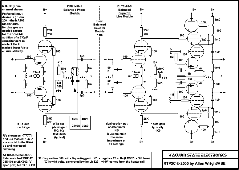

Most of what i know, I learnt from Allen Wright's pre-amp cook book. So if you want valves - here are valves. According to his web site - this was the pre-amp that Allen used.I'm looking to build a tube phono preamplifier (first time) for a recently completed Tubelab SE 300B, and would like some recommendations for kits or schematics. <snip>
What value is 1m0?
What value is 1m0?
It's not my schematic, I would guess its actually 1Meg. There is another resistor at output of the phono stage (after coupling capacitor) that is labelled 1m. This would logically be 1Meg as well.

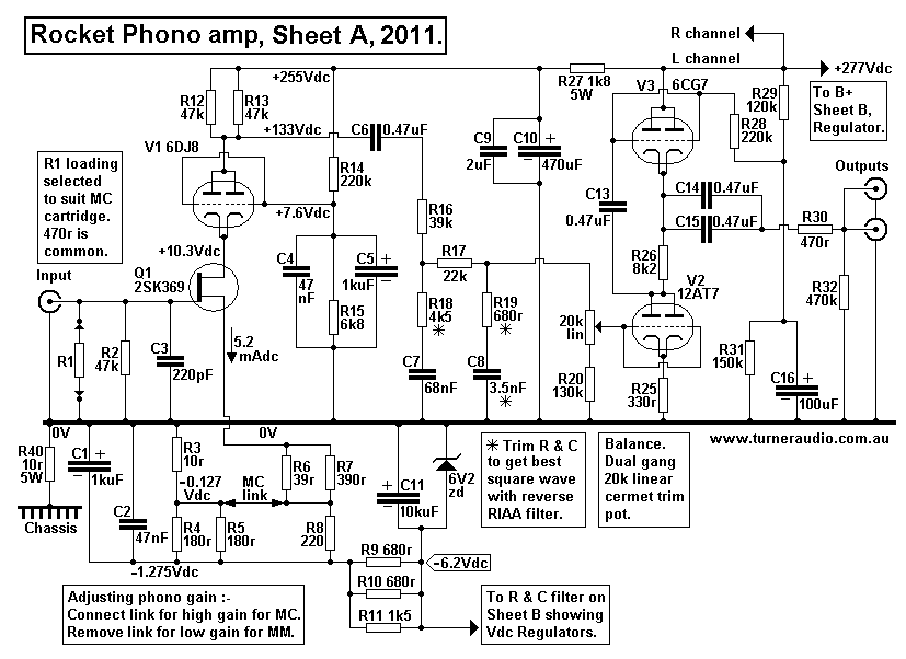

And i would be remiss of me to ignore another great Aussie designer. I had the pleasure to meet Patrick Turner in Melbourne recently. here is one of his phone stages.
do you have any pics to share? i exchanged emails with him, very nice fellow...
hope he lives longer despite his health concerns....
the Lapalce string is to be placed as value, using the symbol editor (click on the symbol)
Do I take a certain kind of voltage source from my pre-existing symbol library, and apply the LAPLACE string to that?
Here's a schematic you've uploaded with a LAPLACE statement in it:
Is the LAPLACE statement applied to the E1 voltage source? If yes, then what is that E1 device called in the LTspice symbols library? I haven't used that one yet...
Thanks for any help you can send my way, and my apologies for drifting off-topic here.
"e" voltage dependent voltage source (between diode and ferrite bead)
No photos, sorry. Patrick was down here in Melbourne looking after health concerns so hopefully things will improve. Send him another email I am sure he would be pleased with some correspondence.do you have any pics to share? i exchanged emails with him, very nice fellow...
On a brighter note - we had a nice Japenese dinner together and I showed him the schematic of my diy mosfet amps. 2 days later I get an email back with a new detailed schematic with lots of improvements. He is a very clever designer and very generous with his time and advice. I just need the time now to implement these improvements.
