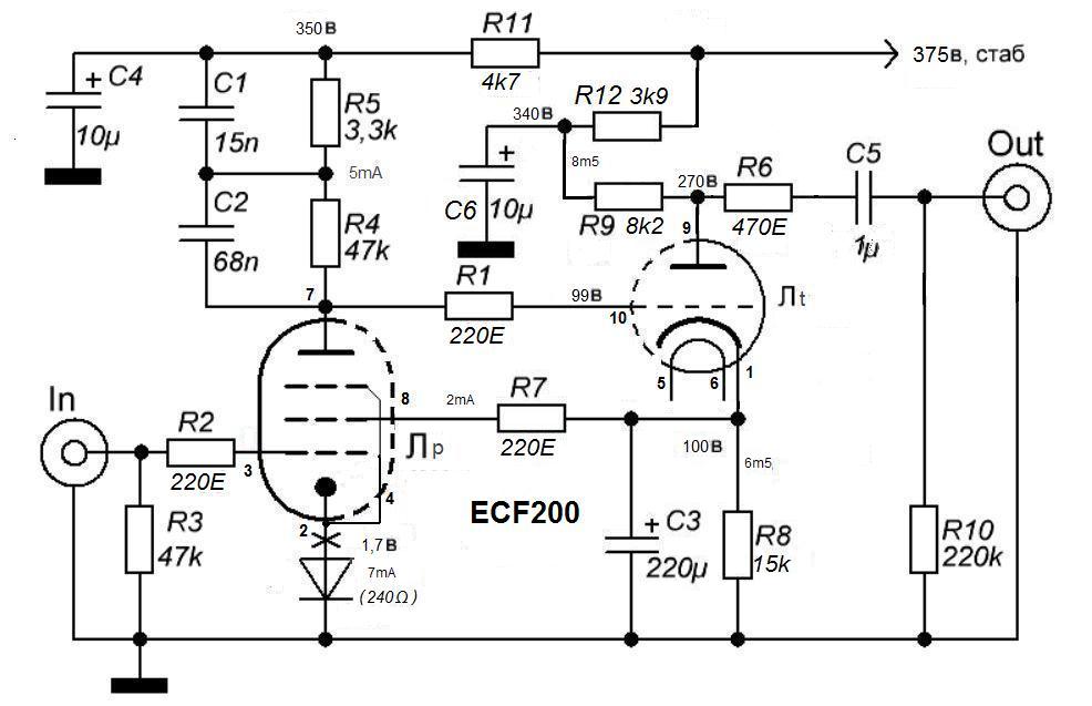

Rongon;"There's 140V dropped across R8, so
140V * 0.015A = 2.1 watts, so a 5W part should be OK for R8."
Nice, but R8 is 7k5. Current 140/7500=18.67mA ! not 15mA
The current in the triode has to be bigger than that in R8 since the screen current also goes through the triode.
Here the opposite is shown, the numbers don't add up.
Also the voltage drop on the led isn't right if you look at the tube data, more 1.9V not 1.65V.
I think Mr Bokarev has to go back to the drawingboard.

Good catch!
I was going by the voltages in the circuit diagram, which I assumed were all checked and correct. Hah! You know what they say... When you assume, you...
Since the screen current's there too, and 140V gets dropped across 7k5, making 140V at 18.67mA, then:
140V * 0.019A = 2.66W
Therefore, a 5W rated resistor would be just barely adequate. 7W or 10W would be the better choice.

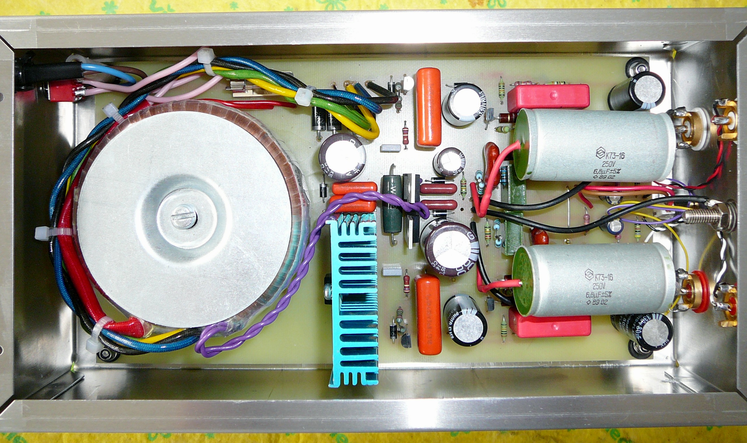

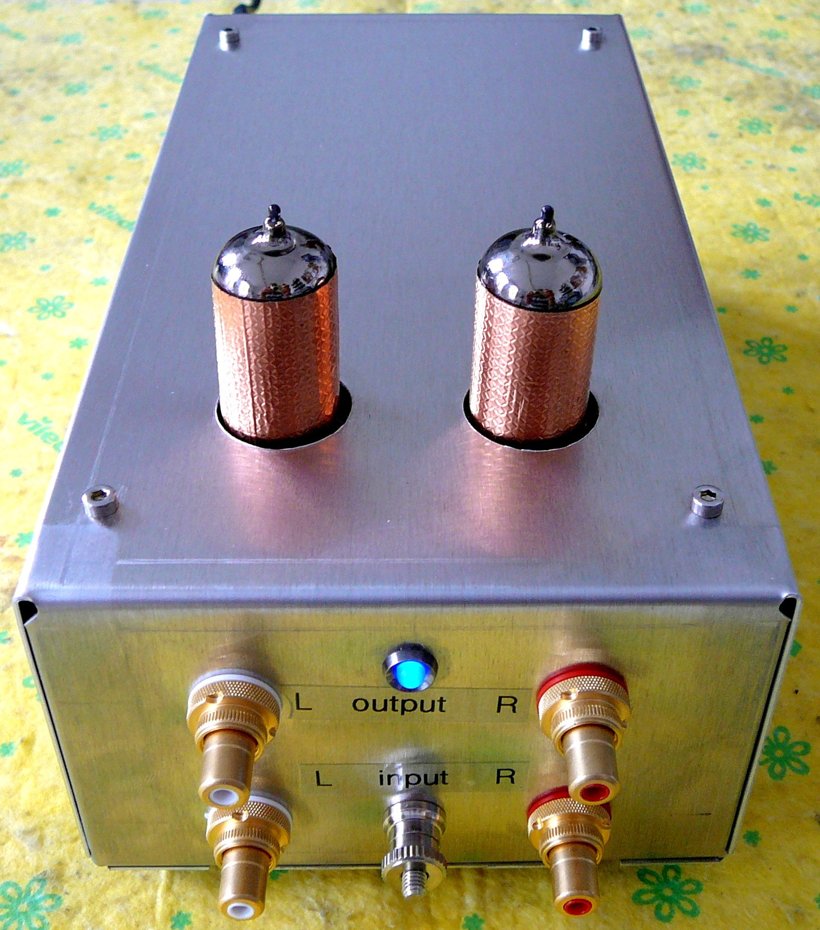

This is my version in a Hammond natural alu case.
Looking at that Bokarev pre, I was thinking why not use a triode/pentode tube ? All in one !
A problem is that most have the triode anode and the pentode control grid side by side, not very comfortable (oscillations)
But the ECF200 is ok, has 10pin noval like base.Only drawback, the triode is not very powerfull.Results in a somewhat higher output impedance.

You've got an 8k2 plate load resistor on the 12AU7, which is about 1:1 with the plate resistance of 12AU7. Distortion would be very high, wouldn't it?
Also, someone mentioned earlier that the Bokarev EQ uses the inductance of the cartridge to set the RIAA correction. That means the preamp will sound different if you switch from a relatively high inductance MM like a Shure to a lower inductance HOMC like Denon DL110. That could be a problem. Has anyone come up with a way to model that?
Perhaps the second stage triode should be something with low ra, like a 6N6P. That way you could get reasonable linearity and a lower output impedance.

For what it's worth...
I just simulated the Bokarev circuit (original but using an E180F for the input pentode and 6N6P for the output triode). I get a 'saddleback' shaped frequency response into 100k load:
-0.5dB at 20Hz
+1dB at 65Hz
0dB at 1kHz
+2.5dB at 10kHz
+2dB at 20kHz.
It also looks like the THD is rather high at 1.5V RMS output (0.1%), but we know LTspice doesn't predict distortion accurately. However, this circuit makes 2 to 5 times the distortion of other RIAA circuits I've been simulating.
