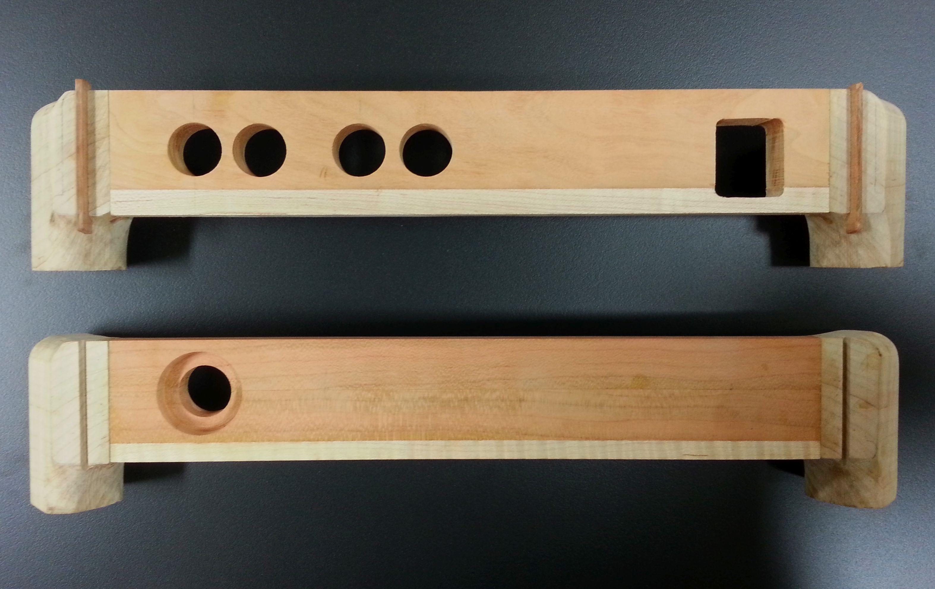

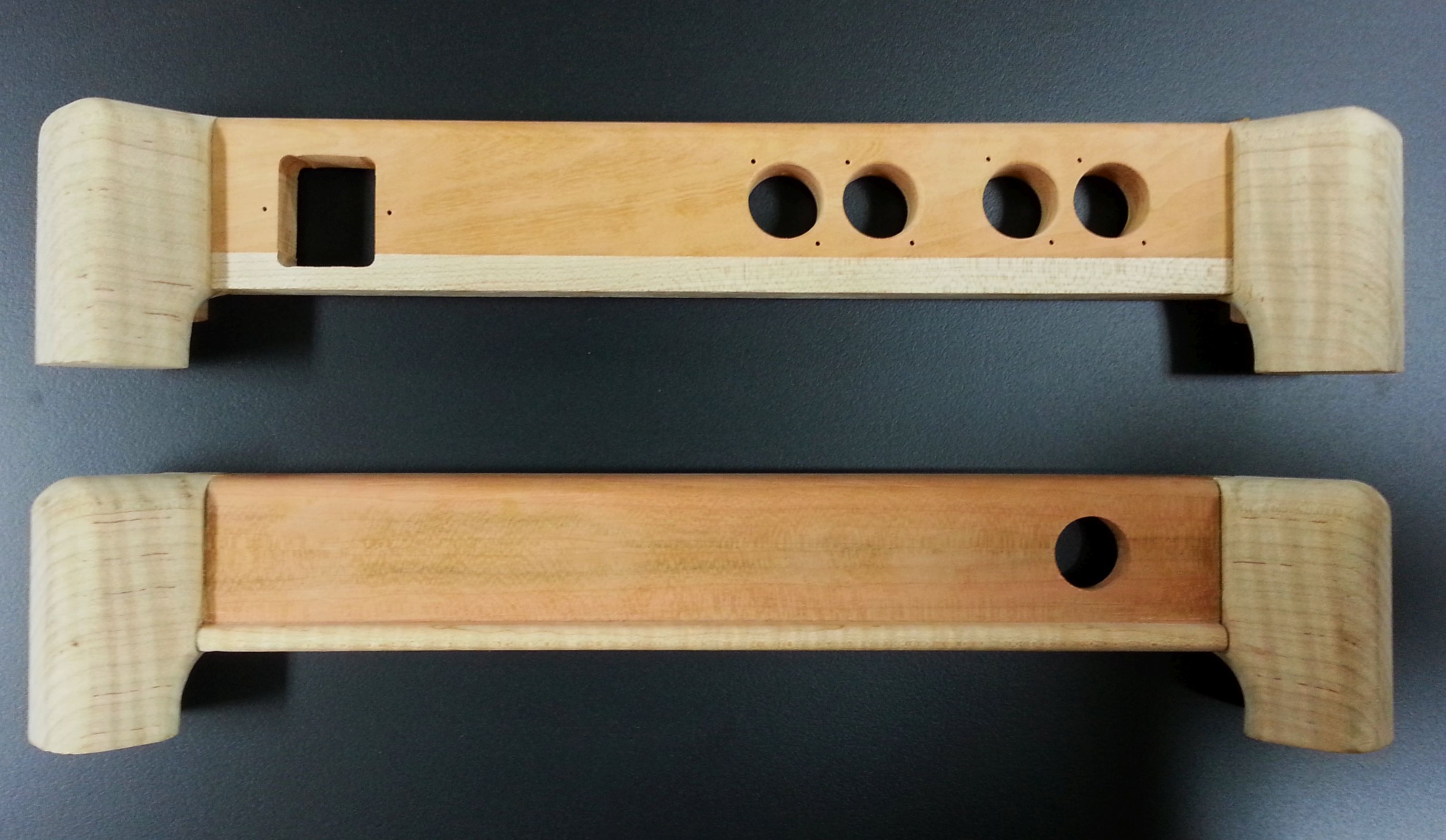

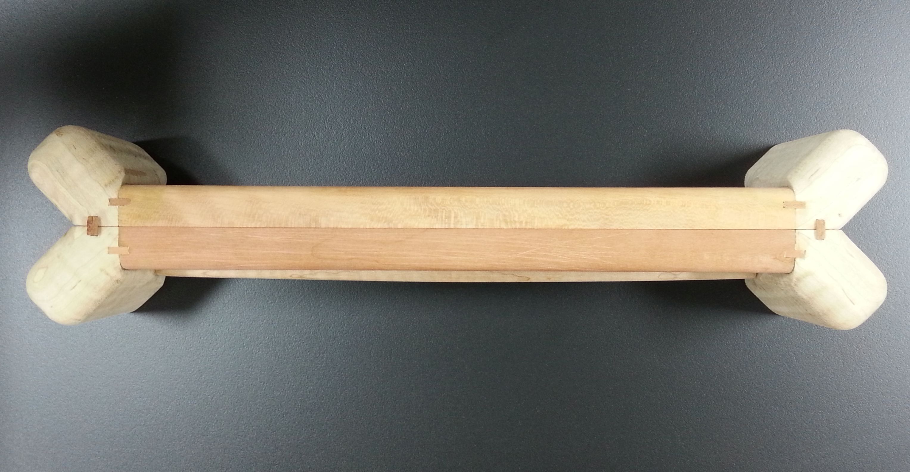

Here's a couple more pics of the chassis work so far. Sodacose: the first pic is for you; it reminded me of your tagline! :D I'ts really just test fitting the alignment of the splines by placing the front and rear panels together. The next two pics show the chassis rear (top) and front (bottom) from the outside and inside, respectively.

I knew you'd get the joke! Thanks for the kind words. The joints to the "feet" aren't as tight as I'd like, but this is my first build in over four(!) years. It's really just a fancy "burger box" (wooden chassis with aluminum top and bottom plates). The size of the four holes for the input/output jacks make it look as if I'm using XLR connectors, but they're really for these nifty Neutrik RCAs.
I'm using a shielded, filtered IEC power connector for the mains input, but otherwise the build will be pretty much identical to Jeff Yourison's in post #9. The plan is to divide the chassis into two sections, with the raw PS components taking up about 1/4 of the space. The remaining components will be installed inside a shielded aluminum sub-chassis. I haven't decided whether I'm going to stand the tubes up like Jeff did, or go for the streamlined look and mount them horizontally within the chassis. :scratch1: What do you guys say? Would exposed tubes nullify the shielding? Enquiring minds want to know! :clown:
Tube shields are available, for very good reason. I like above chassis mounting, as ventilation is not an issue.
Those Neutrik jacks definitely have their uses. In addition to your situation, they can be used to replace old, closely spaced, connectors, without weakening sheet metal. The die cast housings are anything but flimsy. :)
You can improve the shielding of your enclosure by sticking copper tape to the internal wooden surfaces. Mouser stocks 3M and at least 1 other brand.
How about using sheet metal, or enclosure bottom panels by Hammond, etc, as a metal base on non conductive bases/plinths (very nice one above BTW).
I use tube shields as well for my preamps/phonos, incl. 6dj8s, 12AX7s and such, that are mounted above. They are aluminum but a little bit of shielding is better than none? Anyway, be careful since working with sheet metal without correct tools is a nightmare, so, YMMV/caveat emptor, etc., i have scars to prove it.

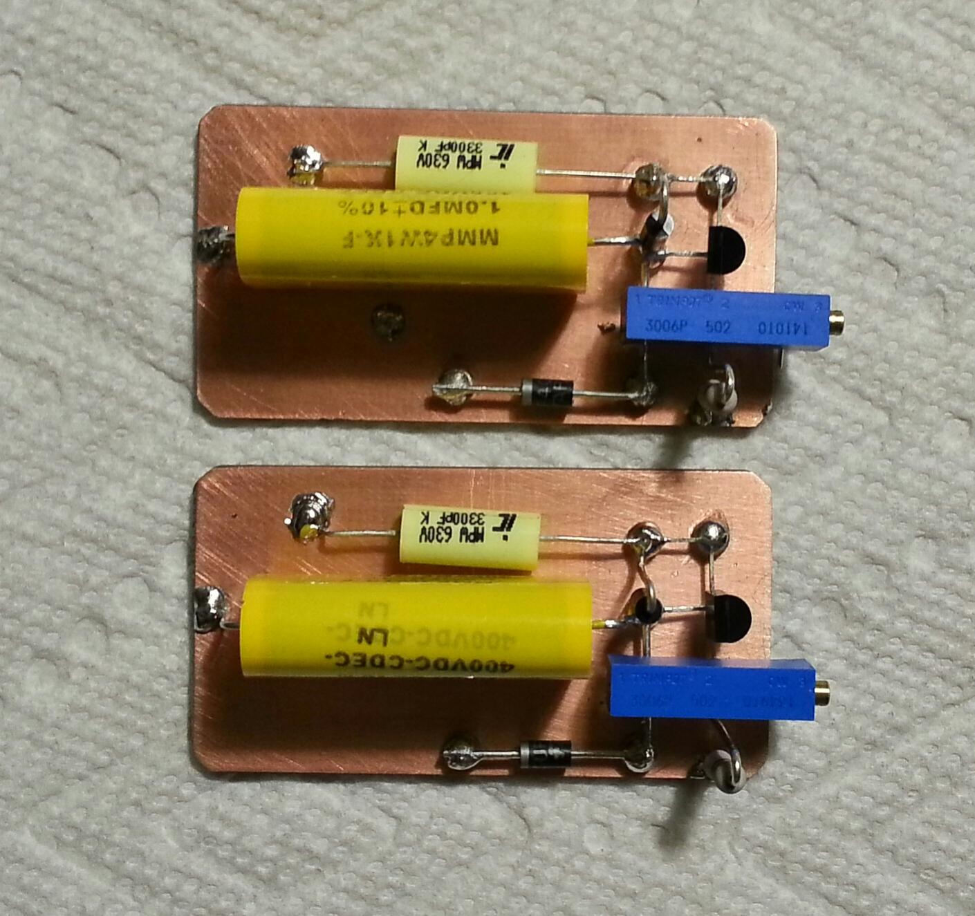

Hi pl802, and thanks again for the kind words. The pic above is of the two 250 VDC regulators in the upper right of the schematic in post 4 of this thread (I'd repost it here, but I'm replying via my phone). My ultimate goal for this build is to construct each subassembly on its own ground plane using punched PC board "islands". This is called "Manhattan" style construction, for those unfamiliar with amateur radio homebrewing technique. Pete Millet has built a couple of amps using this basic idea, except he used proper insulated terminals (in other words, he didn't "cheap out" like I did!). :D
