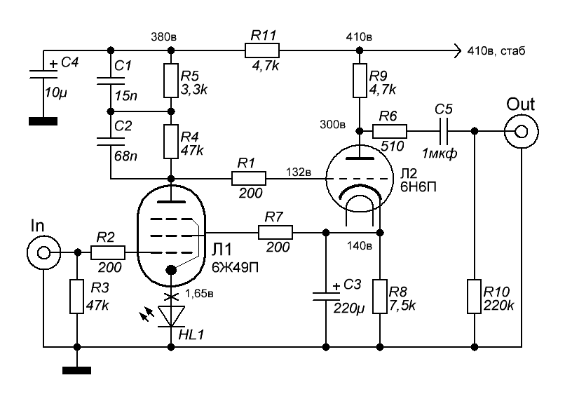

Erno Borbely EB-1195-221 is an outstanding tube phono with cascoded J-Fet input . Low noise, open, dynamic with great low level details,better than Pass Xono clone which I also built.I am not tube fanatic, but this preamp shows all the LP potential.
This phono preamp is better than many popular DIY projects. Dual mono, every gain stage has its own low noise regulator. Heater PS is also dual mono with soft start to save filaments. Transformers are in separate enclosure. Zero hum and noise even with 0.2mv cartridge.High overload, passive RIAA.

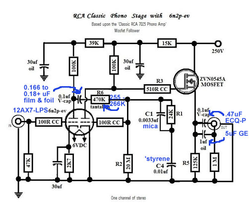

Thanks again everyone for the advice on projects and switching. Right now I'm leaning toward the VTA PH16 for its 0.2% RIAA accuracy, no feedback, well thought out loading options for a variety of cartridges, buffer stage to prevent interaction with the amplifier, and builder reviews that indicate wonderful musicality, detail, and a huge soundstage.
I'm still considering other projects -- including the Russian ones or trying to design something similar to the Wright WPP100C -- because people indicate the PH16 does not have that tube "sweetness," which is something I like.

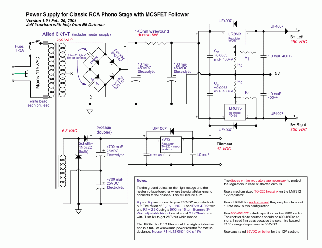

* Eli Duttman's modded RCA phono circuit and power supply (also here)

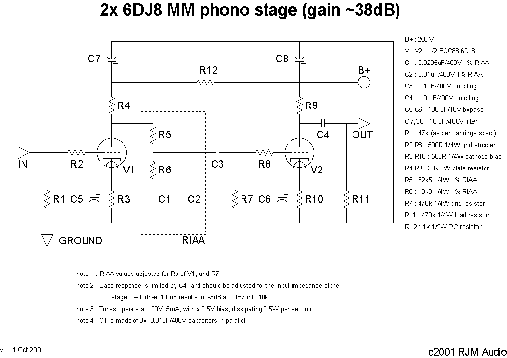

* A 6DJ8 project posted by lexx21 (he prefers 6N23P instead, LR8 regulators on the high voltage and DC filament supplies)

I've gotta say thanks to everyone here for a most inspiring thread. The wealth o' knowledge on this forum as a whole is incredible enough, but seeing the builds from Jeff Yourison and ClefChef has pushed me further into the depths of my disease and given me the itch to, well... build. I've constructed a small boatload of' power amps plus one preamp in the past, but I've never tackled a phono stage before. You guys have given me the "stones" (aka "testicular fortitude") to try.
What's also goaded me into action is the fact that the only phono stages I own are (1) an unrestored RIAA section in an old Harman Kardon "Ballad" integrated, ca. 1959, and (2) another unrestored jewel in the form of a Dynaco PAS3, which screams for mercy at every switch-on. 😀 The HK unit is basically sound, but the electronics are just noisy - mainly too many 50-plus-year-old slider switches in the signal path. As for the old Dynaco? Well, it is what it is. I think I can do better.
Eli's modified RCA circuit is appealing for several reasons. First, it seems relatively simple for a not-so-newbie to build and troubleshoot. It's also proven; I've read many kind words regarding this design here and on other forums. The combination of tubes and solid state (Tubelab's "sand-based life forms") is intriguing to me. And finally, it's relatively economical for a DIY build (boy, do the parts add up!).

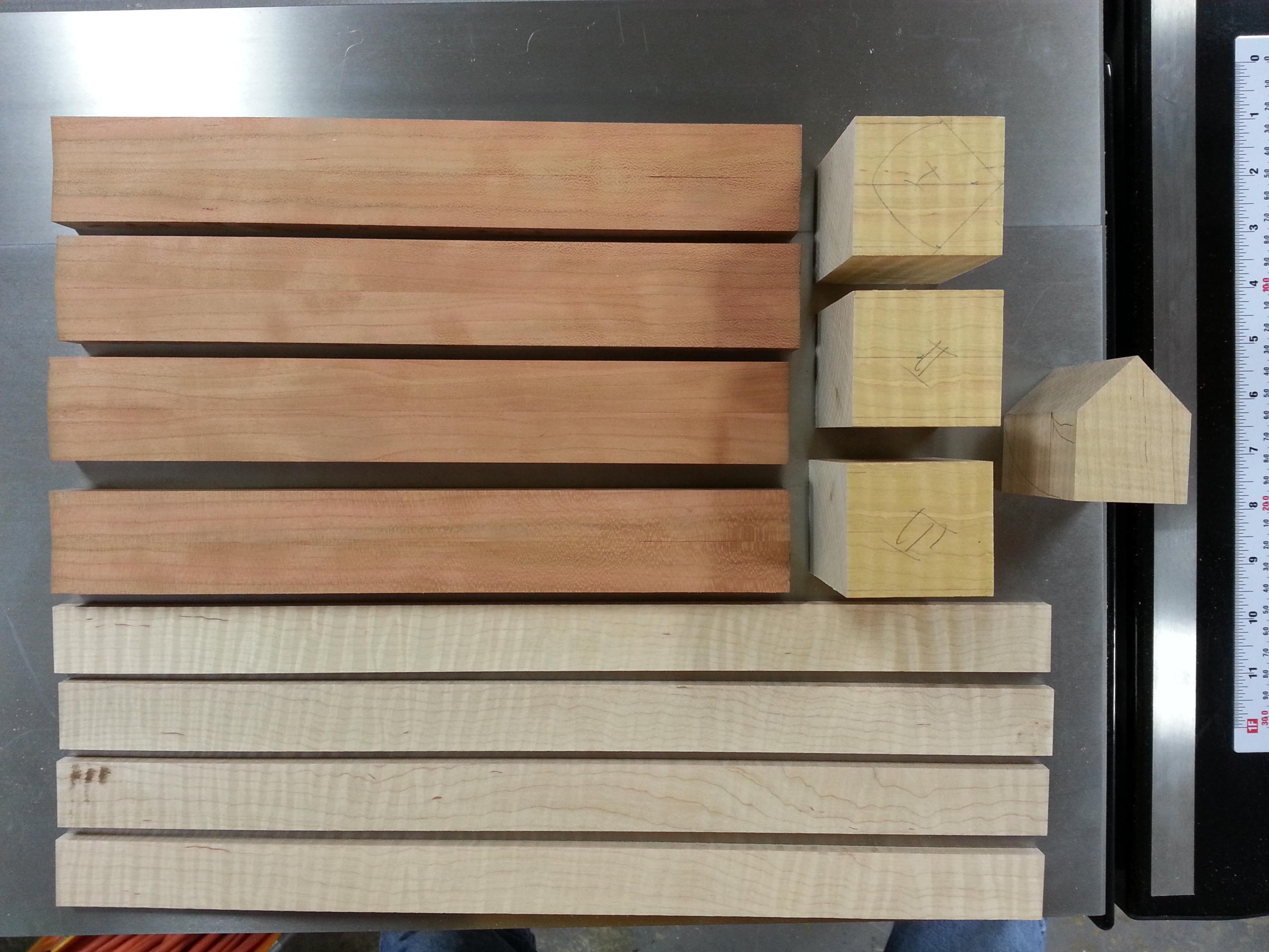

So while waiting impatiently for the parts to arrive, I decided to get cutting on the chassis. The first pic shows cherry stock for the front and sides being clamped during bookmatching. The second pic shows the basic chassis parts. The curly maple strips are trim for the cherry front, back and sides. The three curly maple blocks are for the feet; they'll be cut to the same dimensions as the part to the right that looks like "home plate".
