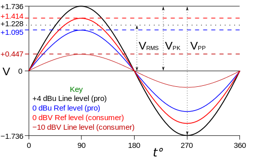

Hi, I think Im confused about what must be the output level of a phono MM stage, in order to maintain the same "loudness" when You switch on it, coming from a CD source.
Im talking with standard mid priced MM carts: Shure, AT, Stanton and the genre, the same program in the vinyl as the CD.
This chart left me unsure about the whole issue:
I need 1Vrms or 2Vrms?

I've asked myself that same question.
In the digital world, there is a standard. For 0dB Full Scale (0dBFS) from your source, the analog audio output signal should be 2V RMS (2.83V peak) into a standard load, usually 100k ohms, 47k ohms, or 10k ohms. That's the standard output level from a CD player, DVD, BD, etc.
Smartphones and other battery powered, portable players typically output only 1V RMS from 0dBFS input.
In the analog world, there is no standard. A typical MM phono cartridge will be specified to generate a certain signal output at 1kHz from a certain deflection of its needle, typically (but not necessarily) 5cm/second.
The specs for Shure M97xe cartridge say 4.0mV @ 5cm/sec.
They never state if that's RMS or peak signal level. Does anyone know? I'll assume peak.
I think that's supposed to be a typical 'average' signal level from an LP, not a peak level. Let's say the absolute peak level will be +10dB from that. That's roughly 3.16 times the level, so about 16mV absolute peak. Let's say we want 16mV from the cartridge to cause an output level of about 2.8V peak from the preamp.
2.8V peak / 0.012V peak = 175X gain, or 44.86dB gain
(I used Decibels to Voltage Gain and Loss convert calculation conversion amplification amplifier electronics - sengpielaudio Sengpiel Berlin)
I use a Denon DL110 cartridge, which is a high output moving coil that makes a bit less signal than a MM like a Shure. With the DL110 in mind, I aimed for 48dB gain from my phono preamp.
In my setup, 48dB gain from my phono preamp brings the level from my Denon DL110 to about even (subjectively) with the output from my CD player. But if I switch to a Shure (I have an SC35C) then the phono is subjectively just a hair louder than the CD.
I hope that helps.
ThanksI hope that helps.
So, a quick gross check can be: my phono got enough gain when, if feeded with a 1Khz, 1mV sine, it put out round 251mV..
I think (but I don't know) that with 1mV 1kHz sine wave input, anything from about 150mV to 250mV out should be OK.
