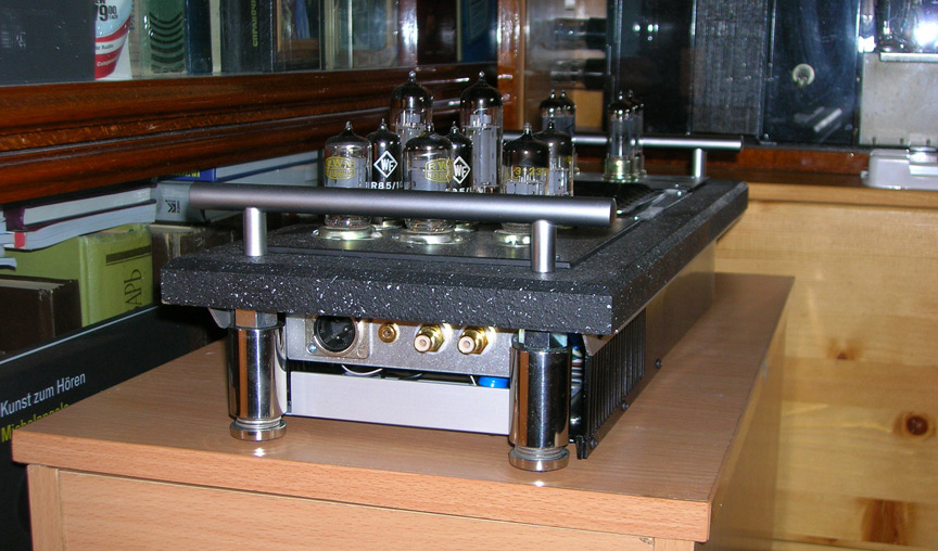

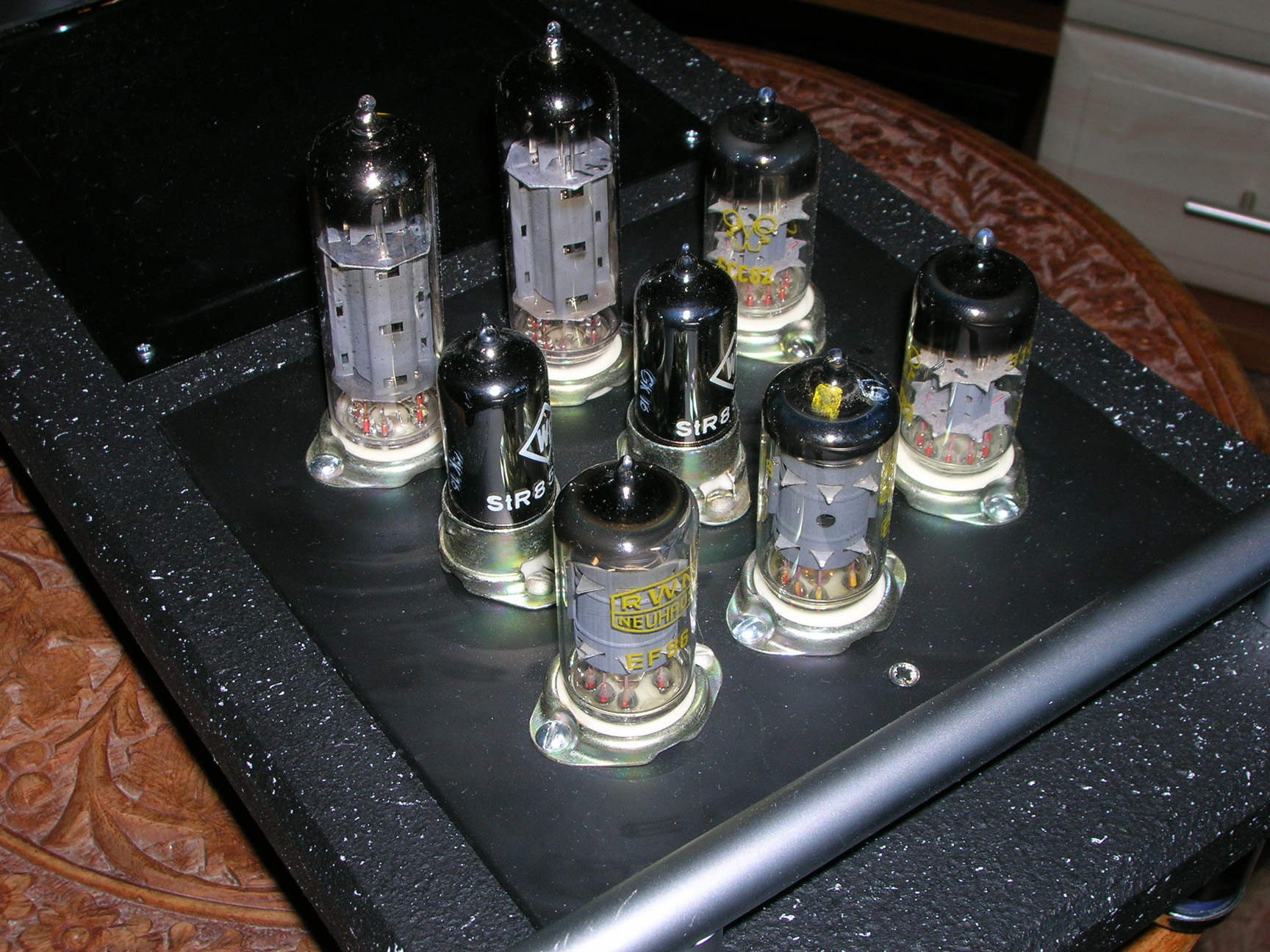

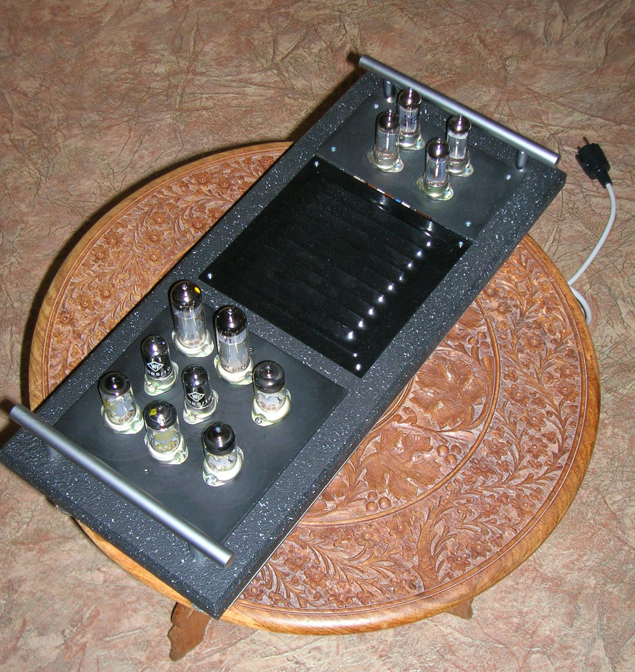

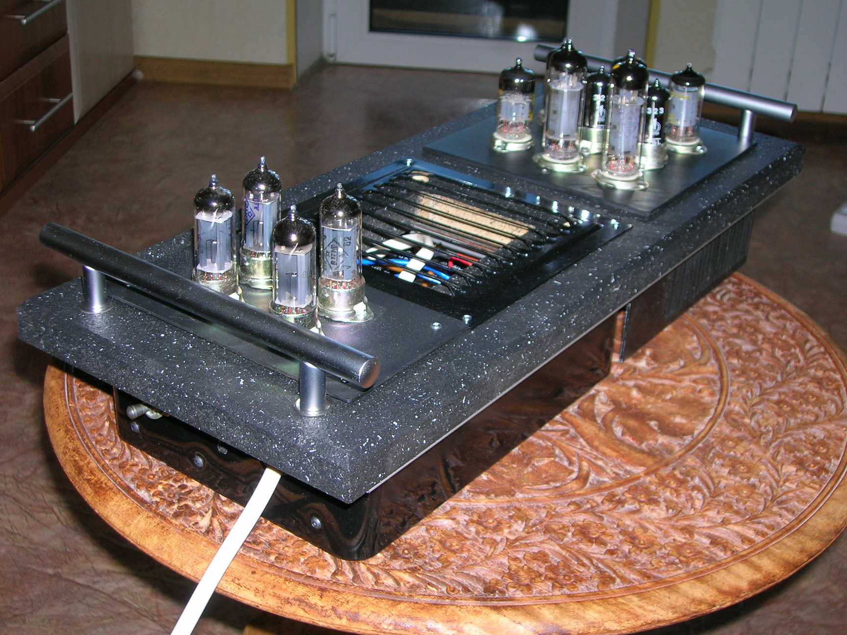

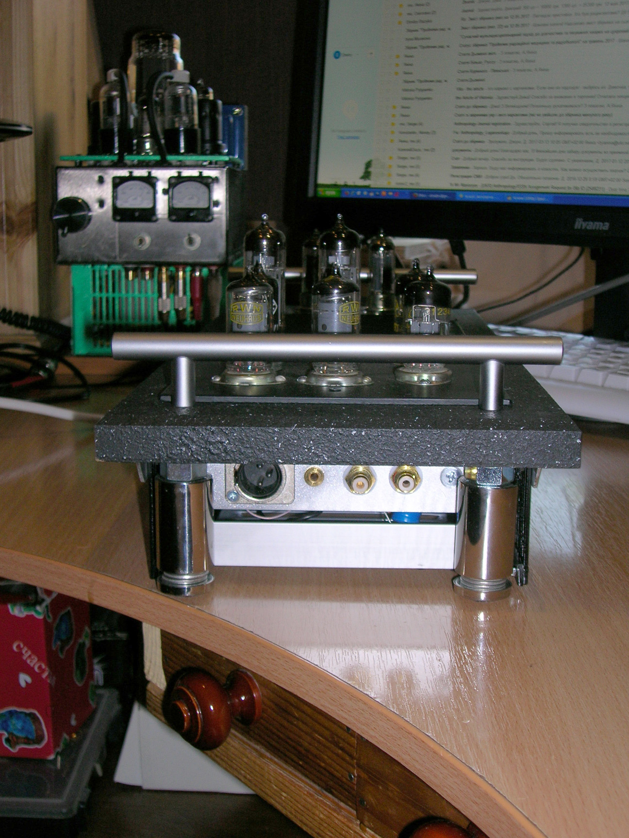

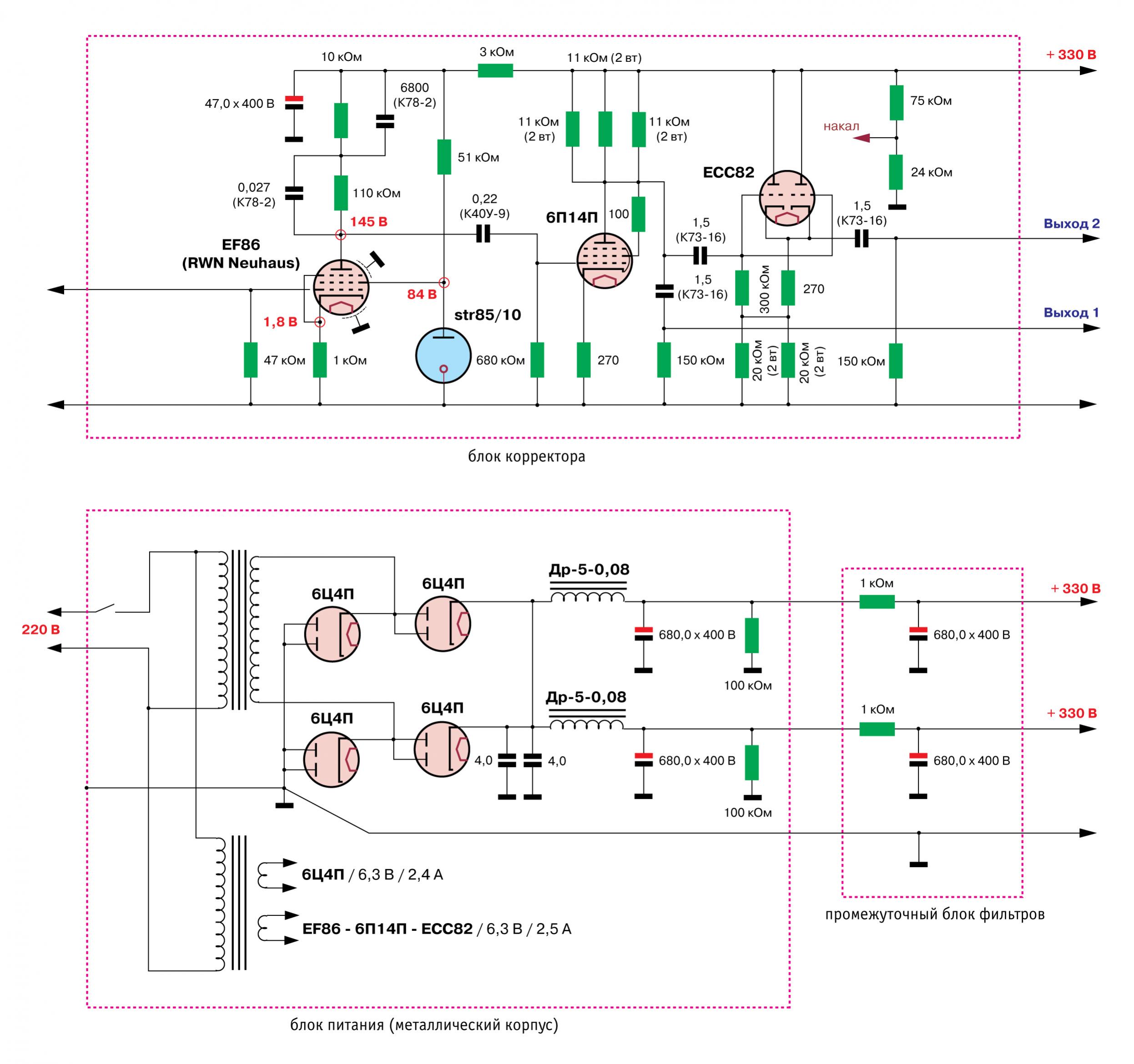

I'll be using this Filament Regulator which is basically the same circuit as Pete Millet's but this one uses a low dropout regulator in order to get regulated 6.3V DC from 6.3V AC. Just one board for both tubes in parallel.
I'm also using the Edcor XPWR123 which is essentially a clone of the Allied 6K3VG.
Tube Phono preamp.

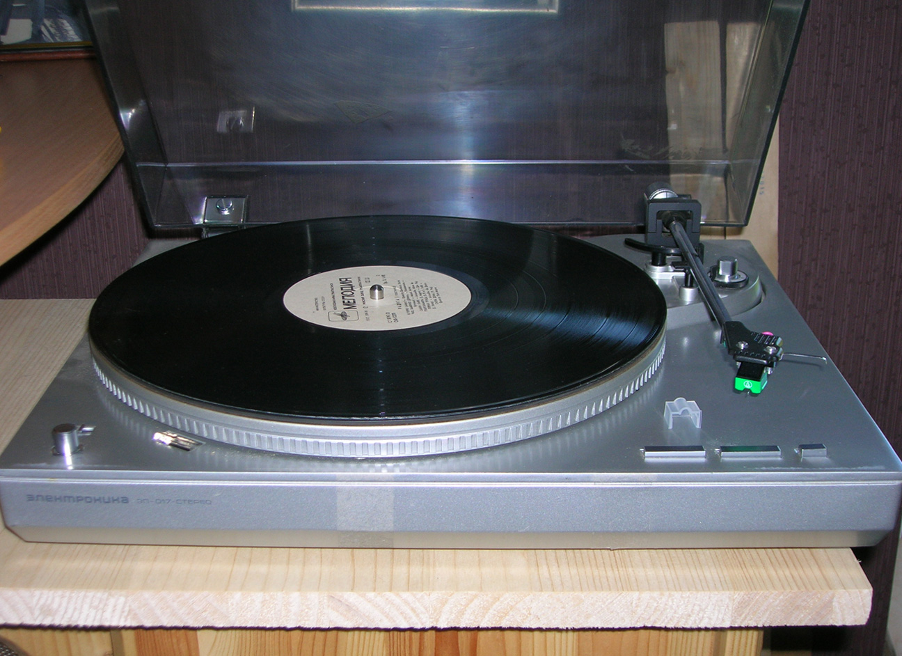

Works with Audio-Technica AT-95E cartridge
EF86 - STR85/10 - 6P14P(EL84)trio - ECC82 (optional)
Two outputs by chioce depending on length of a cable.
