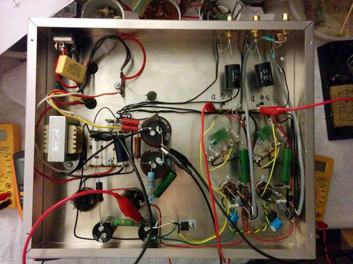

A month later, another wtf-phone-preamp starts singing 😀Thanks, will take a look at your blog!!
It took more time than I expected because I was trying to use my existing parts (new and used), and I am lack of skills and tools 😱 The only parts that I had to purchase was the mosfets. So, it was a bargain project by all means.
The most time consuming work was the chassis and played with PSUD2 to figure out the PSU from my unknown Healthkit transformer before the VR resistor.

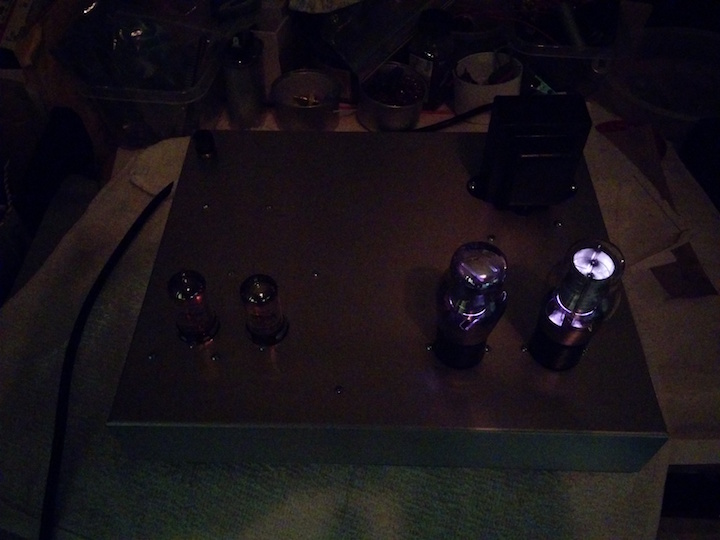

This evening, I had everything soldered. After triple comparisons of the wiring to the schematic and 4 DMM's connected to various points, I set the variac at 50%, powered it up, and waited for the excitement. No smoke, no smell for 30 seconds, so WTF, turned the variac to 100%. Still no instance except the tube glow, yeah!!! It was late, but I was still anxious to the final check to hook it up to the TT and the amp. The end result, it sang the very first time. Not only that it is very quiet and sounds much better than the opamp based phono-pre, it only costs me $10 out of pocket new money 😉
Thanks for Sodacose and everyone in the discussion!!

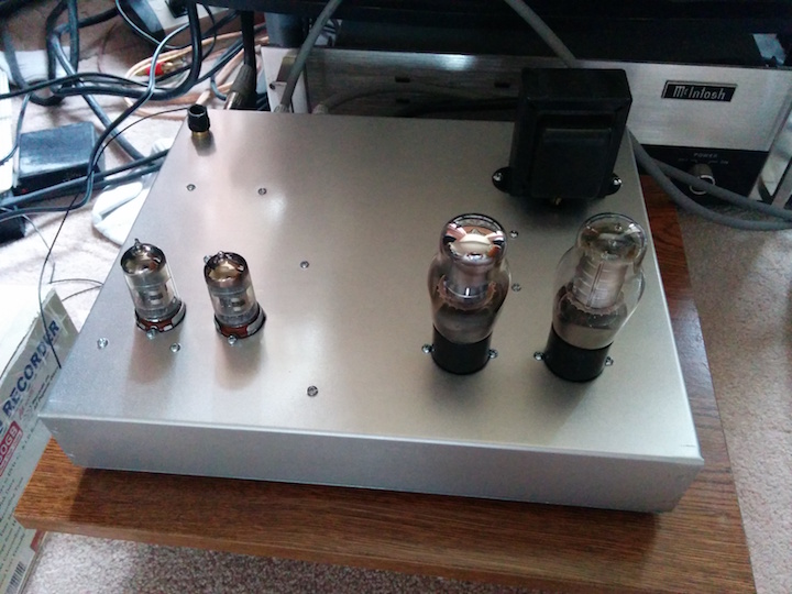

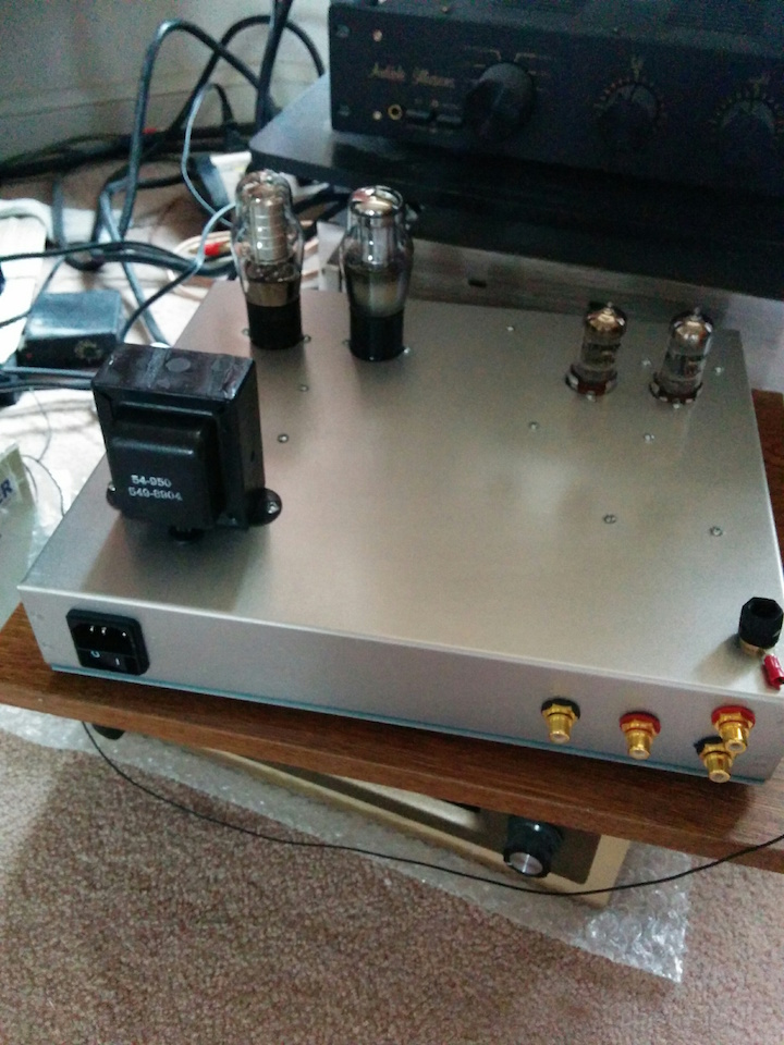

I have to admit that it was really a "follow the recipe (the excellent blog)" and then tweaked according to what were in my possession.
First trick (not so much a trick, more like a common sense 😎) is not to use an undersized chassis. The decent size Hammond chassis allowed me to use double adhesive tape to play with various placements with the parts. Still I didn't place the 12AX7 as best as I could. I was too obsessive to put them far from the iron and ended up with some challenge to solder on one side - too close to the side of the chassis.
Second tweak was to figure out how to use this Healthkit 54-950 transformer in this build. I measured the ESR and unloaded VAC and used the data to model the PSU in PSUD2. I had to go bridge full wave to get the voltage. Therefore, SS diodes were used. The beauty was I could model the psu according to the parts that I found in my wife's junk box 😀
I used PSUD2 to model the blog's PSU up to the VR resistor at 25ma load. The idea is, if I manage to reach the same "entry" point, I can very much follow the same circuit beyond the VR resistor. I then tweaked the PSUD2 model of my transformer to roughly match the same voltage at the same point (approx. 330VDC). In my live preamp, I measured 24ma consumption from both channels.
Since this transformer has a 14.5 (measured 16.2 unloaded!!) VAC secondary, it was a no brainer to go DC filament supply using a savaged L7812CV which is bolted and isolated to the chassis. This likely contributes a great deal to the quietness of the phono-pre.
For the RIAA resistors, I essentially series and parallel resistors to get to the values that I wanted. Online parallel resistor calculators were my friends. The RIAA caps are Russian polystyrene (0.01uf) 0.1% and Wima (3300pf) 2%, matched between channels. I wired one 12AX7 per channel; hence, it was easy to visualize whether I wired both channels right or wrong 🙂 I had the grounding of each channel converged into one point and then to the 1st cap's ground. That's why there are a lot of black wires.
If you look at the 2 new pictures, you will see that none of the filter caps protrudes to the surface. They are all stuck to the chassis using the 3M VHB double adhesive tape which sticks like cement after overnight cure. I can lift the whole chassis by holding the 2 450/220uF caps!!!! This tape is really handy to avoid punching and drilling in certain occasion.
The only little drama that I had was one of the socket pins had solder inside. I didn't know until I had trouble to insert a 12AX7, doh!! The lessen is, if I reuse used sockets, I better check the socket to make sure this will not happen again. The oh $h|t moment was just no joy 🙂
2 more pics from the front and the back, it is kind of some what "empty" .....
