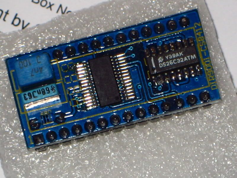

Hello Naka,
The clock needs +5VDC. And if you have the SE version of the DAC, you should have 2 +5VDC outputs at the power supply that are not being used. I haven't gotten to it yet, but you should be able to isolate the power rails for the clock by modifying the PCB and feed it directly to one of the +5VDC outputs.
The DIR9001 is an input receiver and replaces the CS8412/8414. It is not a direct replacement. It needs an adaptor and voltage regulator to bring the voltage down to 3.3VDC. There's an diyAudio member that sells an assembled converter that is a direct replacement to the CS8412/8414 (Thomas posted a link a few messages ago). I have bought 2 of them. They work fine but I still have to do a few more listening sessions to determine its advantage over the other chips. In my first trials I preferred the CS8414 better than CS8412 and DIR9001 adapter. I felt the DIR9001 has a "harder" sound than the others and that the CS8412 give me too much listening fatigue. All these without the re-clock circuit enabled. I still prefer the sound of my DAC without re-clock.
Lastly, regarding the caps in the 4 op-amp I/V board. Not all caps can be removed. Only some that filter out the DC in the signal. You should be able to safely remove (replace with a jumper) C11 and C12. But you must measure for DC voltage in the output before connecting to your system, it should be next to nothing.
You might want to try to replace C7 and C8 with film caps or non-polar BlackGates. For C7 and C8 you should be ok if you keep the values between 5uF and 10uF. I'm using 4uF Auricaps I had and it works fine. You can even try to bypass these caps with low value Teflon caps. I might try that in the future...
That should bring you more resolution from your DAC.
Let us know how you like the sound after your tweaks...
Hi Julien,
I am a bit confuse here. Thomas post #1770 saying his DIR9001 is a drop in replacement. But the one you received need a voltage regulator?
http://www.diyaudio.com/forums/showthread.php?postid=1371152#post1371152
Just wondering if you build yours or it was from Thomas?
Also, where did you get the CS8414 from? The stock DAC only come with CS8412.
Sam
SamL said:
Hi Julien,
Sam
Sorry for the confusion. The DIR9001 by itself is not a direct drop in. The one I got comes in an adapter board that includes the regulator. So the adapter board with the DIR9001 is a direct replacement. I didn't notice that the one Thomas offers is different in layout of the ones I have, I wonder if it sounds different... I got mine from spencer.
http://www.diyaudio.com/forums/showthread.php?s=&threadid=110738
I took the CS8414 I have from Thomas' DAC v3 (the one before this one). But I think they're still available. They also need an adapter board since they only come in an SMD package.

Julien_M DIR9001 was not mine design. mine can directly replace to CS-8412 or 8414 of my DAC.
hi julien,
can U post your 9001, this was mine. I test OK & start to made already. My 9001 can directly drop & replace.
take a look of my 9001 is it same!
SamL ,
8414 or 8412-IS was same. in selling price 8412-IS was more stable than 8414. I compare to old CS-8412 & found 8412-Is was detail than OLD CS-8412. That I choose 8412-IS.
I also testing about the dir9001 they had advantage than 8414 or 8412 but it was depend on use love it or not!
take a look of my 9001.
thx
thomas
