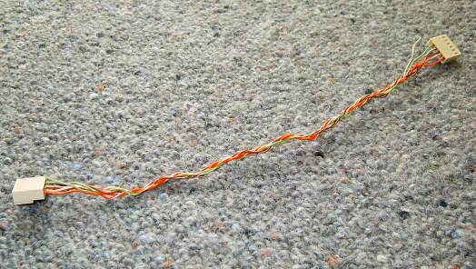

Btw, did I mention that I am using a 2M CAT6 network cable as the digital interconnect for your DAC? Well, a last minute mock up as your DAC is sitting on the floor and too far from the amp. Consider how I set it up and the sound I am getting ... I am a happy man. 😀

A simple upgrade using left over plated Teflon Cat5 cable as connection cable. Improvement is like replacing factory RCA cable with a teflon Cat5 cable.. well not as big improvement but the quality is there. For $2.00, it is worth the effort and can easily switch back. For those who have some good offcuts wire/cable, this is a good place to use them.
