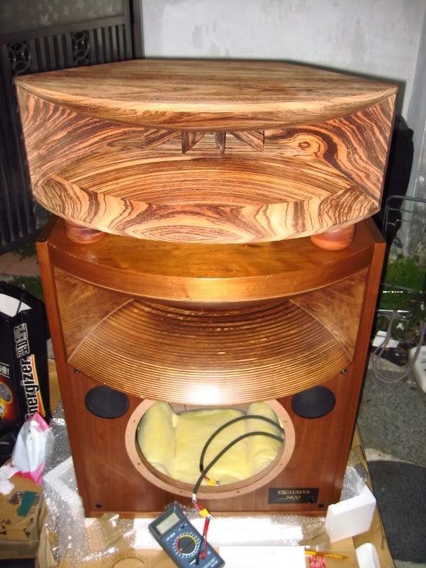

hi samL,
done already.
now is clone the TH-4001 horn mouth ( use Canada maple Plywood ) Curve was according real TAd TH-4001 & clone for it.
In Hong Kong TAD 4001 still expensive. probably U can try to search in ebay. I can prepare Horn mouth for U, crossover too.
take a look for the broken 2402 & another A290 Solid fine ebony Horn mouth! THis horn mouth use C37 similar treatment & compare to original TH-4001.
mainly was crossover. I will considerate prepare Bitch plywood cabinet + maple Plywood TH-4001( clone ) horn mouth. probably 1601a or b I can get in hong kong. But still not cheap. but if post together will less postage!
see the photos, U will surprise.

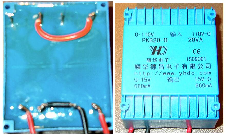

Kooka said:
This is about the 18V transformer, and it is related to 220/240V countries (NOT for 110/120V ones!)
On the left the primaries: pins 1 and 3 (top to bottom) bridged. Pins 2 and 4 to mains.
On the right the secondaries: pin 1 to one 16V socket, pins 2 and 3 (together!) to the 0"" socket, pin 4 to the other 16V socket.
Of course this is if you have my same transformer, and of course you will have to check with a multimeter, having 16V (actually you will find about 118/20V) between pin 1 and 2/3 and between pin 4 and 2/3.
Hope this helps.
Hi Kooka,
I about to finish wire up my 15V transformer for 220V main. Before I connect to the main, just need to make sure both our transformer are a like and I have done it correctly.
hi samL & kooka,
they are same.
primary had two 0~110,
U can parallel or series for the primary to fit your country's local voltage.
output voltage will be same!
don't worry for that!
thx
thomas
they are same.
thx
thomas
Ops! I did get it wrong as the numbering on the transformer are not sequential. The diagrams on this web site will answer it all.
http://solderman.blogspot.com/2005/09/transformers-series-and-parallel.html

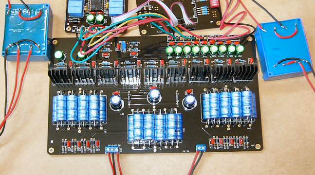

Well, I wire up the transformers, did a measurement to make sure it is working. Connect it to the PCB (with no source input), the red LED did not light up. Not sure what I have done wrongly.
The 15V transformer reading before connected to PCB. 15.9V (red) , 13V (black) and 15.87V (red). The 9V transformer reading before connected to PCB. 13.96V (red), 12.4V (black).
