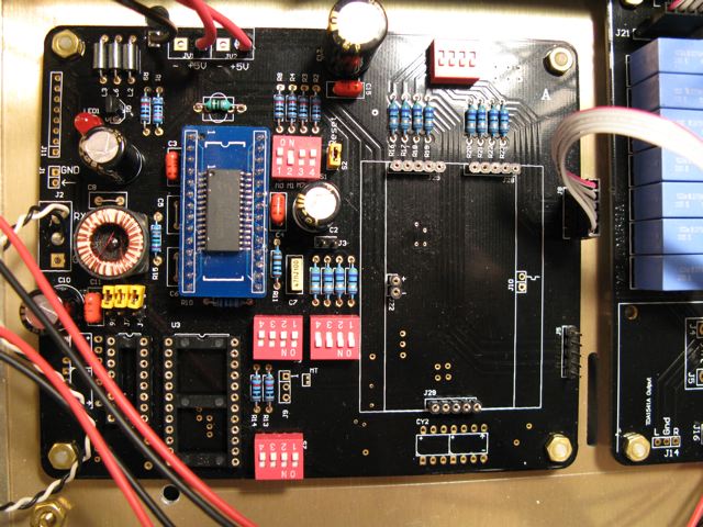

Here are the settings for the digital input/re-clock/oversampling board. The SE DAC can operate in 4 different modes. I've tested all these 4 settings with my SE DAC and they all worked. The default setting on mine was 4x OS + re-clock. When the re-clock circuit is ON only 16bit/44.1MHz sources work well as this is a fixed clock.
NOS (no re-clock):
J3: open
J4: open
J6: open
J7: open
S3: all OFF
S7: all OFF
S8: all ON
S1: ON-OFF-ON-ON
NOS + re-clock:
J3: open
J4: open
J6: short
J7: short
S3: all OFF
S7: all OFF
S8: all ON
S1: OFF-OFF-ON-ON
4x OS (no re-clock):
J3: short
J4: open
J6: open
J7: open
S3: all ON
S7: all ON
S8: all OFF
S1: ON-OFF-ON-ON
4x OS + re-clock (default) :
J3: open
J4: short
J6: short
J7: short
S3: all ON
S7: all ON
S8: all OFF
S1: OFF-OFF-ON-ON
I'm attaching a picture of my input board in NOS mode for reference. That's how I have it now.

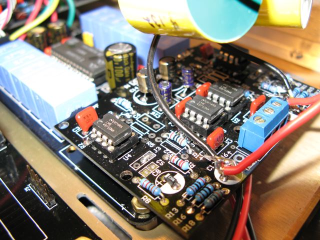

Caps are a very personal choice. I like BG in power supplies very much, once they're properly broken-in they sound very transparent and dynamic in my opinion.
I measured less than 2 mV DC at the output of the op-amp board, so I decided to bypass the output caps all together. I'm using the new National LME49710 single op-amp with very good results. They seem very stable, I didn't feel the need to use a small cap across the + and - with them.
I guess BB OPA134 would probably work well in this circuit too. Picture attached (still with Auricaps on).
Another thing I did was to replace the 3 caps (C5, C6, and C8) at the digital input before the CS8414/CS8412 receiver with jumpers. These caps are not really needed since there's a transformer already. These are only to offer extra protection for the input chip against DC voltages (in case of an accident). Since there is no DC in an S/PDIF signal, they can be bypassed.

Hi Julien, your settings are based on the use of the 4 opamps board. Ok. Are the same settings valid for the 2 opamps board? I ask this because my default settings are different, in the 2 opamps board I am using.
As an example, my J6 and J7 sockets are not shortened as you say "default setting"...
