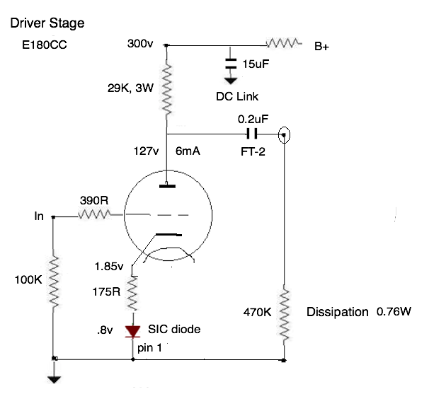

A resistor load can be good, so that stays on the list. Ideally I want an unbypassed cathode resistor but it gets too big unless you add a diode or two into the mix. Alternative is to add a bypass cap, but if you can get away with a diode it's useful. I combine a diode with a series resistor because that sounds smoother to my ears. I'm liking what I have at the moment and it makes it into the ballpark of circuits I'm happy to listen to in my system. The E180CC has the right kind of gain and it works quite nicely. For a sensitive system the E80CC is another valve I like with a diode+resistor, same idea. And some of the old European radio valves like the MH4 which was mentioned earlier on. Mu of either is around 30 though, and Rp around 11-12K so using a resistor load it would need a preamp in an average system. Not a commercial choice at all.

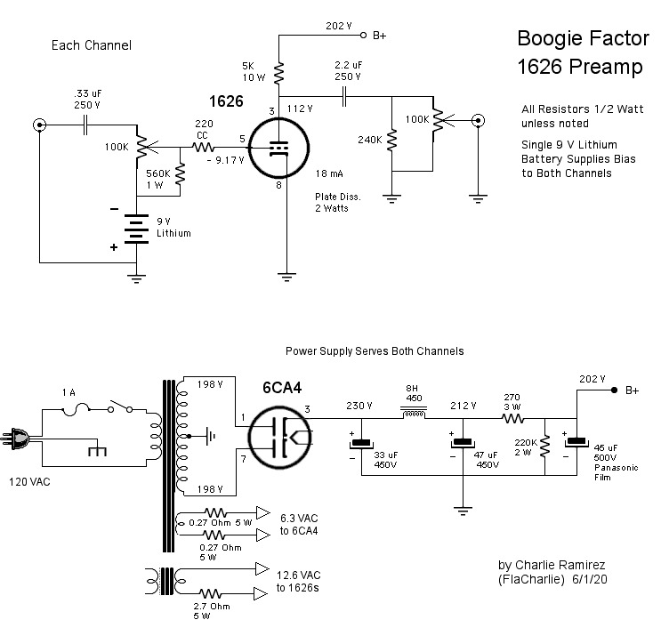

I originally tried using battery cathode bias on an amp that had 27s as input tubes. Under normal use, the current being drawn should keep them charged up. But, since I have numerous amps, there are times when they might not be used regularly and the rechargeable batteries would lose their charge. I got tired of having to remove them and put them on a charger so I switched to using battery grid bias.
On the grid, they just provide a reference voltage (perhaps that's not the technically correct term) unless the tube is drawing grid current. It's just fixed bias that's not adjustable. As a result they last as long as their shelf life which, in the case of lithiums, may be up to 10 years.

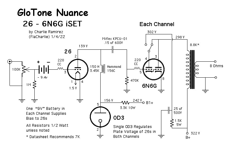

In my 1626 preamp I use a single 9v to bias the two tubes, a configuration which requires DC blocking caps on the input. In my recent "inverted SET", the Nuance, I use one 9v for each 26. That configuration, where the battery is in series with the grid, allows you to eliminate the DC blocking caps. When I had it breadboarded I tried both and I couldn't hear any difference but I went with the individual batteries and no caps option, just on general principle.

Today I was looking for information sources on circuit design using plate chokes (Hammond 156C) on a DHT input tube (26, 30) for a 6N6G SET amp, and this thread happened to be at the top of the Tubes/Valves forum. I've seen several variations of Charlie's circuit by now. So, I'm searching the web, but if anyone has good sources on the theory and practice of using plate chokes on an input tube, I'd appreciate it.
I don't really want the hassle of batteries, or to put them in the signal path. Seems the easiest way (for me, at least) would be to use plate chokes and cathode bias, rather than grid bias, but maybe grid bias is necessary? I want to understand before I proceed.
Also, I'm wondering how one draws a loadline on the tube datasheet with choke (rather than resistor) plate load? Additionally, if you're using a 0D3 gas regulator tube, like Charlie, then do you draw the loadline to the 156V coming off the VR tube or does the #26 "see" the voltage before the 0D3 as the supply voltage (e.g. 242V)?

As for the 156C, it's inexpensive and it seems to work fine within its current limits. I used it because I was advised that I would get a bit more drive with it than I would if I used a resistor load. When I had the amp breadboarded, I tried using two in series and I thought a single one sounded a little better. I don't have any experience with other plate chokes, as Andy does. His experience with them is fairly extensive so I'm sure he can offer some solid, practical, advice.
I do know that the better plate chokes range from more expensive to much more expensive and I build low budget / bang for buck stuff using junkbox parts whenever possible. So my approach is totally different from most everyone who posts on this forum.
Andy is correct that VR tubes like the 0D3 should be wired so that if the tube is removed the HT is cut off. There's a jumper in the tube that connects between two of the pins. You just run the supply through it and then connect the output side to the VR tube's plate. That way, if the tube is removed, it cuts off the HT. I did this but didn't include it in my schematic. Details are in the data sheet Andy linked.
I should say that the only reason I used a VR tube was because I'd never used one before and wanted to give it a try. I have no idea if it offers any technical advantage or drawback. I do like the way it looks and it works fine. I suspect it's somewhat superfluous.

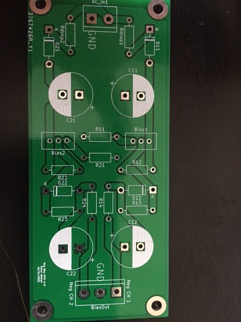

I made a little neg bias board similar to the circuits this page. Works like a charm. With adjustable bias, an adjustable CCS load, and Rod’s adjustable heaters, I can sweep through the full range of operating points for a variety of DHTs.
I can totally relate to Andy's subjective impressions about the sound. Although, I am yet to hear a choke that sounds better than the CCS, though I have not heard any good chokes to be honest. Andy, I also prefer the CCS connection to the mu connection--it sounds more open to me. Also slightly prefer the CCS over the gyrator--it is simpler and sounds as good or better to my ears.
I am going to make a board with adjustable negative bias (like the one below), adjustable CCS, and adjustable heaters. Then we can have some fun.
