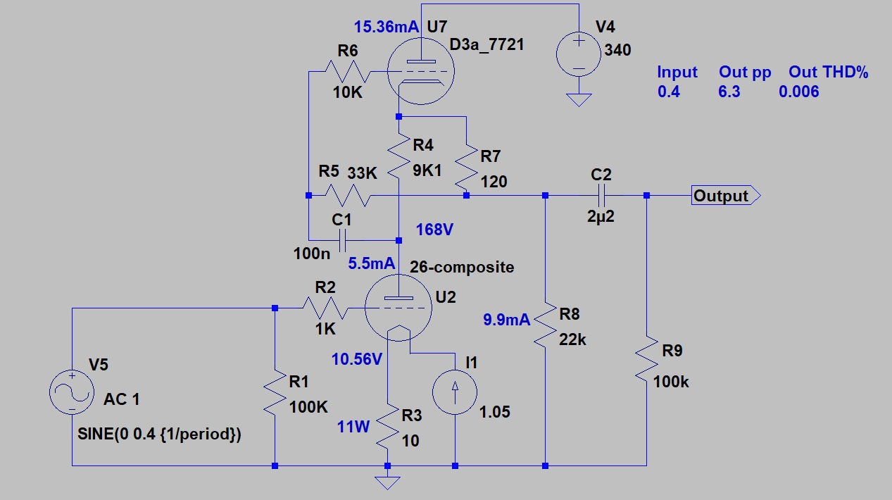

Today I was looking for information sources on circuit design using plate chokes (Hammond 156C) on a DHT input tube (26, 30) for a 6N6G SET amp, and this thread happened to be at the top of the Tubes/Valves forum. I've seen several variations of Charlie's circuit by now. So, I'm searching the web, but if anyone has good sources on the theory and practice of using plate chokes on an input tube, I'd appreciate it.
I don't really want the hassle of batteries, or to put them in the signal path. Seems the easiest way (for me, at least) would be to use plate chokes and cathode bias, rather than grid bias, but maybe grid bias is necessary? I want to understand before I proceed.
Also, I'm wondering how one draws a loadline on the tube datasheet with choke (rather than resistor) plate load? Additionally, if you're using a 0D3 gas regulator tube, like Charlie, then do you draw the loadline to the 156V coming off the VR tube or does the #26 "see" the voltage before the 0D3 as the supply voltage (e.g. 242V)?
If you are going to use an 0D3 you need to read up on how to use it. The resistor size is important, plus its wattage. And the 0D3 has to be connected so the HT only reaches the valve when the 0D3 is in its socket. Bypass cap around the glow tube should be no more than around 0.047uF and no big cap after the glow tube. It's all in the instructions for using glow tubes.

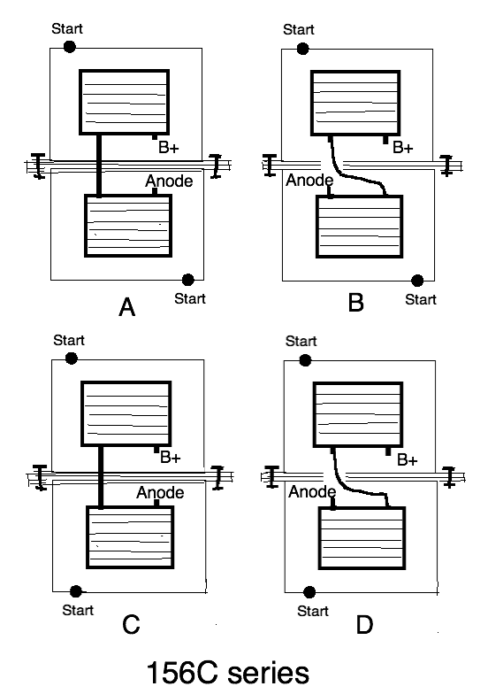

I've been listening to 2 156C in series for a few days and though it works, other more sophisticated chokes have better tonality - at a price. So I went back to a resistor load in the end for neutrality and tone. Anode chokes are much happier with valves with lower Rp. So don't ignore a 2a3 or 6B4G as your DHT if it has enough gain. When I've tried it as a preamp tube I thought the sound was excellent. And an anode choke of 50H would be fine and should have much lower DCR. You could even try a pair of Hammond 157G or 126B.

As for the 156C, it's inexpensive and it seems to work fine within its current limits. I used it because I was advised that I would get a bit more drive with it than I would if I used a resistor load. When I had the amp breadboarded, I tried using two in series and I thought a single one sounded a little better. I don't have any experience with other plate chokes, as Andy does. His experience with them is fairly extensive so I'm sure he can offer some solid, practical, advice.
I do know that the better plate chokes range from more expensive to much more expensive and I build low budget / bang for buck stuff using junkbox parts whenever possible. So my approach is totally different from most everyone who posts on this forum.
