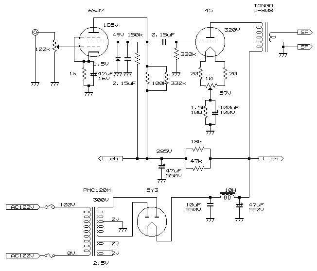

For my latest 45 PSE I am liking a lot 1/2 12AY7 per channel DC- coupled to the 49 triode. The 45's are working at 300V/33mA each and I using a rather uncommon load too, the 3.5K NP Acoustics latest version. I surely need more voltage drive than you need with the 2A3. Moreover, a 45 PSE has more or less the same input capacitance of a single 2A3. So it should work in your case too. The supply voltage for the input + driver is separate and I have settled on just over 460V but if you use the DC link caps is nothing different from a more common 250-300V supply. These are high voltage anyway, same procedures. The plate load of the 49 is 25K (3x75K in parallel) for 7 mA current. Anode voltage is 140V and self bias is 20V. The rest of the supply is for the 12AY7.
I have even gone a bit beyond with 490V for the driver and 320-330V/30 mA for each 45 (with self bias at around 70V). 330V for fairly used 45's (say 80% emission) and 320V for new ones. If the supply voltage is stable and use self bias, no problem at all and get full 5W without going into A2. With 300V plate voltage is close...

I have all these DHTs but I just want a simple 2 stage amp. If I'm at a loose end I may one day make myself a 3 stage amp, but as I get older I want light amps I can easily move around from bench to listening room. I'm done with heavy lifting. I try not to go over 12kg per chassis if I can help it, so I separate the PSU and sometimes the filament supply if it has chokes.Andy, can you measure the HF response please? 6k8 DCR is a lot of turns (capacitance)?.

Honestly, you want too many things in a simple package. A 2-stage all triode thing with 2A3 and 300B has always been a power amplifier in my experience.I have all these DHTs but I just want a simple 2 stage amp. If I'm at a loose end I may one day make myself a 3 stage amp, but as I get older I want light amps I can easily move around from bench to listening room. I'm done with heavy lifting. I try not to go over 12kg per chassis if I can help it, so I separate the PSU and sometimes the filament supply if it has chokes.

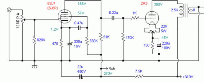

Simple + lightweight + good performing you only have 3 solutions for the driver:
1) pentode
2) cascode
3) triode with gyrator (like D3a, C3g...). The gyrator is "simple" if you can use existing boards.
For the cascode you could even try the solid state solution with the Rod Coleman's folded cascode. This would make your amp even lighter.
Ale might have the boards for both folded cascode and gyrator...
If it were for me, I would go with the pentode. Start from these below, for example.

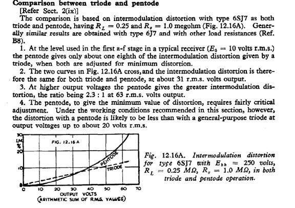

Some tests shew that over some output levels pentode connexion has less distortion than the same toob in triode.Honestly, you want too many things in a simple package. A 2-stage all triode thing with 2A3 and 300B has always been a power amplifier in my experience.

I think you can add a few things to your list. I already have working in my amp a simple, lightweight solution which is a true triode with enough mu and a choke load consisting of 2x 156C. It sounds good and has lifelike tonality to acoustic instruments. For me a solution doesn't have to just "perform" although it needs to do that, it has to produce a level of tonality which can satisfy a listener to subtle acoustic orchestral music and opera. It's the tonality that counts, and for this I prefer a choke to an active load.
I've tried a pentode stage as well and I couldn't get the same tonality as a true triode, though I concede that I might not have optimised it. I don't use pentodes as a rule. A cascode is an idea except for the output impedance, and I haven't tried that or SRPP. SRPP lowers the gain of the tube so that's a problem unless it's a SRPP-choke which is an interesting idea I haven't tried yet. We are adding a tube in both cases. I find choke loading pretty "simple" and always liked it in terms of tonality, and there are a few chokes with inductances over 150H like LL1668 or Hammond 193A for starters. Not big or heavy.
Then there are other solutions like a 1:2 step-up transformer on the input (SUT). The Lundahl one's I've tried compromised the sound so I rejected that one, together with an op-amp or FET on the input for step-up. Both "performed" but didn't satisfy the level of tonality achieved with a choke load. There are several possible solutions, in fact. It's just a question of finding the one that sounds right. When you have a 2a3 or 300b output tube the bar is a high one for driving it with something that sounds as good as these tubes do. So I'll pass on the 12AX7 mentioned and indeed most of the common 9 pin tubes, though there are a small number with much better tone. More interesting to look at some more uncommon tubes with bases like side contact, loctal, B5, B7, rimlok. There are some good but rare ones there if you know where to look for them, which is generally in Europe.
Interesting that Patrick Turner used a choke and resistor in series. He was a good man and much respected. Thanks for that! There are indeed more solutions than meets the casual eye here if you think outside the box a little. There have been several interesting posts in this thread already.
