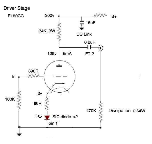

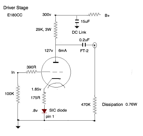

In terms of "simple solutions" it doesn't get much simpler than a resistor as anode load and an unbypassed cathode resistor. For a B+ of around 300v this requires an extra diode in the cathode, in this case a Cree SIC diode giving 0.8v. This leaves an unbypassed cathode resistor of 180 ohms for around 6mA of current. We then need a valve with a mu of 40 or more and a Ra of round 7K. This points to the E180CC which is a pretty good sounding valve. And indeed this setup gives good sound. Not the ultimate in tonality but certainly in the ballpark. I like resistor loads - they sound clean and smooth. Get them to work and they usually satisfy. I'm not a great fan of diodes in the cathode, but in combination with a series resistor they become a useful tool.

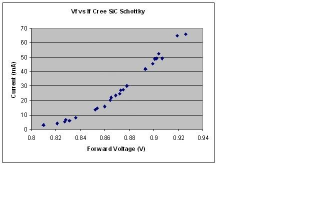

The diode act as ideally bypassed (in this case 133R= 0.8V/6mA) resistor, but at -relatively- constant voltage (about 0.8V) and has very low impedance (2.5 ... 3R).
BTW voltage is not constant, but it changes relatively little with current (at low current area).

Why did you include a silicon diode in the bias circuit?
To decrease the size of the unbypassed resistor. You can use one or two diodes, and here's a version with 2 diodes. I haven't tested this directly against one diode (which I'm listening to) but I'll probably get round to it.
I'm cautious with these SIC diodes - they do give a bit more attack to the leading edge of notes. A little helps definition, but you don't want more than a little. There are a few makes of these diodes. Mine are Cree C3D02060F but I think they're no longer available. Genesic do GC02MPS12-220 which is 1200v. Useful in power supplies.
I use the same combo in my 26 with 3 Sic + 2R7 or 2R2 and the sound is very good
Sorry if this is a dumb question.. but what's the motivation for these options? Looks like the goal is to get the highest possible gain out of one stage to avoid having a second one?
While one stage might be cleaner than two (all other things being equal), a design with just resistance on the plate and cathode would be more linear - probably enough so that two such stages would outperform a single stage with a horizontal AC load line.
Rather than using diodes on the cathode (which could have significant temperature effects), why not just use two series resistors and decouple the one you don't want in the AC characteristic?
While one stage might be cleaner than two (all other things being equal), a design with just resistance on the plate and cathode would be more linear - probably enough so that two such stages would outperform a single stage with a horizontal AC load line. Rather than using diodes on the cathode (which could have significant temperature effects), why not just use two series resistors and decouple the one you don't want in the AC characteristic?
That's an idea - I've done that before but can't remember the results, it was years ago.
I have a modular system of top plates which allows me to kind of breadboard circuits pretty quickly, so I just run through a variety of options and listen to them for anything that sounds good. It needs a valve that sounds pretty good for starters, and then some way of optimising the operating point and the circuit topology. Active loads have never made it into my ballpark of sounds I want to listen to, still waiting for that to happen. Plate chokes can be good - they stay on the list.
A resistor load can be good, so that stays on the list. Ideally I want an unbypassed cathode resistor but it gets too big unless you add a diode or two into the mix. Alternative is to add a bypass cap, but if you can get away with a diode it's useful. I combine a diode with a series resistor because that sounds smoother to my ears. I'm liking what I have at the moment and it makes it into the ballpark of circuits I'm happy to listen to in my system. The E180CC has the right kind of gain and it works quite nicely. For a sensitive system the E80CC is another valve I like with a diode+resistor, same idea. And some of the old European radio valves like the MH4 which was mentioned earlier on. Mu of either is around 30 though, and Rp around 11-12K so using a resistor load it would need a preamp in an average system. Not a commercial choice at all.
