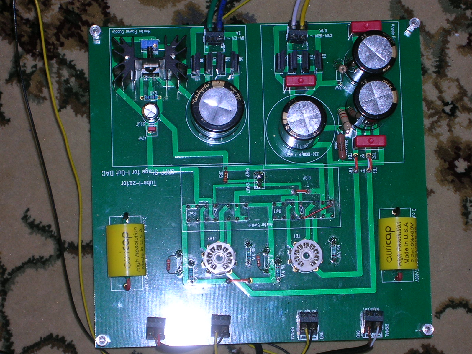

My tubeIzator work with 12ax7 without the switch or jumper, it sounds good, the pop was gone since adjusted the heater voltage to 6.3V.
Now, I just got the 6n6p, I replaced the 1k resistor at b+ with 50k resistor, the b+ voltage drop down to (from 220V) 120V as you recommended. Then I add a jumper at 6n2p side via and the middle via.
When powered up, It's not working. There is no glow on the tube even a tiny bit. Is this had something to do with the jumper that I added?

Hi Joe,
did the relays click at power up?
Remember that the jumper is constructed for a toggle switch. So if the switch is on the 6N2P side,
the middle and 12AX7 pin is closed!!

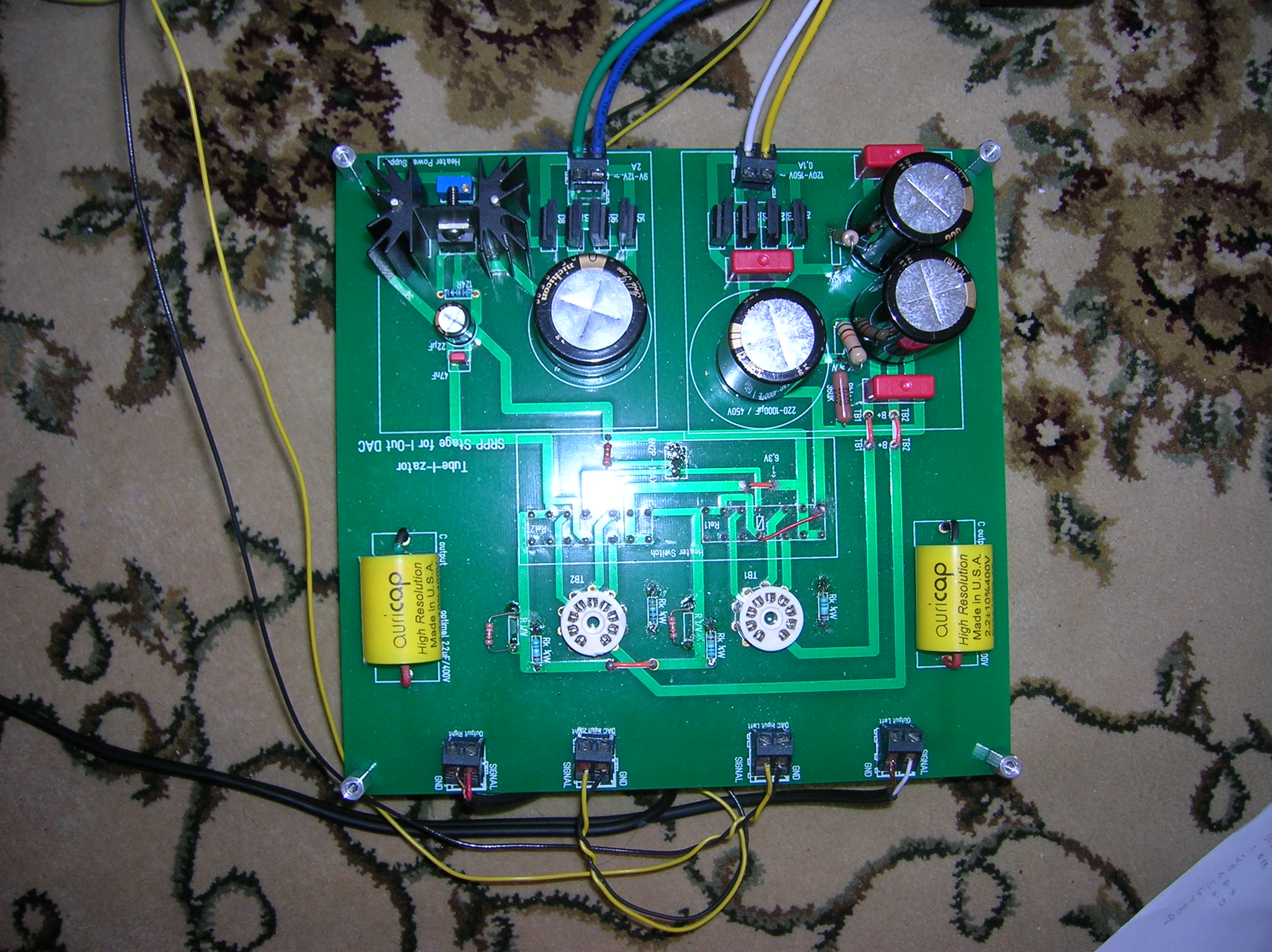

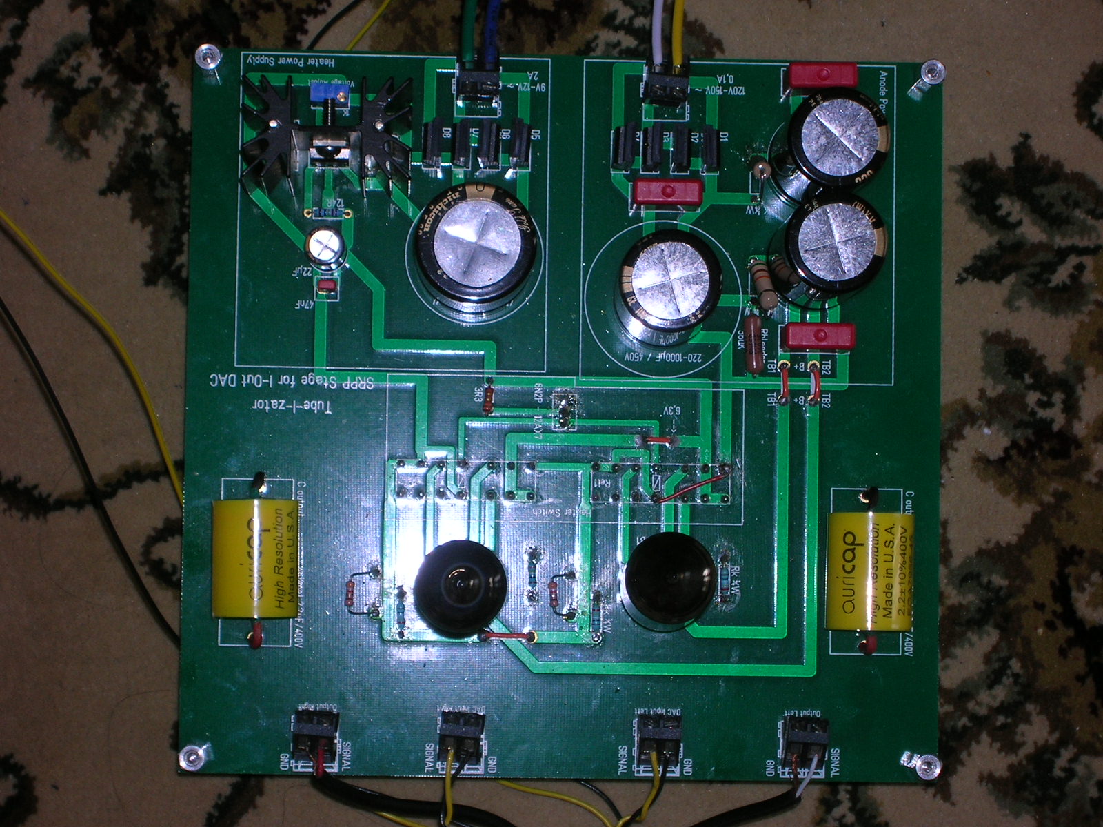

Hi Oliver,
I made some measurements on my tubeIzator after I replaced the tube from 12ax7 to 6n6p with the jumper to 12ax7 side and mid via. Is there something wrong with these voltages?

Hi Joe,
if you connect everything right, only on Pin4 is 6,3V for the 6N2P (6N6P).
Please post a photo of your pcb. I will have a look.

Hi Oliver,
You are correct that only pin4 should read 6.3V. I re-measured it without the tube and with the jumper on mid via and 12ax7 via, only pin1 and pin4 got the voltage reading.
But after I plugged the tube, I got similar readings as my previous post.
Pin1 75V
Pin2 38V
Pin3 38V
Pin4 6.3V
Pin6 38V
Pin8 0.7V
all the rest of the pins measured 0V.
Do you mean that when the tube is plug in, that only pin 4 and pin 1 should have the voltage reading?
Remember that the unit works properly with the 12ax7, the only changes that I made was replaced the resistor for B+ voltage and jumper for the switch.

Hi Joe,
because the 6H6P has a lot more anode current (≈ 28mA) on each triode (6N2P ≈ 2,3mA) there could be a small voltage drop of B+ but it´s a bit to much.
What is the input voltage of the anode supply?
So you should adjust the two 1K0 resistors in the anode power supply to get the B+ to ≈120V.
The rest of the voltages are ok.

Hi Oliver,
The input voltage anode supply is 220V. I replaced the original 1k resistors with 50k. I will try a lower value resistor later.

Is the heatsink for the (LD1085v) regulator on Tube-I-zator suppose to be very hot?
When I use 12AX7 tube I can touch the top portion of the heat sink for a few seconds, while if I use the 6n6p (b+V =120V) it's VERY hot, I can't touch the heat sink for more than a second, is this normal?
