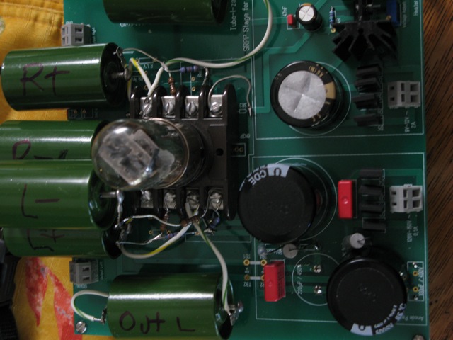

Oliver:
Probably not what you had in mind when you designed board.
As soon as my transformer arrives I will attach this to my Buffalo II.
Enjoy
Bob
I now have this up and running with the Buffalo II. It does use the Buffalo in voltage mode. Everything the Lampizator says in his Buffalo article sure rings true as I am listening.

I may have missed it but are you using the Buffalo in current mode? Are you just using one of the phases?
I posted my pix of the 6SN7/6H8C setup I put together. It takes both phases (+ and - ) and inputs SE. It sounds great. Right now I am switching between this set-up and my Lundahl 1674 transformers. the transformers also sound very good and make for a nice compact system.
Best
Yes, I am just using it in current mode. I am using just the Out+ and Gnd. My system is all single ended.

Hi Bob, I might have missed your picture of the 6SN7 setup, can you direct me to it? I might want to try that too... Thanks!
The pix of the 6SN7 is in post 102 (this thread).
I have a bunch of 6SN7 tubes so it was a logical choice. It does use the V+ and V- outs of the Buffalo and gives an SE output. I used Oliver's board for the power supplies and the ground plane and as a base for the Amphenol 8 pin tube "test bench". Hard-wired the circuit to that.
I recently replaced the PIO output caps with Mundorf Silver/Oil and a .1μF Russian Teflon. I think this gave the sound more body and punch.
