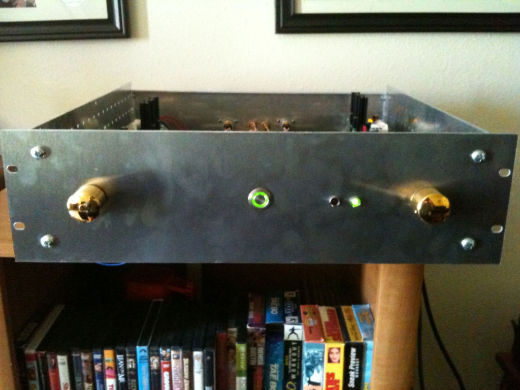

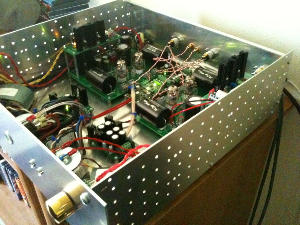

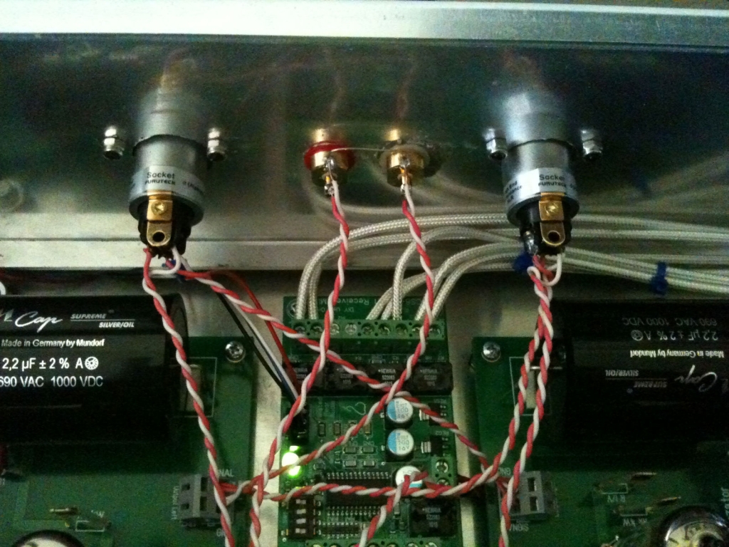

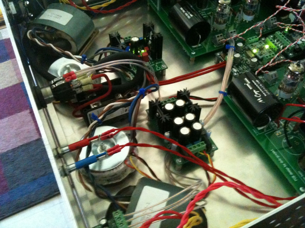

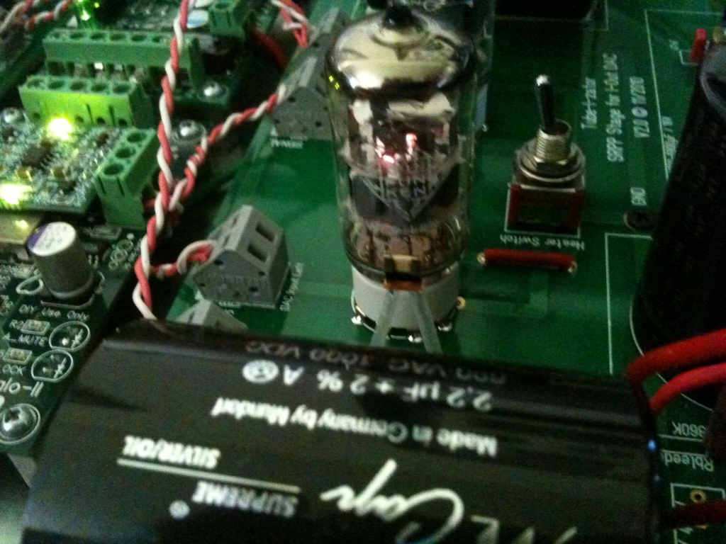

Got some photos of the balanced version of the Tube-I-zator boards with the Twisted Pear Buffalo II DAC. Fully balanced version plus single ended. I have some Telefunken ECC88/6DJ8 tubes in it now. Sounds phenominal!! I would like to thank Oliver for all his help, I could not have done it without him. Thank you Oliver!!!:):wave: Pictures are below!! Sorry for the bad quality as they are from my Iphone.
Greg
