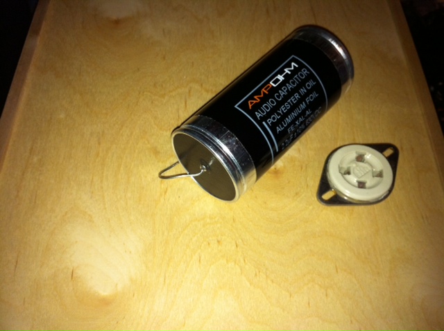

But if you don't have the money but have 3 times the space. Get the Amp Ohm FE-XAL-AL 630VDC Polyester in Oil. Alu Foil.
9,5 cm long, diameter 4,5 cm. 😉
Tony Gee rates it higher than the Mundorf Silver/Gold/Oil.
Tony rates 12 for Mundorf.
12+ for the Ampohm.
Ampohm are €16.89. Not made anymore. But I know who has a few left. Hint: "The company that is hosting the diy meet you are going to dvb-projekt."

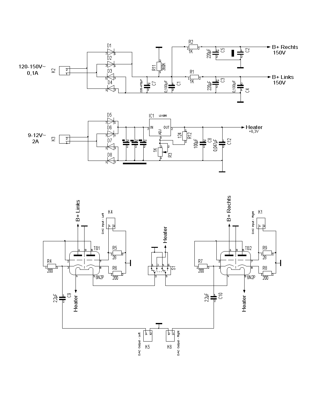

Is there a schematic diagram of that Tube-I-zator?
Also, do you sell PCBs for Salas HV Shunt Reg?
If yes, how much are they?
Hi Joshua,
the schematic is attached. Here again the informations for the Salas HV-Shunt Module:
My last thoughts to optimize the Tube-I-zator goes to the B+ High Voltage lines.
To get the maximum flexibility, i have made splitting points in the lines.
The splitting of the anode psu lines brings upgrades possibilities.
You could use e.g. a tube rectifier with C-R-C filter instead of the onboard andoe psu or
switch to a regulated shunt psu, witch in my mind brings the greater sound quality upgrade.
