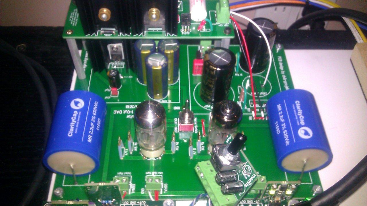

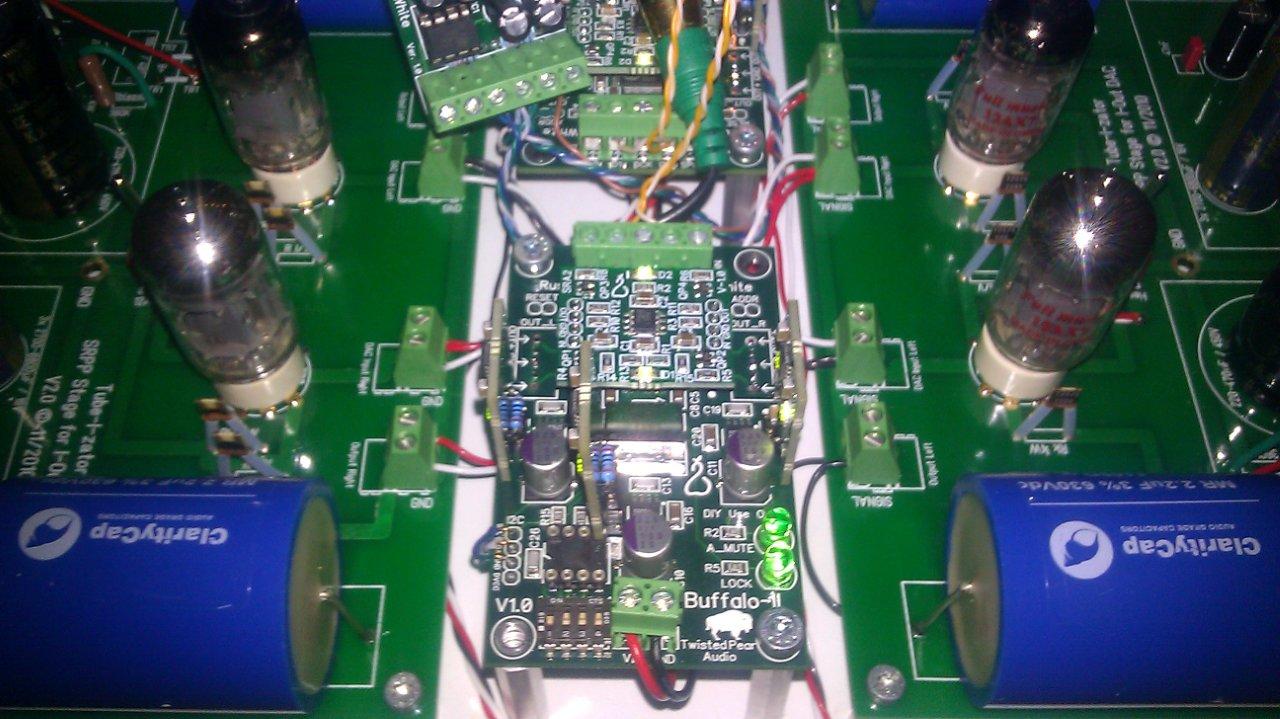

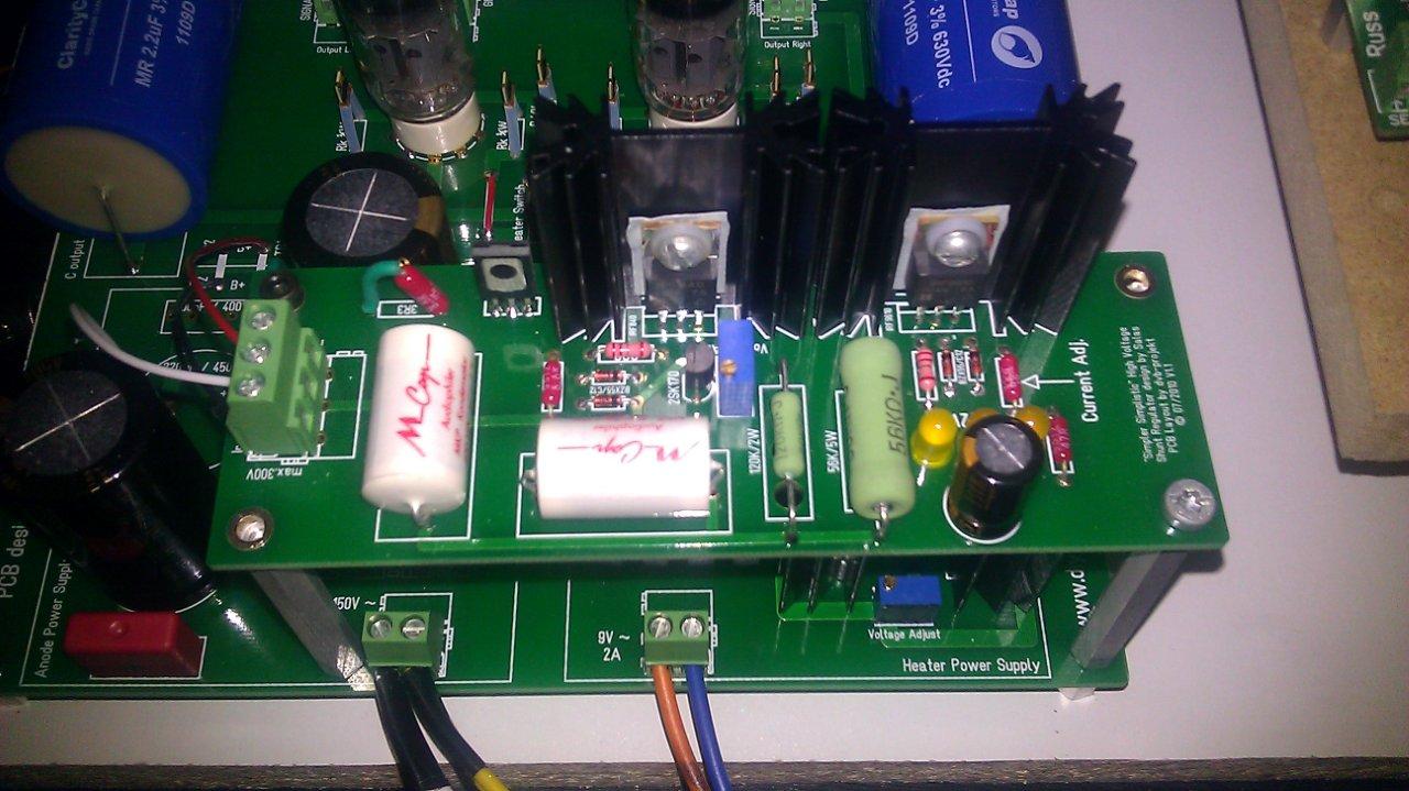

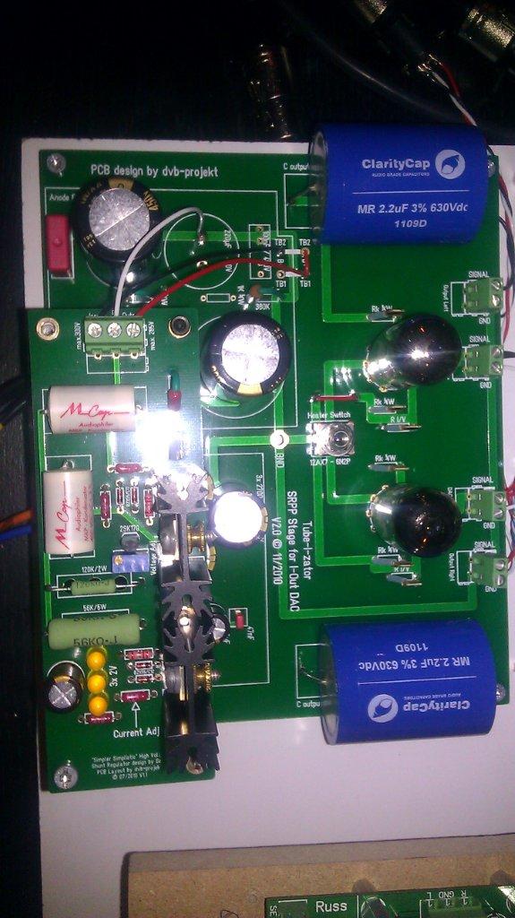

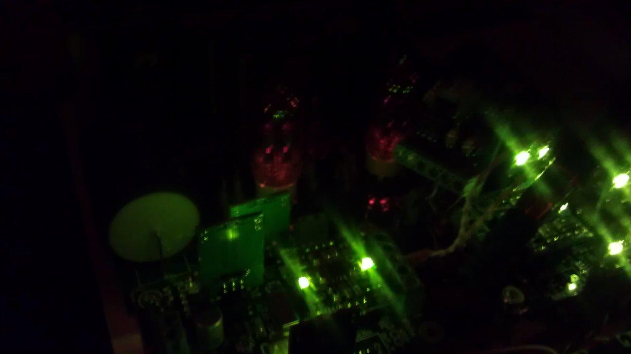

Here's a few pics of the Dual Mono Buffalo II and Tube-I-Zator
The hookup is NOT final. It is still a "prototype" but sounds amazing already!
I'm currently using TX-2575 resistors (see near tubes) and R I/V is currently set to 56R. Russ from TwistedPear Audio suggested I try 28R - 32R which I will.
I will post hookup diagrams this week for people interested.
Ciao!
Ciao!

I'm using the TJ Full Music 12AX7 and they sound extremely good
Ciao!

Just a little change in the I/V resistors... It is supposed to be 21R - 32R
Sorry for the confusion!

if you have room i suggest you to use a CLC filter instead of crc, use a cheap hammond 9H 40mA between the two filtering caps, way better than a resistor and cheap, 10€ here in europe
In Canada it is around 17$ which is about the same as you. The only thing I'm wondering is usually, with chokes you have to go really high end for it to sound good. I might try this later on but I will give priority to my output caps for now.
Thanks for the suggestion

Pinnochio, What capacitor you use for the Heater? Looks nice.
I was thinking of using Vishay BC for both 470uf and 220uf. Is that fine?
Hi Wwan,
for the heater caps, I'm using Panasonic FC. I believe they're 25V rated. If you need the part number I can find out for you.
I used the Nichicon KX as found in the BOM for the 220uF and the 470uF. My pictures don't show a 470uF but a 220uF but I did change it to 470uF recently.
Vishay BC caps are really good as well. Cornell Dubelier (CDE) has some pretty good caps as well in the 38X series.
