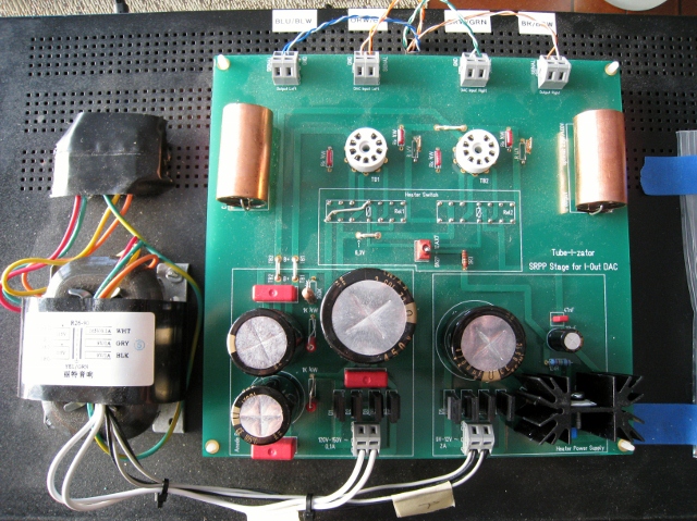

if the r-core output is really 1A you should be fine for tubes with heaters that run at 300-350mA, else you need to join in parallel the two secondaries for heater that need 600+mA like 6n1p or 6n6p
That's one question I had, is the heater input on the Tubeizator terminal (9-12V, 2A) is the 2A input a required 2A? Or is that the maximum current allowed? The R-core outputs 1A is the reason I ask. The voltage should be fine though.

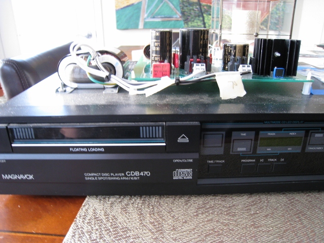

Greetings All,
I've been "lurking" around this site after I stumbled upon the Lampizator site about 2 years ago. With Oliver's encouragement have decided to post...
I'm including a couple of pictures of my my first "get your feet wet" Tubeizator project. I bought this player (Magnavox CDB470 uses a TDA1541a chip) on ebay for $32.00. I know that's like putting a killer engine in an old beat up car, but the transformation was unbelieveable! So now that's prompted me to undertake Oliver's DAC project....and I'm slowly learning the nuances of Mac generated music. (very slowly)
I'm not a circuit guru (ie Salas, Oliver, etc.). I just like awesome music reproduction.
Thank you Oliver for continuing to share you're wonderful boards with me and answering the numerous (hundreds?) of emails.
That's exactly what I was thinking (running the 2 (9V, 1A) taps in parallel). Thanks for the second opinion on the subject.
One question though, would the volts be (approximately) doubled on the transformer 9V outputs if ran in parallel? Wouldn't this cause the transformer to heat up more?
I see below that this is how crobbins5421 did it though and it sounds like it works fine. Is there any extra heat from the transformer crobbins5421?

Heat isn't a problem.....
Please understand though...I believe that I have a faulty transformer, one that puts out WAY too much power. My measured B+ is about 290V after adding a 30k resistor.
with load???
no you'll have same voltageOne question though, would the volts be (approximately) doubled on the transformer 9V outputs if ran in parallel? Wouldn't this cause the transformer to heat up more?
with load???
Oh yeah! I was thinking in series. Thanks very much!
Yes, a few others have reported the same thing. I have a a few Vishay resistors ranging from 1.21Kohms to 1.63Kohms to put inplace of the 1Kohm resistor if i need to. Hopefully this will bring down the voltage output enough. Also, the HV Shunt will bring it down a little more. Thanks for the feedback.
