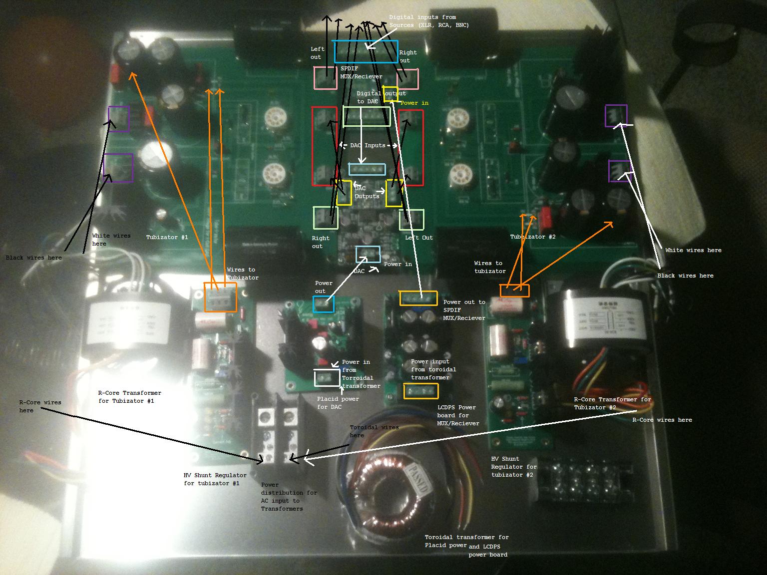

I could use some help in laying out the components for my DAC. I have come up with some component layouts, but if you can think of some that I have not please list them here. I hope this is OK for me to do Oliver. I could use everyones' help. Sorry for the horrible photo, it's from my iphone. Thank you very much.

Hi Greg,
looks pretty good!
Please try to keep the HV-Shunt wires as short as possible.
Therefore the HV-Shunt for the Tube-I-zator #1 must go to the upper side.
BTW, is see that you had both 2nd caps in the HV-PSU installed. You need only one
complete C-R-C strack to the HV-Shunt module!

Thanks Oliver! That was one of the layouts I had as you suggested. I would move the Tubeizator #1 towards the front enough to put the HV Shunt board right behind it rather than in the front as pictured.
As far as both caps in the HV-PSU, I know both were not required, but I had both well before I had the boards, so I installed them both just in case I needed to use the HV-PSU on the tubeizator itself (for whatever reason) in the future. It won't adversly affect the performance of the HV-Shunt or the HV-PSU on the Tubeizator will it?

Leave them unconnected as you stated 😉
If I don't have the 1K resistor installed for the these caps, would it matter if the caps are installed? Or is it still better to remove them?
Greg
