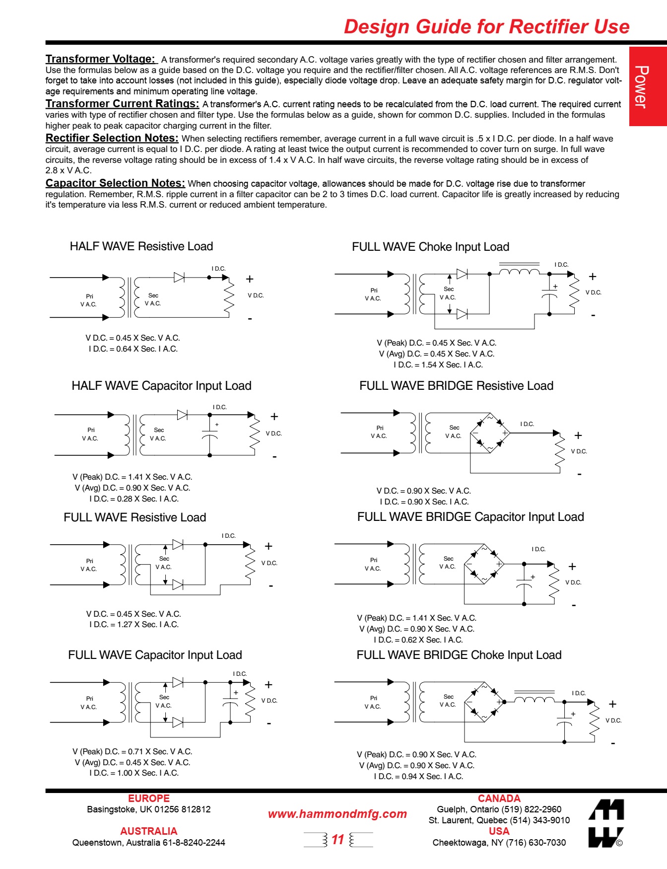

I am attaching a document that shows the proper numbers.
Be sure to pick the correct circuit when you calculate.
Example, a bridge rectifier with a capacitor input filter, the formula is: I DC = 0.6 X Sec I AC
That means for a 1 Amp AC rated filament winding, you can safely get 0.62 Amps DC.
So if you need 6.2 Amps DC, you need a 10 Amp AC filament rating.

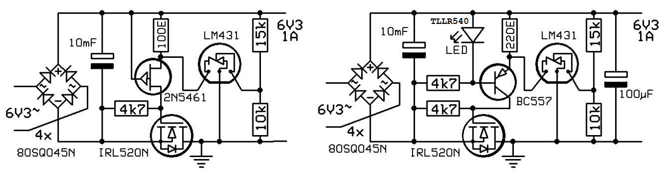

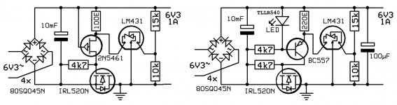

For those who still want DC heating and like experimenting, here a circuit I think could work.
First with a P-fet, but the properties are very unreliable (wide spread) so a second version with BJT+R+LED.
More current could be possible (up to 5A) with bigger 10mF capacitor and stronger rectifiers.
The MOSFET has to be a logic-in type because of the low voltage.
Before anyone asks, I can't build anything myself no more, just drawing.
Mona
Reactions: diyiggy

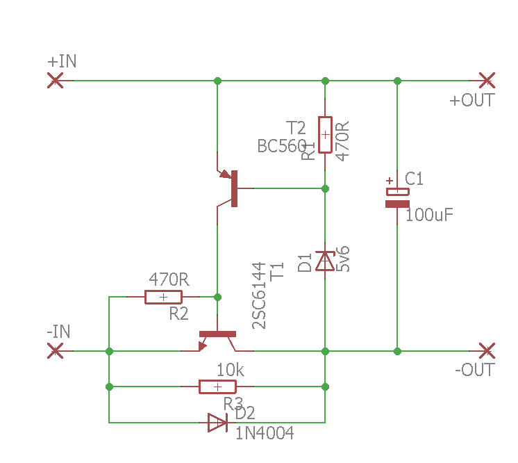

This is something i just sketched up as a LDO replacement. I have not simulated or measured the circuit but it could work as a simple regulator to provide about 6.2VDC at up to several amps at a dropout as low as the VCEsat of the transistor in question: about 200mV. Which would make 6.2VDC from 6.3VAC possible with some serious skottkeys.
That's no good, is positive feedback.
You get emitter-base (driving PNP)-zener-saturated pass-transistor over the input.

[Post 30 - Ketje's mosfet based regulator] Clever design, I think the second one could work very well. My only suggestion would be to add a 100 ohm stopper resistor right at the gate of the mosfet.
Be sure to choose a mosfet that has an SOA that permits operation with at least 2V VDS at the load current. (Hint some 100A switching mosfets may not do it.)
Reactions: diyiggy
I think the RFP12N10L might be a good fit for that circuit.
I still have a load of KC811 dual NPN tranistors and im thinking of modifying that circuit with a transistor Long tailed pair.
Edit i took another look at mona's circuit, the one on the right is supposed to be a current source that drives the FET gate. if im correct the TL431 functions to decrease the drive to the transistor once the voltage at the reference pin reaches 2.495V. I would include a speed up capacitor over the top resistor of the TL431 divider string, something in the order of 22uF Tantalum.
To increase the drive to the FET i would possibly add a totem pole to the fet driver circuit. or add another LED and transistor on the bottom side. to create two current sources, the top one conducting approx 2x the current where half of this current is taken away by the TL431.

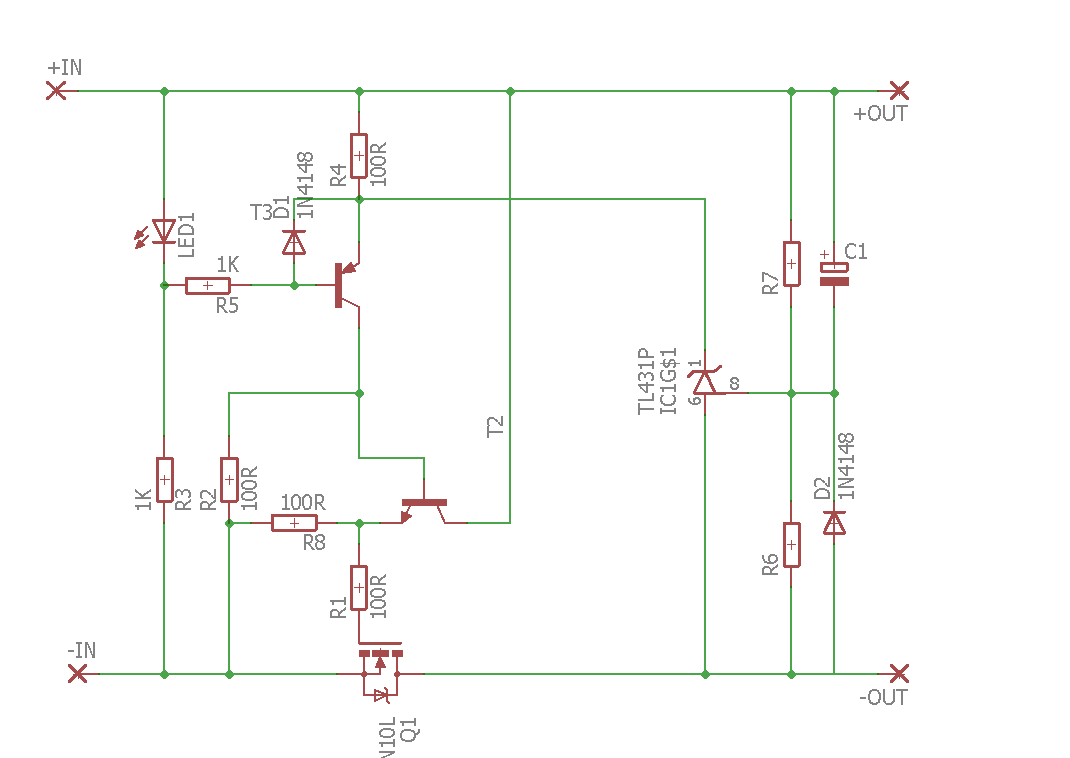

Heres my take on that circuit, i added a NPN emitter folower for lower Zout drive to the transistor. And a speedup cap for the TL431, the latter not being really needed but it gives some effect at HF at very little cost. A tantalum is reccomended in this position due to low leakage, or a 10uF film cap.
Furthermore a 1n4148 protects the PNP against reverse biasing by action of the 431.
Edit the posted circuit has an error, the resistor at the base of the NPN should be >=1K
If mona is okay with it, i can order some boards in my next order. The 2SC6144 is pin compatible with most N-mosfets GDS versus BCE so we could try both.
