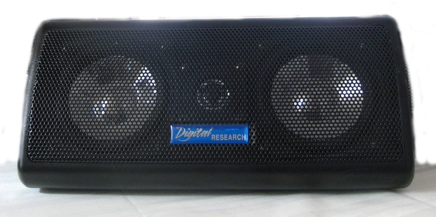

Ok, I dragged the power amp over to the bench and played the preamp through the bookshelf speaker.
Our mortal enemy, Mr. Fizz, is back. Not a big surprise, as the bookshelf speaker has a tweeter.
The problem is that even in the "clean" setting, you can still hear it.
When I play an open G arpeggio, you can hear the fizz on the pick attack of the g and b strings, in particular. It's almost a crackle, or a combination of the two, a frackle.:confused:
Perhaps that means the guitar speaker is a much more agressive low-pass filter than the graphic EQ?

@ MJD-tech
Never ever play an electric guitar through a speaker box including a tweeter.
Disconnect the tweeter and the fizz is gone. Or block it with some gaffa tape at least.
I don't like Mr. Fizz at all. :mad:
So far, the nefarious Mr. Fizz has come along for the ride every single time I've put semiconductor diodes into a guitar audio chain. When I saw KMG's circuit, I wondered how KMG could slather six diodes (!) onto each MOSFET without fizzage.

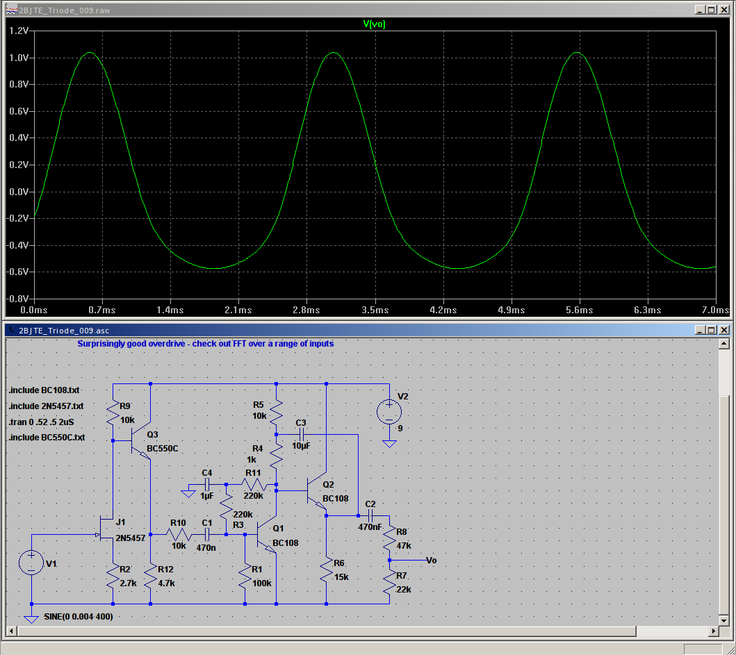

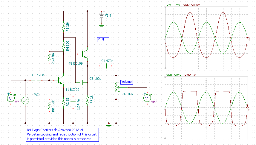

I tinkered a little with the "2BJTE" ( 2BJTE - 2 BJT triode emulator ) circuit in LTSpice during my lunch-break today. (A copy of the original circuit is also attached to this post.)
I started my tinkering by sketching in a JFET common-source stage at the input for the guitar to connect to, and buffering its output with a BC550C emitter follower.
Then I got rid of some of the obvious mistakes in the BJTE circuit, starting with the useless 33 ohm emitter resistor and even more useless 4.7nF(?) bypass cap (R2, C2).
I also removed the useless shunt negative feedback from collector to base of the first BC108, the one that creates the interesting distortion. This was done by splitting the 470k resistor (R6) into two 220k resistors in series, and adding a 1uF cap to their junction to filter out the fed-back signal.
Removing the shunt negative feedback in turn means the circuit no longer has to be fed from zero impedance(!) to work. In LTSpice, I stuck a 10k in series with the input with little change to the output waveform.
After some tinkering in LTSpice, it seems increasingly clear that the interesting distortion characteristics really do come from the collector bootstrapping. Removing that capacitor drastically changes the output waveform, which reverts to the usual distortion from the exponential transfer function of a BJT.
I also raised the 1k emitter resistor (R7) to 15k, which should do wonders for current consumption (and battery life.)
Increasing the 500 ohm bootstrap resistor (R4) to 1k didn't seem to cause any big change in the circuit behaviour. Similarly, I was able to reduce the huge 100 uF bootstrap capacitor (C3) to one-tenth it's value.
The resulting circuit is attached (LTSpice screenshot).
Now, that output waveform...our eyes are notoriously bad at doing mental Fourier transforms, but that waveform looks quite a bit like the shape KMG was going for, doesn't it? The slightly overdriven 12AX7 stage, with negative output peaks flattened off due to grid current flow at the input clamping incoming positive signal peaks?
Also, there is no evidence of harsh corners in the simulated waveform, so one can hope for little to no "fizz".
I'm going to breadboard this up when I get the chance, and see what happens. Maybe it will make some nice distortion without fizz, who knows (fingers crossed).
-Gnobuddy

Some days ago I stopped by at a local thrift store. A small speaker caught my eye - two roughly 4" aluminium-cone speakers and a tweeter, mounted in a D'Appolito (MTM) layout in a small enclosure with a roughly triangular cross section. Probably intended as a TV centre channel speaker, or for wall mounting to provide background music in a coffee shop.
The brand was Digital Research (do an Internet search for "white van loudspeaker scam" to learn more about this brand!), but the asking price was only $4.99. Not much to lose there, even if the speaker turns out to be dead or not to sound great.
I had a couple of possible uses in mind (as a mic-stand mounted foldback vocal monitor when my wife and I sing at jams, or in a battery-powered portable guitar amp.) For only $5, I decided to buy it.
So last night I connected the $5 speaker to a $15 class D audio amplifier board powered by a $4 switching power supply.
I made up a 1/4" jack to RCA plug adaptor cable, and connected a dirt-cheap ($25 USD) Danelectro Fab chorus pedal to act as a preamp. (It was within arm's reach; the graphic EQ pedal I would normally have used was in the other room. I was lazy.)
Finally I plugged in my beater Epiphone Les Paul SP-II, bought about 25 years ago for $150 USD (a new one costs $250 Canadian today: Epiphone Les Paul Special II - Ebony - Long & McQuade Musical Instruments )
No tone control (except on the guitar.) A full-range speaker with a tweeter. No valves. No JFETs. No de-nastifying filter.
Yikes - how nasty is this going to sound? Or will the chorus pedal suppress the harshness and save the day?
Well, after making a few slight adjustments to my right-hand playing technique, I got some really nice clean tones out of this $199 guitar and amp combination. Nice enough that my wife commented on how good it sounded from across the living room.
That's when I remembered Voltwide's comment, about how the gear doesn't matter anywhere near as much as most musicians think it does.
The Danelectro chorus pedal definitely played a role here, taking off the harsh edge that you usually get with a solid-body electric guitar plugged into an entirely solid-state guitar amplifier. Like other cheap Danelectro pedals I've tried, this Fab chorus pedal sounds really good, but looks really ugly in its cheap plastic housing.
I had anticipated a severe shortage of bass, but, at least at the low SPL I used last night, this was not really a problem. Open "cowboy chords" sounded full. There was no evident shortage of bass for single note runs all the way down to the low open "E" string.
The combination of Danelectro pedal, class D amp, and white-van-scam Digital Research speaker actually sounded good enough that I might put this together with a 20-volt cordless tool battery to make a small portable go-anywhere guitar amp. Spring is almost here, and this part of BC will soon be bursting with green things and beautiful wildflowers soon. It would be nice to be able to go to a park, sit in the middle of all that natural beauty, and play some electric guitar.
Given its shady origins and even more shady distribution/ marketing method, it proved rather hard to find an online photo of my $5 Digital Research speaker to show you guys. I finally found one - from a scam artist trying to sell it as a Polk system he claimed to have inherited from his dad!
So I stole the scam artist's "Polk" speaker photo, and attached it to this post. Now you too can enjoy the beauty of this white-van speaker special!
(It looks pretty decent. That - and the tempting backstory - are key ingredients in hooking gullible people into buying "white-van-speakers".)
-Gnobuddy
