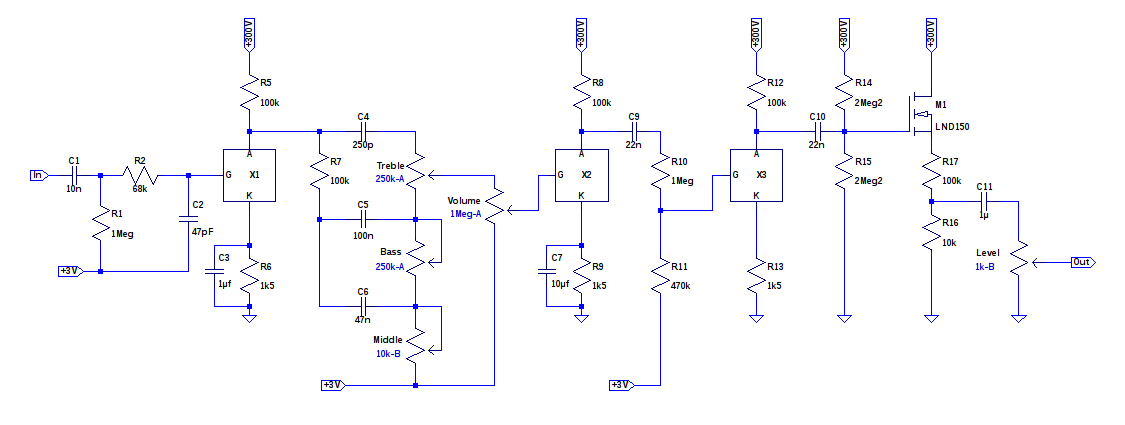

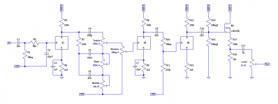

Well I finally plugged a guitar into the KMG-Fender preamp.
Today is the day I decide to pursue this project further or abandon it.
I added a source follower stage to drive the relatively low impedance of the graphic eq.
I worked out a voltage divider so the signal is right for the graphic.
Was kind of anxious to try it out, so I just grabbed a headphone amp and some headphones.
The power amp and speakers are too far from the bench, I'd have to move them.
There's no way I'm going to move the breadboard over to the power amp.
So it goes: guitar -> KMG preamp -> graphic eq -> headphone amp -> headphones
Plugged in a tele. Hooray, It works. But way too much gain.
So I yanked out "cathode" bypass cap from the 3rd stage.
That's better.
Sure, there's a fair amount of hum and noise, but acceptable, considering the rat's nest wiring, sketchy grounding and fluorescent shop lights.
With the volume knob set around 3, pretty good Fender clean.
The tone controls do what they are supposed to do.
Crank the volume knob, it starts to overdrive.
Uh-oh, there's that dreaded "fizz"
You know what I'm talking about.
I hate that fizz with a passion.
I could dial it out somewhat with the graphic.
But headphones are just not the correct tool for this job.
You need air between the speaker and the ear.
My Line 6 Pod sounds dreadful in headphones but actually, a couple of its amp models sound pretty decent through the bookshelf speakers.
I'm pretty sure three actual 12AX7 gain stages would sound like crap in headphones too.
Just for giggles, I plugged in a 1 x 10 guitar speaker into the headphone amp.
I knew it wouldn't be very loud, but it's way more efficient that a bookshelf speaker.
Wow, that makes a world of difference.
Even with the graphic eq bypassed, most of the fizz is gone.
I can deal with a little fizz, real valve amps have some, just not too much.
I'm hearing a hint of the Fender "gling" in the clean sounds.
Pretty good "rawk" tone with volume control dimed. Bass gets a little flubby, but we know how to fix that.
I'd say the circuit has potential.
It needs some refinement in the gain structuring, interstage coupling caps and cathode bypass caps, but this was expected.
Also, I'm running 3 gain stages and a source follower off the same B+ node.
Although this is a (theoretically) low impedance node due to the voltage regulator, I think there is some inter-modulation going on. This may need refinement too. Or it could just be the lousy grounding.
Also, the fixed bias scheme may need some refinement. I'm not sure yet. It's just a simple voltage divider hanging off the B+. I kind of feel it needs to be buffered or regulated. Maybe not.
And of course it all needs to be in a proper chassis and properly wired and star grounded.
I just realized my "ground" is totally floating, it's not connected to earth. I'm using a two prong power cord. It's amazing the hum and noise are not worse than what they are.
Unlike you sophisticated guys, I have no ground plane under my breadboard either.
It's quite interesting how a guitar speaker and air filter out a lot of the fizz and muck.
It really sounded awful in those headphones.
Next, I need to hook it up to the power amp and bookshelf speakers, as that is the intended use. Still unknown what kind of de-nastifying filter will be needed. Hopefully the graphic eq will help me figure that out. I don't want the graphic as a permanent part of the signal chain.
I'll try to get some schematics posted on what I've got so far.
Glad you are keeping at it.
Thanks. There were times when I felt like quitting. One time was when I was getting the oscillation. The next time was yesterday when I heard the fizz. "If I wanted fizz, I could have just built a tube screamer."Glad you are keeping at it.
Here are the schematics for what I have so far.

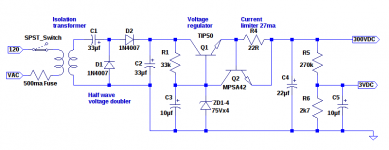

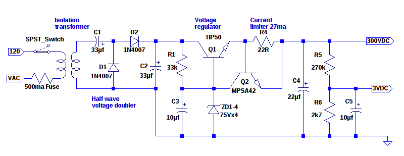

I decided to put a current limiter on the voltage regulator. In the hope that if I slip with the scope probe and accidentally short the power supply, it won't be instant death to the TIP50 pass element.
I haven't tested the short circuit thing yet, but I did hang a 5k load off the power supply.
At 300v, this would be 60mA. The current limiter is set for 27mA.
I measured across the 22R resistor and it is 0.6v, so yes that is 27mA.
If the current was 60mA, I would measure 1.32v across that 22R.
So I guess it's working.
What I don't fully understand is how it manages to hold the voltage at nearly 300v with a 5k load and only pass 27ma, but it does.
Seems to me 27mA through 5k is 135V so I should measure 135V across the load.
I didn't spend too much time on this so maybe I'm missing something.
As long as it doesn't oscillate, I'm good.
I chose 27mA arbitrarily because I had a 22R handy.
As it stands, the preamp draws about 6ma.
You'll notice that the interstage resistors and tone stack connect to the +3 rail instead of ground. This is because I'm using fixed bias on the LND150 "triodes" and the "grid" needs to be at +3v.
The +3v rail is at ground potential as far as AC signal is concerned.
Since this is an AC ground I need to remember to "star ground" these connections when I rebuild the circuit on another medium besides the solderless breadboard. Of course, the real ground will be star grounded as well.
Thank you! That's helpful, and easy to do. I'll stick a BC550C emitter follower ahead of the 2BJTE circuit for testing.Emitter of a SS BJT (2SC2458)

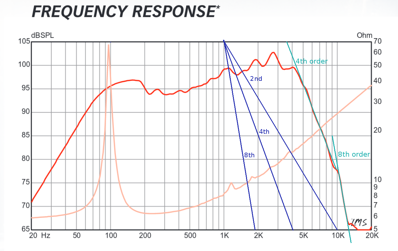

if you have a look at frequency responses of common guitar speakers you will find them rising up to a peak between 3 and 5khz and then drop very steeply with slopes up to 40dB/oct.
You mentioned spin-semi. I have build several units with their FV-1, using reverberation and chorus. Chorus is quite nice, reverb is not too bad. But it is unlikely for me to find a real satisfactory reverberation emulator since I heard Wolfgang Schwartz demonstrate his Quantec Room Simulator during Ars Electronica 1982.
You read my mind, this is exactly what I've been doing for the last half-hour!if you have a look at frequency responses of common guitar speakers you will find them rising up to a peak between 3 and 5khz and then drop very steeply with slopes up to 40dB/oct.
(I did the same thing some weeks ago, but apparently I didn't get my slopes right that time. I made some mistakes trying to interpret slopes in dB/octave units. I'm pretty sure I got them right this time, though.)
See the attached image - all the text that follows is based on it. The image is the manufacturer's published on-axis frequency response of an Eminence Legend 1028K speaker.
First, for illustration, I drew straight lines (dark blue) representing 2nd, 4th, and 8th order filters, starting at the top of the graph, at 1 kHz. Use these slopes to guide your eyes when looking at the actual loudspeaker frequency response.
From about 4 kHz to 10 kHz, this speaker rolls off treble at the same slope as a 4th order low pass filter. That is to say, 24 dB/octave, or 80 dB/decade.
Above 10 kHz, the rolloff is a close fit to an 8th order low pass filter (48 dB/octave, or 160 dB/decade), until the measurement runs into the noise floor and flattens out.
However, this 8th-order region is more than 25 dB below the peak output at around 3 kHz, so it should have very little audible effect.
So a 4th-order low pass filter would be needed to make a de-nastifying filter that matches the on-axis acoustics of an Eminence Legend 1028k.
(The filter I made for my amp is only 2nd order.)
The remaining question is, what does the frequency response look like from a more typical guitar amp listening location (it's never on-axis)?
I don't know the answer. We can guess the rolloff starts at lower frequency - but how much lower? And does it still start rolling off at 4th order, or does it roll off more gently at first, perhaps only 2nd order, due to the directionality of the speaker, before transitioning into 4th order rolloff further up in frequency?
At this point we have two choices: the more scientific route is to get a measurement microphone and suitable measuring equipment, and measure the frequency response of a few guitar speakers well off-axis, say 30 degrees.
Or we can build a 4th order filter, and see if it de-nastifies solid-state "fizz" as well as an actual guitar speaker does. Less scientific, but quicker, and it may tell us what we need.
-Gnobuddy
P.S. The bass roll off below about 70 Hz is a close fit to a 2nd order high pass filter, as theory predicts for a speaker on an infinite baffle.
