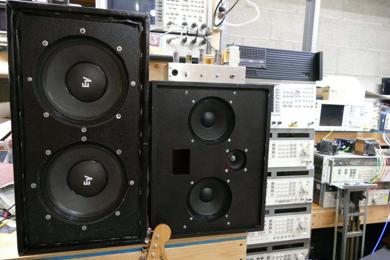

There was a recent thread on diyAudio about a 600 W (!!) TI class-D audio power amp evaluation board that was selling (during a half-price sale) for something like $80 (USD).
It was $75 pus $6 shipping. For another $50 they offered a guitar preamp. Loud, really loud, but I would rather play a big tube amp.
I would not really go for 600W with more than 40W power dissipation on that tiny chip.
I beat that thing pretty hard on 50 volts with music and the guitar preamp. It didn't get that hot
The TI class D amp is an experiment. I am planning some big tube amps, and will do some comparative testing with both music and musical instruments (synth and guitar).
What kind of speakers do you push with that enormous power?
DIY speakers of course! The pair shown here are known as "loud" and "louder." They were both budget builds. another bigger slightly higher budget set is coming.
The EV speakers were an impulse purchase on the opening day of the "Mars Music Mega Store." I went there with a friend who waited in line outside for a couple of hours to get his guitar autographed by Randy Bachman while I wandered the store and bought stuff. Mars was the brainchild of the owner of Office Depot who bought the historic Ace music store in Miami and attempted to franchise Mars with a bunch of his own money......it failed and I would find myself shopping the "going out of business sale" a few years later.
Loud on the right has a pair of cheap Parts Express PA165-8 drivers and a cheap bullet tweeter crossed with 3 X 1uF mylar caps in parallel. A switch turns the tweeter off for guitar use.
I built two of these speaker cabinets for testing amps using cheap drivers so I wouldn't cry if I blew them up. The box was simulated and designed to give flat response down to 70 Hz. The small drivers are almost 93db efficient and get quite loud. What surprised me is the quality of the sound for HiFi listening. The digital piano sound in my old Roland JV1000 sounds spooky real through these.
I have used them outdoors as PA speakers for a rock band handling keyboards (direct), guitar (miked amp) and vocals. The bass player and drummer provided their own loud. I fed them with a 125 WPC tube amp and they played for several hours without incident.
Each cabinet presents a 4 ohm load. The TI amp with a big 48 volt SMPS turned up to 52 volts makes 150 to 200 WPC according to the data sheet. I did not bench test it yet. I played the TI through those speakers for "HiFi" music testing. It gets way too loud before distorting. I fed it some Pink Floyd and other bass heavy music for a while and one of the speakers started sounding funny.....OK, I finally blew a speaker.......Nope, the drivers had rattled all the mounting bolts loose.
Dayton Audio PA165-8 6" PA Driver Speaker
Louder is a single large heavy box containing a pair of 1980's vintage Electro-Voice EVM 10M guitar speakers. The sticker on the back of each driver says "8 ohms 200 watt." I have each driver wired to its own jack so that they can be driven with a stereo amp. I made this speaker cabinet in the 90's when National first came out with the high power amp chips. One chip for each 8 ohm driver driver made more power than one chip on a 4 ohm pair.
I connected this cabinet to the TI board with one driver on each channel, maybe 125 watts per speaker. I used TI's guitar board which does clean reasonably well through these speakers, but gets nasty quick when you use the drive channel and turn the guitar all the way up. The EV speakers are 100 db efficient, so they are louder than the 6 inch speakers even though the power is lower, and sound better when driven with a guitar. They suck for music reproduction though.
I have a pair of these drivers waiting for time and weather to allow me a day or two of table saw time to catch up. The plan is for a single sat of cabinets for the 15 inch woofer (rated for 500 watts RMS, 1KW peak) and a second cabinet set for the Faital Pro 6FE200 and JBL ST200 tweeter.

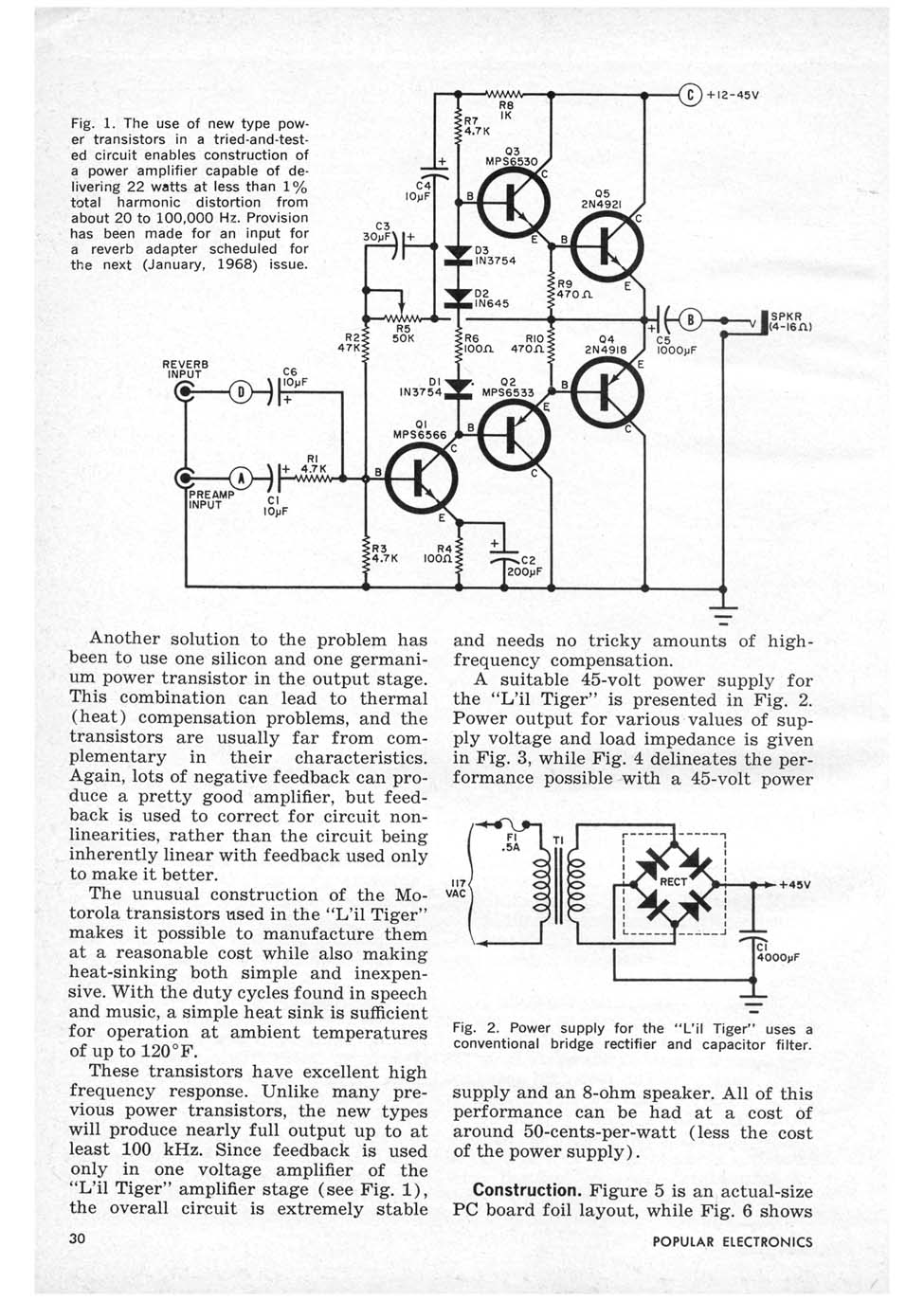

When my buddies needed a quick guitar amp we pulled out a Lil' Tiger for a big 15W. surprisingly good sounding clean to dirty. Limited NFB and a simple circuit. We did have a problem blowing the outputs though, it was not designed for band use. Had a bag of replacements and got it going again in no time.
The Li'l Tiger was the key building block of my first foray into solid state guitar amp building when I was in high school (67 - 70). It was affordable and you could power it with transformers available at Radio Shack. My first one used a DIY preamp whose schematic came from tracing out one of the popular SS guitar amps of the day. It used all discrete transistors. The speaker was a 15 inch field coil monster pulled out of an old organ. I ran the field coil on rectified and filtered wall outlet. The frequency response went low enough that smacking the guitar strings could bottom out the speaker's voice coil. This amp had a reverb tank and a surf guitar sound that I would have died for 3 or 4 years earlier, but surf music had fallen out of fashion.
In 1973 I got a job at Motorola and found several people also interested in making similar stuff. We made dozens of several flavors of Tigers for use in guitar and HiFi amps. The Plastic Tiger and Universal Tiger were our go to circuits for about 10 years.
After blowing the Lil Tiger a few times we stuffed bigger parts in. I don't remember what they were, but I think they were from TI. We built some Plastic Tigers with off board output parts mounted on heat sinks with short wires. Again they were not the stock parts and used a slightly different package. They rarely blew, and the blown ones were usually from a shorted speaker connection.
I still have the power amp section, can't remember what we used for a preamp. Going through a pair of Celestion speakers it kept up to a Twin Reverb and a heavy handed drummer in the basement. Clean? Not so much at that level. But into clipping it had a great Marshall sound that the Twin guy was envious about. The speakers had a big part to do with it.
Just a simple circuit with no great amount of NFB, the distortion curve of the amp rises as the output is increased rather than staying flat and jumping up like hitting a brick wall, which you are when clipping. Still under 1% but shows it is not relying on NFB to clean it up.
Doubt I will make a SS amp section now with the PWM amps but if I did I would go the dumb and simple route as this, or even doing a transistor amp with capacitor coupled stages. I also have a PA SS amp that uses a transformer on the output. Too many possibilities and not enough time.
