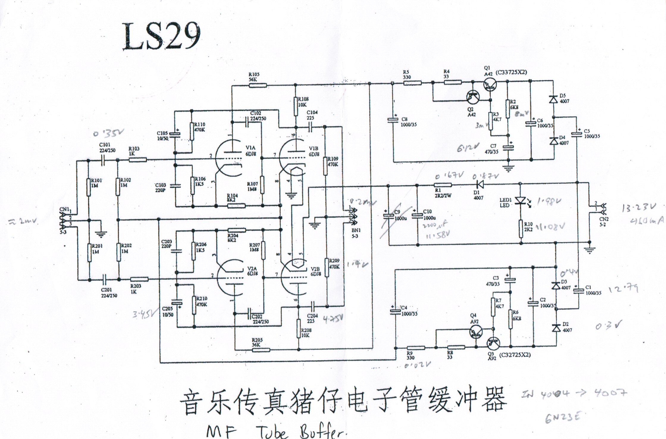

Hi metanastis,
I bought the same PCB and gave it a go - before I saw your post.
Am using a off the wall PSU rated at 12V and 500mA output.
Works but sounds terrible. I have a similar, if not earlier board inside my MF Tubalog which works well. Only reason I decided to try the LS29.
Hence I did a component level voltage reading and am surprised components rated at 35V. My measurements show no where near that value. Hence I am wondering what I could have done wrong.
Thank you for your time and assistance in the matter!

From your description I could not understand what you have done exactly!
What kind of parts have you used? Or you have bought it ready as a kit?
Please explain all the actions you have done so that i can understand where exactly is the problem.
The circuit is supplied with 12volts Ac and after the rectification and filtering the voltage doubles its value through the transistors for the tube plate voltage.If you don't use good parts ,cables and a good tube what can you expect?Please try to define me the construction .
