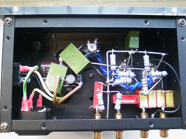

I've just finished modding mine:
1. replaced 0.33uF input caps with pairs of 0.22uF Wima FKP (0.44uF total)
2. replaced 1uF output caps with 2.2uF Wima MKS
3. bypassed rectifier with 0.1uF Russian K71-7 polystyrol
4. bypassed B+ feed with 0.1uF Russian K71-7 polystyrol
5. bypassed AC heater feed with 0.1uF Russian K71-7 polystyrol
6. replaced stock valves with Russian 6J1P-EV
I think the stock output caps are a real limitation - these were the last thing I changed and brought about the biggest improvement. Ideally I'd have used something better than MKS but there was no way I was getting an obbligato or Epcos MKV to fit!
This buffer is now excellent between a TDA1543 nos-dac (passive I/V) and both a 41Hz amp6 and gainclone (both with passive pre). Clearly the passive output stage of the dac is not very happy driving a passive pre directly.

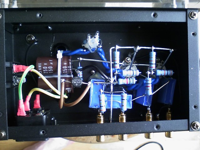

i just get my Yaqin n moded already
the stock china tube with KQDD/K CV4010 tube
and internal i already change the cap for transformer to Elna and i bypass the signal cap to Mundorf ZN .... and all the resistor change to Kiwame Carbon resistor
i got 1 question ... the transformer output is how many volt is DC or AC

200VDC after the regulator (across the first big cap) dropping to 150VDC after the series R (across the second big cap).
The heater supply is 6.3VAC.
L700 said:i wanna ask what the black colour things that connect to 2 big cap thanks
Bridge rectifier, and it is quite clearly marked in the photos.

the bridge rectifier is wut value n spec i really noob 🙁
Looks like one of those small 1A jobs, and PIV rating given the low voltages is probably around 400V. If I could see the part number stamped on the case that would help.
Many people have claimed to be able to hear massive differences when they swap a conventional rectifier or bridge for something using fast recovery diodes. I can't say definitively that I have, so I would not recommend spending large money here. Still these little bridge rectifiers have been the bane of my existence - they all fail eventually.
I'd recommend just replacing the bridge with 4 UF4007 diodes wired as a bridge. The banded end is the cathode end of the diode.
Since you are a newbie please wire up a 60W bulb in series with the ac mains (thus making a ballast lamp) and plug your Yaolin into that in case you make a wiring error - this will keep you from destroying the power transformer. Once you know it is right you can plug it in directly.

it writen RC207 on the case
bridge the 4 UF4007 its the diode got the marked is the end .... ?
its bridge like the picture below

I swapped out the 100uF psu cap (the second one - after the series R) with a 680uF BHC Aerovox.
A layer of thickness in the lower mids / upper bass has disappeared, but bass now goes deeper and tighter. The mids and highs seem both clearer and smoother too.
This buffer is the perfect play-thing for the restless tweaker: it costs next to nothing, most of us will have tons of usable parts lying around and the results are great.
I'm currently using it after my Dac-AH (with passive output mod) so the buffer can be viewed as the output stage of my dac. It's much better than running the dac straight into a 10K pot before my gainclone.
