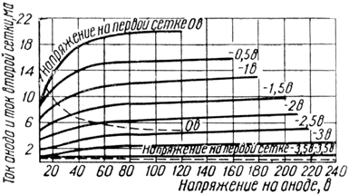

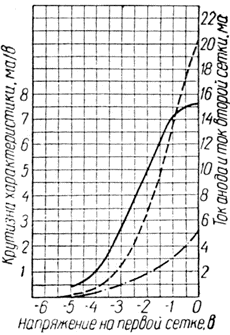

milen007 said:anyone has any idea whats the gain in db for this tube buffer 6j1? thx
hi Wavebourn, sorry. i am a newbie. do not really understand the graph you post. especially in other language. whats in layman language? thanks in adv
no gain from this puppie
cathode follower, hence gain is probably negative. Haven't done the math - I'll leave that to someone better suited.

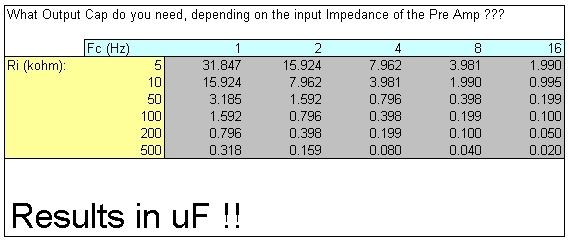

below i attached the output caps table. courtesy of Doede
DDDAC. how to use the table? whats "Fc" on the table? whats the best suggested value of my ouput cap for usb dac (which is not DDDAC)? presume that all output cap for DAC can follow this table? or is this application dependent?
regards, Erwin
DDDAC. how to use the table? whats "Fc" on the table? whats the best suggested value of my output cap for usb dac (which is not DDDAC)? presume that all output cap for DAC can follow this table? or is this application dependent?
Fc is the point in the audio spectrum where the amplitude is 3 dB down from the maximum. Remember that 1 dB drop is not really noticeable by the human ear. Far away from this Fc point, the responses look like straight lines, but near Fc it transitions to a curve. Where the straight lines would have crossed is the Fc point. It's "poles and zeros" in Bode polts, which can give electrical engineering students in sophomore year fits...
regards, Erwin
