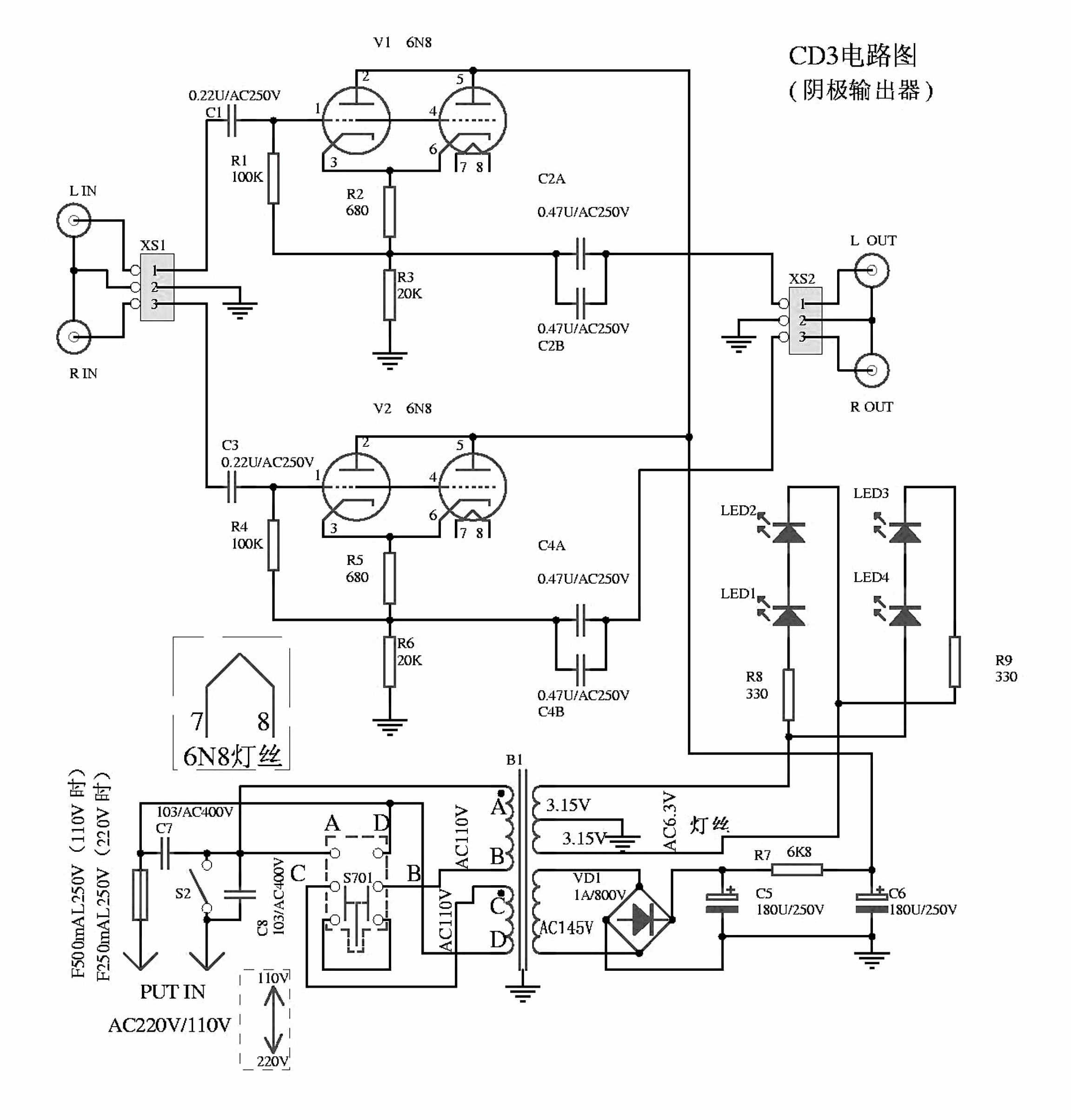

Hi, I have a board with 6j1 that has a circuit same as this but with different voltage and resister values.
The plate voltage is 83V.
The resistor 30K is 330K, 1k is 470R (Rb), 20k is 2K (Rk).
I am using a Russian 6j1p tube now and I wonder if the Rk value is too low.
I have tried to use the cathode follower calculator but I have no idea how to read the values from the datasheet I found here.
TIA if anybody can help me read those values.

Cathode (pin 2) voltage is 7.67V, G1 (pin 1) is 3.57V , so is 3.57v - 7.67v = -4.1V the bias voltage. Sorry, this buffer is my first real attempt for tubes.
Voltage drop between 330k is 0.83V
Sorry, I think I am quite mixed up.
Pin 1 (G1) is -0.41V (another channel is -0.47v)
Rk (2k resistor) is 3.3V
Just for completeness to this thread, I attach a copy of the CD3 schematic which may be useful.

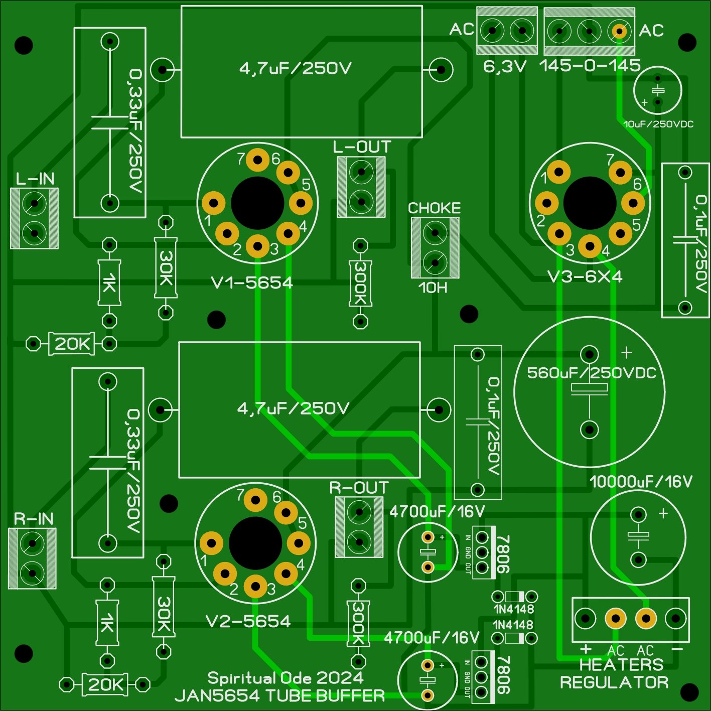

Hello everyone,
I finally built the buffer following the schematic from post#1. Surprisingly, the output was only 750mV instead of 960 or 980 while the input voltage was 1Vp/p.
Is there any explanation for that result? I supplied the input with all available pulses, and there was no distortion, hum, or other anomalies. The only reason I can think of is the floating heaters 6,3VDC supply. if this is the problem, I will ground the negative output through a 100nF ceramic capacitor.
Your answers would be valuable to me.
Thanks a lot.
