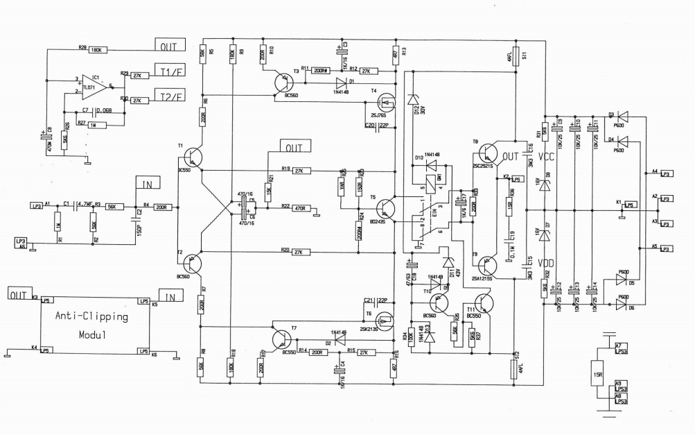

Mike,
Since you like mosfet vas I went to dig up my old archives to show you a design that might be to your liking. This was a commercial design about 20 years old, Class A, 30 W, THD 0.08% 20Hz-250KHz.
It sounds very close to tube amps except its not so irritatingly sweet and doesnt kill the being live feeling tube amps do with rock music. Amp in the mould of Dartzeel. Theres an obvious mistake in schematics but it shouldnt be a problem for you. Its thermally stable and servo takes care of DC offsets. The same design was used for higher power upto 100 Watts.
Many models used the same schematic, the differences was only in the outputstage. I guess the case was the heatsink there. I listened to a Stark, Class AB, roughly drew the schematic, this model has 2 mosfets in parralell as vas and three pairs of sankens. Sounded bloody marvelous if youre into chamber classical or light orchestra music. Which model was class A ??
BTW I see these old amps selling for major euros secondhand considering their age, 2000 euros for Stark pair.
