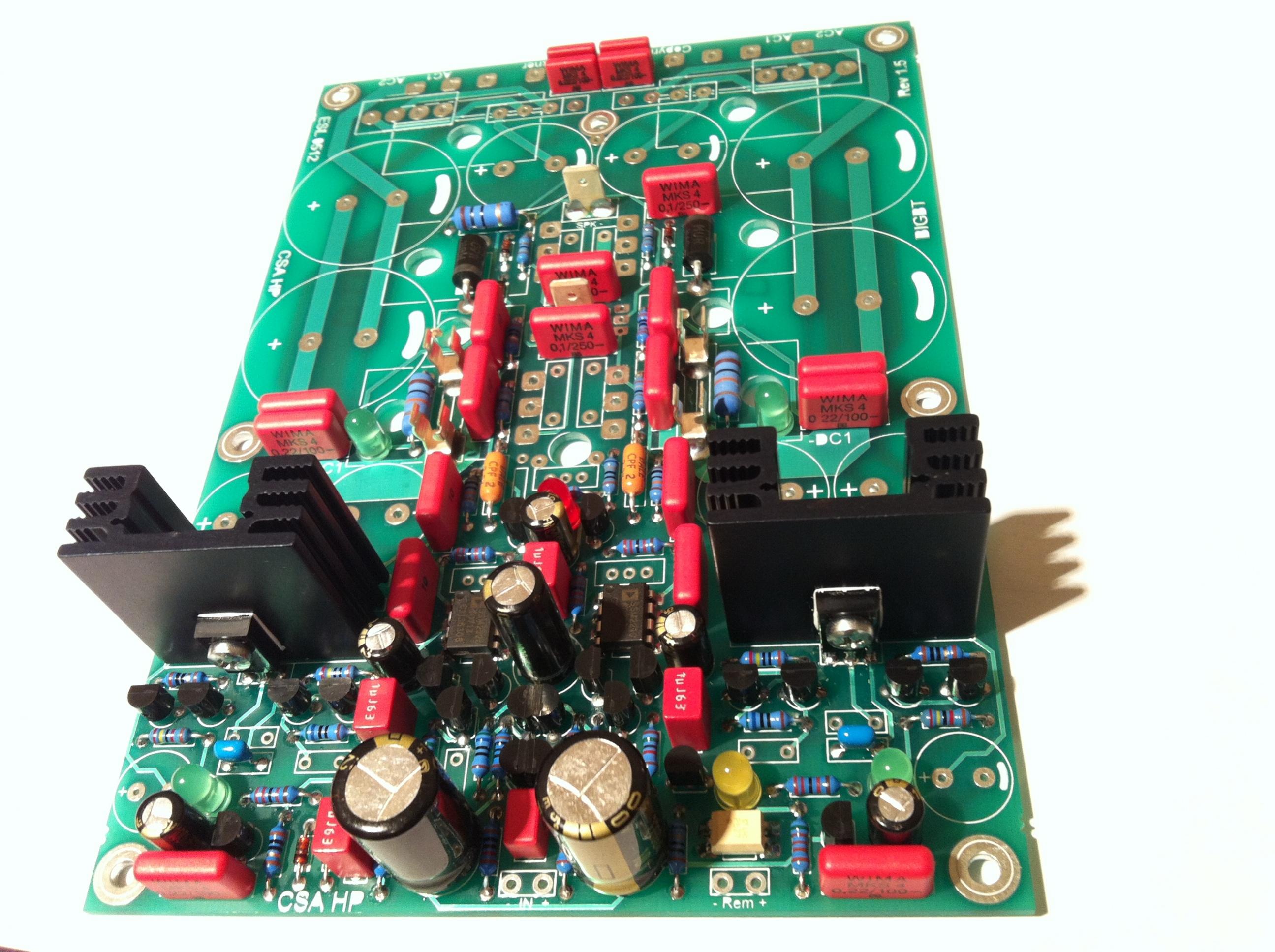

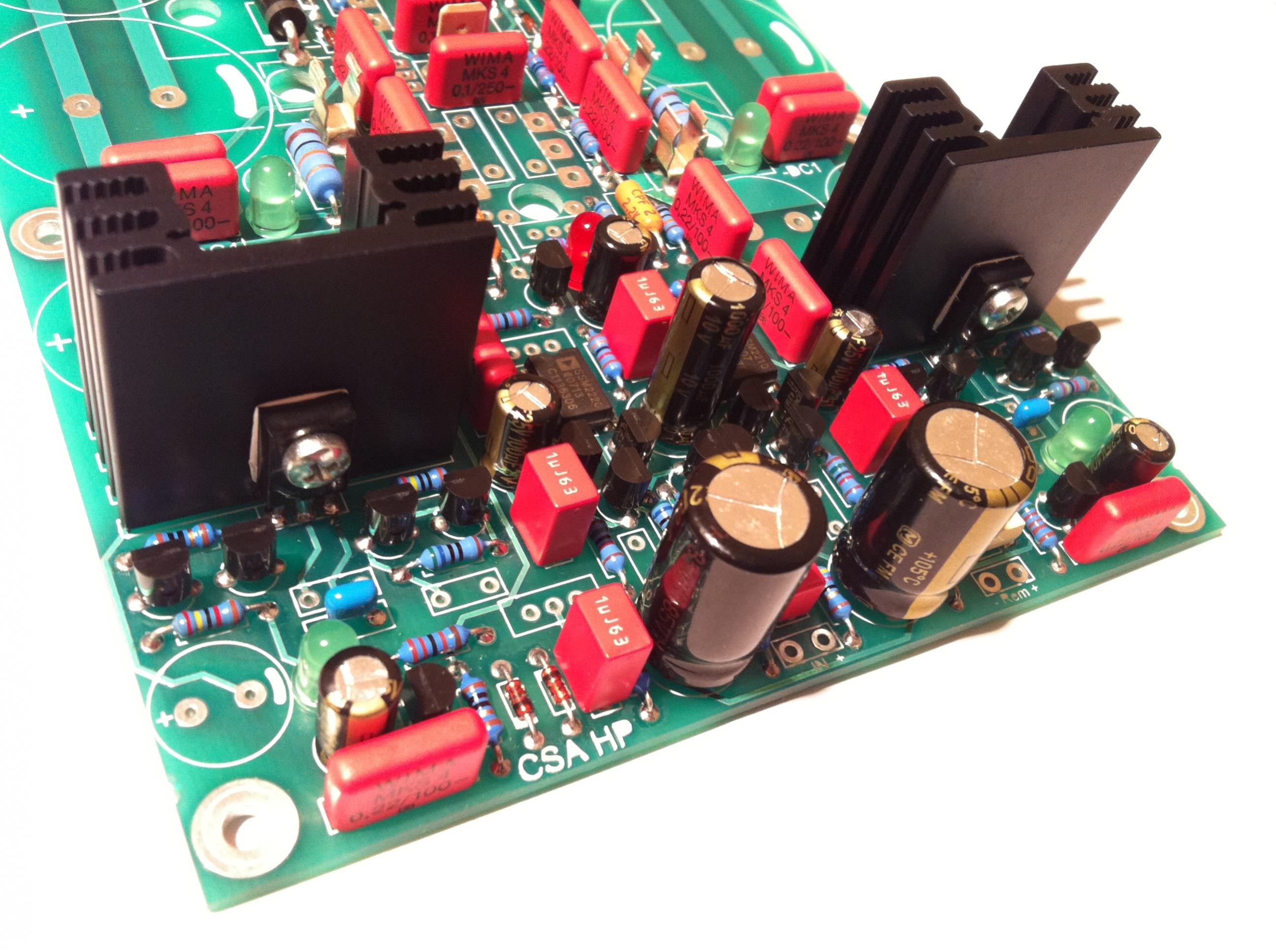

Assembly of CSA PCB-s progressing slowly, still long way from starting CSA thread, since I decided that the right moment will be when CSA will be throughly tested and installed in my system. :yes:
First I have to check front-end stage functionality and performance, but nothing before receiving Vishay trimmers and Murata compensating capacitors. So still a lot of work ahead ... 🙄
