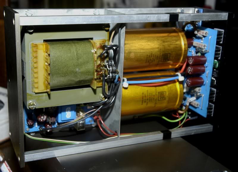

It is strange (and surprising isn't it) how small the heatsink is. According to my calculation the bias is close to 1A. Attached is a picture of the Schnell (2 pairs, not Sankens).

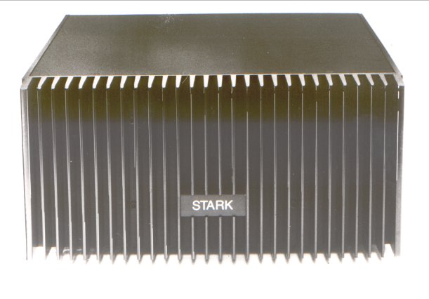

What nasty clipping ?? I happen to have repaired a Stark for a friend, it clips perfectly even without the clipping module. 😕
Stark "industry" Besides of babes, i think that is fantasy!????? 😀
I think youre not well informed, does this look like fantasy ???
Back panel of the Schnell is an 8mm aluminum plate, thermally coupled to the solid square bars.
Outer shell is an alloy tubular with 3mm wall thickness, pressed to the framework with bolts (the back panel plus square side bars have threaded holes in the bottom side), >350 square inch total exposed surface.

The diodes (and transformer size 😀) tell me that it is not a class-A amp. I have cloned the amp and even if with different circuit (slightly) it will be hard to believe if it is biased below 400mA.
For class-A, such thick panel is not enough. No heat compound connecting the case and the body. But it is not class-A so...

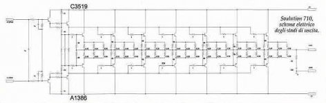

I have never heard the Soulution. If it is considered the best sounding SS by many, then it means that amplifiers' output stage is not critical for that "kind" of performance level (because I don't believe in an output stage that I thought was Soulution 700). I attached the schematic (I don't think it is good at all).

Transformer of the late production Schnell is 300VA, and bias for 75W peak is also regarded Class A by many.

The Schnell runs in Class A up till 1W, with the built-in emitter ballast resistance of the Sanyo output devices that corresponds to a Vt of ~25mV and optimum Class AB.
Transformer of the late production Schnell is 300VA, ...
1W is so small! I don't know about the 2SD/SB devices. If what you mean is it has the built-in capability to limit the current, then that answers my curiosity.
You mentioned that there are more than one versions of Schnell. So other possibility is that the amp picture is not for the schematic I have seen.
The schematic shows 240VA rating (26V). For an EI transformer, the size would be big. I don't think the transformer in the picture is big enough? 😕
