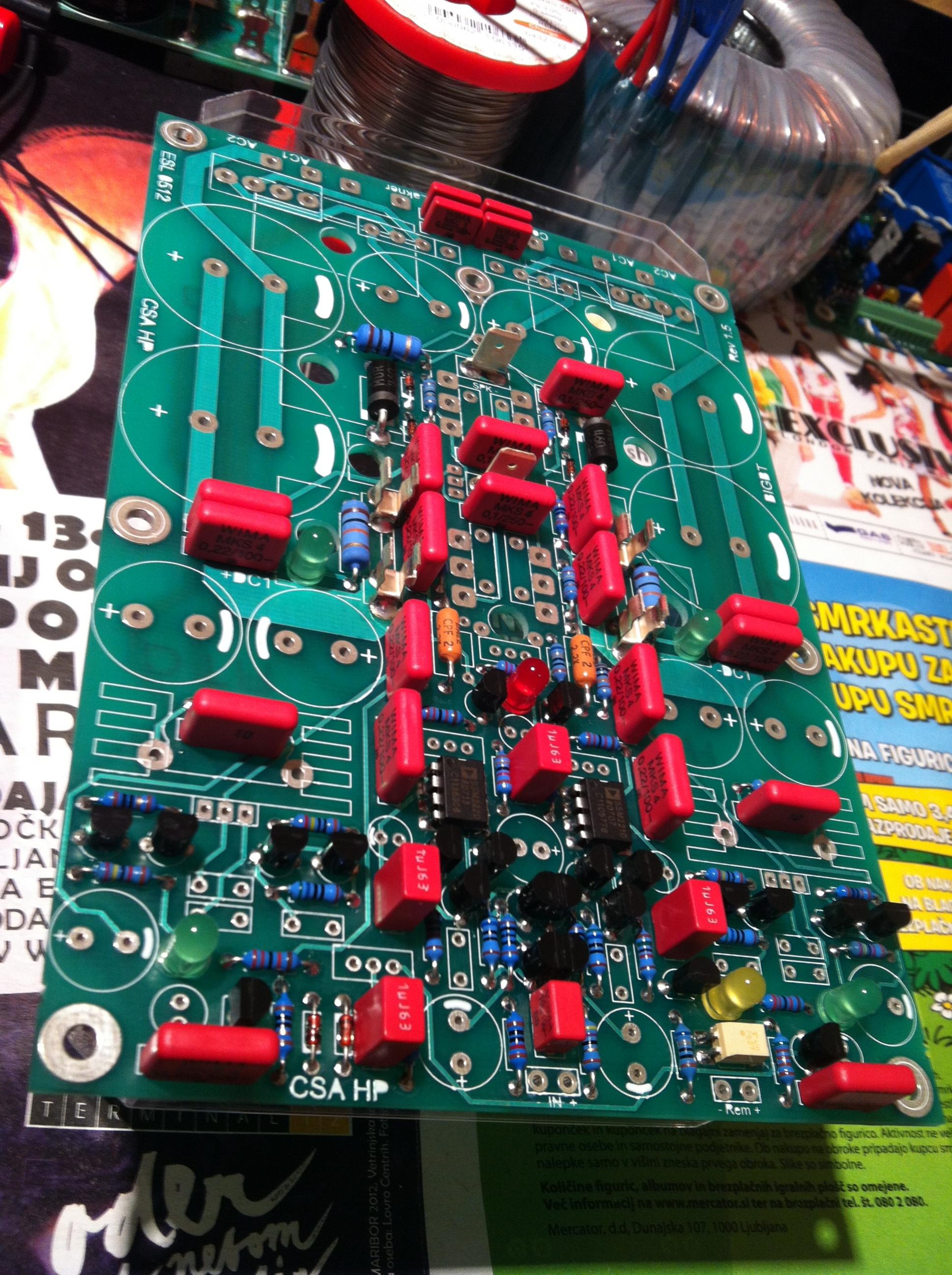

Lately in the thread diamond buffer (DB) as an input and current feedback was mentioned, so just few words about it. Before SSA I also tried to use DB as an input stage and after some critical measurements - instability, I realize that it has the same problem as LTP - two active devices too more in the signal path, this time at the input signal, regarding feedback signal at LTP's. The best stability, speed, bandwidth and therefore sound quality were achieved when modulating the same active device with input and feedback signal, that's why I still stick to this same input stage topology at SSA, TSSA and CSA, only that later two have less problems with tempco/bias conditions, so easier to handle. Sonny your previous amp has DB input stage and similar next stage, so the logical question would be, how do they compare regarding SQ?
BTW as seen on the pic, today I soldered all WIMA decoupling capacitors on both CSA PCB channels, 26 is their count number on single PCB as they are present on all critical points in the layout.
with two stages the stability seems to be so good that tiny loss is probably not much of a big deal and I guess it improves THD somewhat.
Stability with two stages only is really remarkable, I remember in the testing phase when I used two stages only, no compensation cap was needed at all. BJT as front-end follower has more gain (also more OLG) so it is more suitable as a VAS transistor or CFP input, than mosfet. Extra gain dB (CLG subtracted from OLG) obviously and expectedly reduce THD.
Now currently by CSA, even with 28 transistors present on PCB, it is still three stages amplifier only, maintaining superb stability, achieved with minimal compensation needed.
It needs compensation. That is a fact.
On the new board, i have added 47pF miller cap across KSA1381 + KSC3503.
At certain source impedances it was oscillating when i was changing it from Renesas 2SK216 + 2SJ76. The 47pF matches roughly the Cgd value.
It is a concern with CFP BJT pair as they have there own pole. It gives more gain and reduces re (emitter equalint resistance).
An easy way to get more gain (lower THD) and reducing the output impedance is to use ECW20N20-Z/ECW20P20-Z or ALF16N16W/ALF16P16W.
This way the class A current can be set higher as well as they have a lower K/W.
It was demonstrated on the fetzilla thread that actually more OLG can be achieved with a mosfet as VAS than with a BJT.
The i/p stage and VAS are in anti phase and any current leakage between them ( that BJT's draw ) results in in a loss of OLG which dominates over any extra gain caused by a BJT have higher transconductance. Because of this the fetzilla with it's Jfet i/p needed a mosfet VAS to give enough gain for the design to sound good.
However in Sonny's design here it is not so straightforward because there we have a BJT / MF darlington pair so I'm not sure how this would impact the explanation above. But with any 3 stage design I believe a MF VAS will give higher OLG.
well, with a simple version of TSSA I am playing around with in spice changing the O/P VAS stage driver transistor from BC560 etc to ZNV3306 reduces OLG from 44.45 to 44.07 !
So no real effect in this case and because the mosfet had more voltage drop BJT seems like the best choice in this circuit. :)
