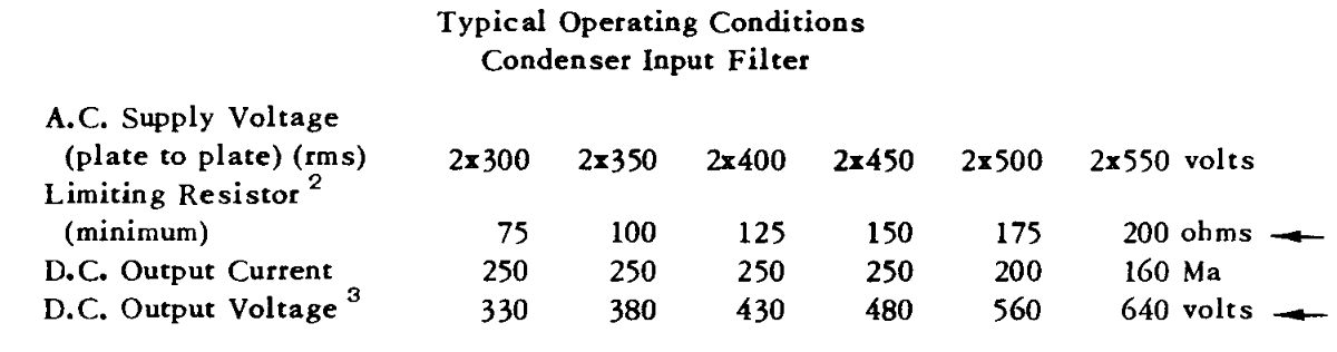

I put the amplifier on the bench and I am trying to figure out the best course of action to keep rectifier tubes alive longer. 😉
The input capacitor, at 47 uF, should be OK, since a 5AR4 is meant to work with up to 60 uF.
The 5AR4 datasheet gives:
So, I am guessing 330V RMS at either plates should not be a problem.
What is clear, however, is that I should have at least 90 ohm of limiting resistor at each plate, and I do not, since the DCR of my HV winding is ~35 ohm and the reflected impedance of the primary would not fill the gap between 35 ohm and 90 ohm.

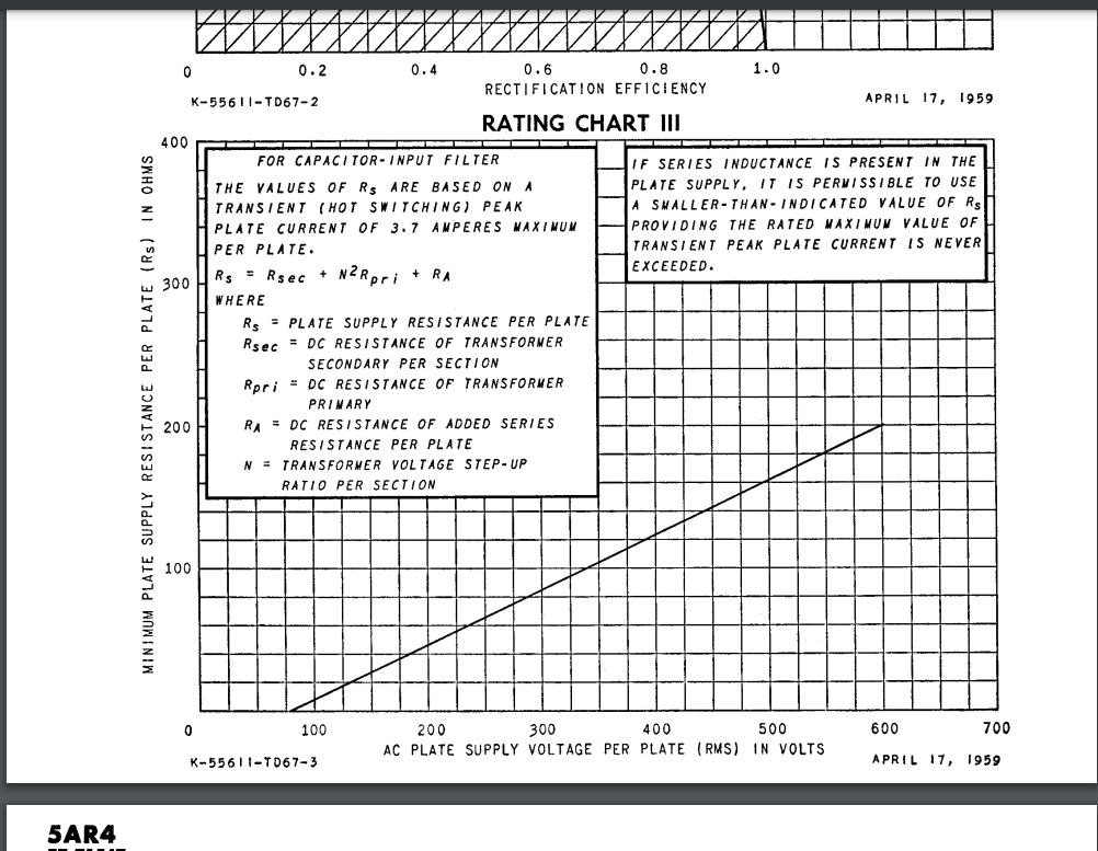

i have stopped using secondary's with center taps for tube rectifications a long time ago, i use hybrid types, a single ht secondary...you can add series resistors to limit inrush in the case of cap input dc supply...chart below gives the formula...
Reactions: ElArte

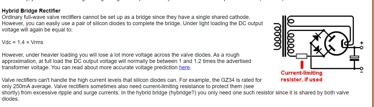

since i design and build all transformers used in my builds i m happy to use FWB or full wave doublers instead...more information here: https://www.valvewizard.co.uk/bridge.html
by using the hybrid type, arc overs can be minimized if not altogether avoided sins the tribe rectifier will never see the kind of ac inputs that the full-wave center tapped arrangements have, tube stress is mitigated..
Reactions: ElArte

what could be simpler than a single secondary winding to feed 5ar4 rectifier plates and add to 1n4007's to complete?
with FWCT psu, half the time or every 180 degrees of the electrical cycle, that half of the winding is not delivering currents, waste of electrical cycles....
transformer utilization is greater by about 30% more so lesser heating of the cores...
purist do what purists do, miss out on the good things...
