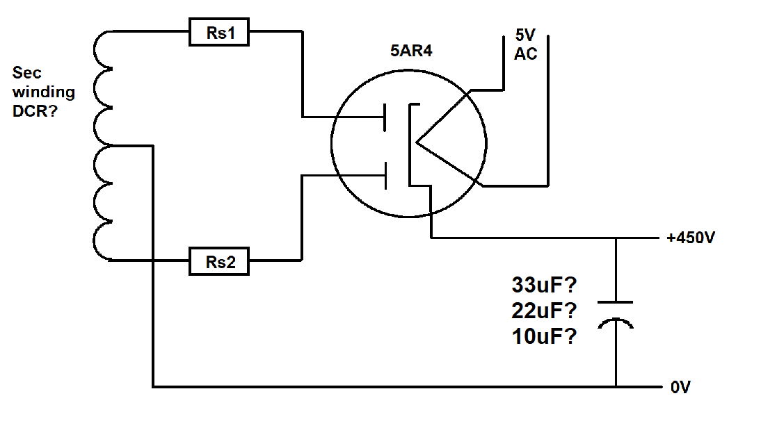

As that exchange indicated, the design of the circuit does not assume additional resistors will be needed. (otherwise, arguably, there would be a spot for them on the board)
Instead, the design of the circuit assumes the DCR of the secondary will be sufficient to satisfy the ~100R of limiting resistance before each plate.
Hence, I say, since the transformer I picked doesn't provide the expected secondary resistance, it is not the best transformer for the job. Instead, I should have gone with the transformer (a Hammond) George had in mind when he designed the power supply of that circuit.
I am not saying Edcor makes bad transformers(, although the one I got buzzes and it should not.)
Edcor makes good transformers, but for whatever reasons, the DCR of their windings is much lower than that of transformers made before 1980.
my calculations is that, without external resistors, your 5AR4 plates is already looking at around 600 ohms at the plate already, for added safety and peace of mind you can add external resistors of say 33 ohms to each plates..
My calculations said 65 ohms to be safe before each plate. PSUD2 also says that should keep the current under 3A through the 5AR4. I went with that and ordered them.

A single resistor from the cathode that is rated for 2 x the watts, is the same as 2 individual plate resistors at 1 x the watts for each resistor.
Less connections, and only one big space required.
That is quite possible. But with that PCB, the 2-resistor approach is actually easier and the heat dissipation will be spread across 2 aluminum bodies.
"You should make things as simple as possible, but no simpler" - Albert Einstein
I have lived by this mantra my whole life. I found "but no simpler" to be most challenging.
StephenClose,
Given a center tapped secondary and a 5AR4:
With 60Hz power mains, a plate resistor gets heated 60 times per second (positive alternation from that secondary lead)
With 60Hz power mains, the Other plate resistor gets heated 60 times per second (positive alternation from the Other secondary lead)
With 60Hz power mains, a single cathode resistor gets heated 120 times per second (positive alternations from one secondary lead, And from the other secondary lead).
It looks to me like the power dissipated in a single cathode resistor is exactly 2 x the power dissipated in a single plate resistor (and there are 2 plate resistors).

I deleted previous post because George already explained why silicon diodes in series with the 5AR4 plates won't work on a TSE.
However, what about series resistors? I'd think one 10R 5W wirewound in series with each plate of the 5AR4 should help damp the turn-on surge.
Also, what about reducing the value of the reservoir capacitor (C4) from 47uF down to 33uF, or even 22uF? Reducing the value of the reservoir cap will reduce the length of time of the current surge at startup from charging up the reservoir cap, which should reduce stress on the 5AR4. Even a 10uF cap should work there, since most of the ripple reduction is performed by the choke and first filter cap.
No?

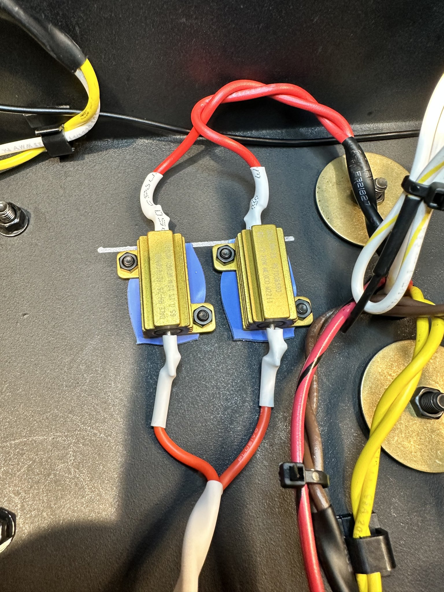

I installed the series resistors today. Went with some Dale 65 ohm 20W. It’s about 7 ohm greater than required, but a little more can’t hurt.
Checkout and biasing went fine. Now let’s see if this Tung Sol 5AR4 lasts more than 6 months. 😂

Trying to use a large capacitor right after the rectifier in order to get low ripple might not be the best way.
But if you have enough secondary voltage, a choke input filter has the following advantages:
Cooler Rectifier
Cooler Power Transformer
Better Voltage Regulation

By how much did the B+ drop? I figure it will have gone down by about 10V DC.I installed the series resistors today. Went with some Dale 65 ohm 20W. It’s about 7 ohm greater than required, but a little more can’t hurt.
Hopefully that's not too much voltage burned off across those resistors.
20W parts should run nice and cool.
Fingers crossed for a long life for your 5AR4.

The main problem with switching from a pi filter (CRC or CLC) to a choke input filter (LC) is the big drop in B+ voltage that results.
The pi-filter here is yielding about 450V B+ (I think). That's about 1.414 * Vac of secondary winding minus copper and iron losses. If figure the transformer secondary Vac is about 350Vac (700VCT).
Choke input filter would yield Vac of secondary * 0.9, which would come out as only 315V DC with this transformer. That's at the upper limits for 2A3, but 300B yields more audio output power with higher B+ voltage.
There is a grey area between a full-on pi filter and a choke input filter.
For each transformer + rectifier combination, there is a critical value of C4 that will get it to function as a full pi filter. Values of C4 lower than that critical value will yield lower B+ voltage, in that grey area between pi filter and choke input filter. Reduce the value of C4 to 0.22uF and you'll have a choke input filter (Vac*0.9). Usually it takes only about 2uF to 3uF to achieve the full B+ voltage of a pi filter. 10uF is usually more than enough to achieve full voltage, and 22uF should be well past the border into full pi filter territory. 47uF will suppress a little bit more ripple (AC noise riding on the B+ DC) but not very much. The reservoir cap (C4) doesn't have a huge influence on ripple filtering. It's the choke and the cap after that that do the filtering (ripple suppression).
Long story short, C4 could probably be as low a value as 4.7uF and you'd still get the full 450V B+. It's probably not necessary to have 47uF there. Remember that the C4 reservoir capacitor has to charge up during startup. While C4 is charging it will be drawing great big gulps of current right through the poor 5AR4 tube. Reducing the value of C4 will shorten the duration of that charging period, saving wear and tear on the 5AR4.
As in all things, it's going to be a balancing act, a compromise between this and that. Almost always, engineering is finding the balance between desirable features and undesirable side effects. A 300B would give the most power and lowest distortion if fed 500V on its plate and drawing 100mA of plate current. But it would burn out quickly, which defeats the purpose. One has to compromise and stay within the limits of the device you've chosen. So it is with the power transformer, the rectifier, and the reservoir cap. You may have to give up a little ripple reduction to reduce the charging time of the whole thing, so you don't overstress the rectifier. Everything is a compromise.

I made it work:
Little did I know this oversized Hammond steel enclosure would prove so useful.
Addendum: Very interesting additional finding…
After installing the new resistors and going through checkout, I noticed I had no B-.
After swearing for a few minutes and wondering how far the rabbit hole would go, I discovered R5 had failed open (check the schematic for its location).
Based on reading so many posts on TSE quirks, I recognized mystery #2 some builders encounter.
The odd thing about that one is how the resistor failed. It’s indeed completely open, but looks absolutely pristine. Hence I never suspected it would be a problem and had to take out the board out a second time to replace it.
After that I was able to complete checkout without issue.

What type of resistor are you using for R5? That's the first resistor in series with the rectifier diodes for the negative supply, correct?Addendum: Very interesting additional finding…
If so, it could be that on startup there's a lot of voltage differential across R5, and it's burning out after a few power cycles. Try using a 2W or 3W resistor rated for much higher voltage than it will ever see. 1/2 watt metal film resistors have a max voltage rating of 300V or 350V. It could be that you need to use bigger wattage resistors for their larger voltage ratings.
This Vishay 270R 3W metal film resistor is rated for 750V.
https://www.newark.com/vishay/pr03000202700jac00/metal-film-resistor-270-ohm-3/dp/94C3772
That would remove this worry, right?
