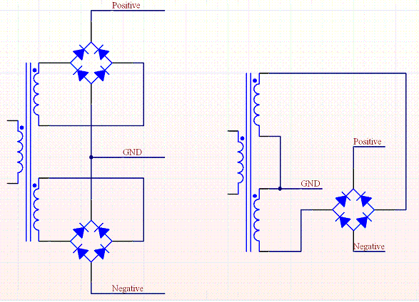

"rectifier on each rail" means connect in series not paralel. but obviously you either fogot or you don't make the difference between series/paralel. check your own post where you write this.
to help you to understand i will attach one schematic. the left side is what you said , the right side is what i did.

A closer look at the datasheet of the rectifier you used teaches me (from the graph temp/current) it can handle just 5A continuous current when used without heatsink!
That's crazy underrated!
The peak current also doesn't hold up without heatsinking....
It REALLY TOO SMALL!
How did you solve this? NTC's in series?

and how much does hold when is used with heatsink. imagine that the bridge is fitted onto heatsink. and also imagine that if a bridge is not fitted to a heatsink it will hold the peak currents if they are short pulses with long period but not hold constant medium-high current. read some books where they explain this and maybe you will understand why.
where from u got the ideea to use an NTC ???? did you ever saw this in an amplifier, in the secondaries ?
do you have ideea what is an NTC at least ?
you still didn't solve the mistery from the previous post, where the bridges are connected in series or parallel.

The solving the mystery is in the idea I had that there will be always two diodes conducting with a dual rectifier and with a single rectifier there will be one, I only overlooked that there is also a wire conducting there :apathic: This would perhaps introduce some more ripple (?), but providing you use enough capacitance this will be filtered away just fine. Then still two rectifiers will have better dissipation. Still all benefits and down sides here will probably be negligible.
I didn't see the rectifier is mounted on the heatsink on any of the pictures.
I would never use an NTC in the secondaries myself, but I know it is done by others...

and surprise: even in a single rectifier connected as in the schematic which i post before, there are always 2 diodes which are conducting only when the V AC is > V DC+diode drop voltage (did you know that??) not always like you stated.
if the diodes will conduct always, i don;t think will have any DC voltage on the rails.

i mentioned already that the photo is without the heatsink. here i made the biggest mistake. i removed the heatsink to allow your imagination to run free.
