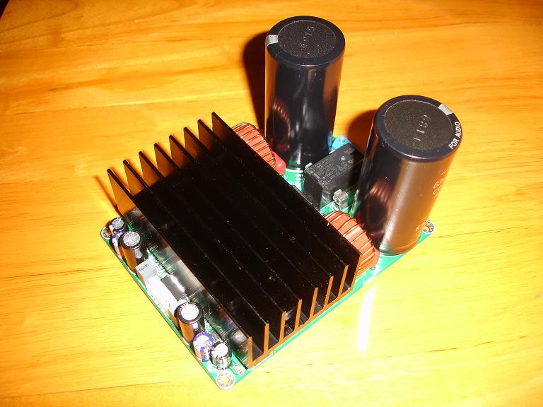

Okay, it's been a long time now... Since I last posted here I have read numerous complaints on different forums about the TA3020 module from Connexelectronic.
i tought you already got bored to launch personal attacks against me and my products.
numerous complaints ? how many ? or better said how many are real and how many are due to inproper usage or even inexistent at all, just inveneted story by spammers like you. just fill the list here so i can check which one is what and issue full refund for the real ones.
just for your poor knowledge i already sold over 650 modules from version 1-3. did already half of them died ?
like you were ever able to design something.😛Yet again, it's NOT my design!!
i think you are expecting a price turnover in this field, so everybody can enjoy the end of thipath with half price amplifiers. don't tell me twice.
Ok, maybe I should rephrase myself and be a little more specific because I had an email from Cristi that I am hurting his sales...🙁
The hum problems that were experienced by that customer I linked to is most likely not related to the module, but to the implementation by the user.
Remains the BIG turn on thump and heat issue. The heatsink would get so hot that it burned the guy's finger. I read somewhere earlier on here that it would run super cool, so I am keeping that in the middle too...
Cristi offered a refund to any customer with real complaints with the module. That is good service at least!
Only he does seem to keep thinking it is all about the money, which I don't agree with....
please don't invent stories. you're just making me notorious. actually i sold more since our last rendezvous but if you want, continue.
did he used a speaker protection circuit ? or at least the Mute function ? in the TA3020 datasheet, page 18 bottom, 19 top, and in the manual which i wrote for the modules is explained.
how hot is it and what kind of enclosure, supply voltage and BBM settings he used ?
i think will be a good idea to invite the owner of that module here. i prepare for him replacement or refund if the module is faulty
and others too...

I would perhaps even buy modules from you if they had a bit more supply buffer capacitance, on board speaker relays with the proper timing to prevent thump. A four layer board with ultimate shielding properties and ultra low trace inductances towards the fets perhaps? This is just part of it, I also have some whishes for board terminals at certain locations, a drop in size for a nice casing, I would have many practical ideas design wise... Even though your customers are mainly going for the bargain price, I really am not. For me the real quality is priority number one, low price comes second.
Solve said:Im pretty shure that with an A-B test with Connex and 41hz you cant hear any difference.
I would be more than willing to try this out! I have noticed the difference in a blind fold test between two 41hz modules, one with minimal buffer capacity (and lower VA rating transformer) and one with double what was necessary. The drooping supply voltage as a consequence of the low capacitance (and low power transformer) worked out really negative for the dynamics. This was more than just audible! It was MAJOR! Even though I was more than sceptical about this at first. Even though the voltage drop was just quite tiny (less than 1Vdc!!)
Even though I may not have the technical knowledge at the level of Cristi. I have built hundreds of amplifiers, not only 41hz. So I may call myself an experience expert.
you mean like this one ? Connexelectronic
capacitors from 10mF to 18mF or even bigger if someone has them available in 35mm footprint
if money aren't a problem, please send me 800 usd and i will tweak one for you exactly as you wish. till then, i consider this module a good choice.
Of course i understand you hear difference with differ buffer!
Try same buffer to an AMP15 and Connex TA3020 and i doubt you hear any difference.Im not talking about an "golden ears" person now...

11. You use many cheap tantalum caps where other designs use nice low ESR high ripple and long life caps.
i've seen the same remarks and not only on at least 2 other forums, one english forum one dutch forum. now, probably i must explain the reason why i'm using "cheap tantalum caps" instead of the suggested ones.
we can start from here: TPSE476K020R0150 AVX Tantalum Capacitors - Solid SMD
UVZ1C470MDD1TD Nichicon Aluminum Electrolytic Capacitors - Leaded
where is a straightforward price comparision of a tantalum cap and a leaded Aluminum Electrolytic Capacitor.
we can also go further by reading the datasheet http://www.avx.com/docs/Catalogs/tps.pdf
now, i have a beginer question: what is the importance of the ESR in this particular application. please take a look at the schematic before making any comments.
the "very hot amp" wasn't solved till now, simply because the owner of the amp cannot describe me exactly the condition where this problem ocure and right now he cannot send me the amp to repair or replace. anyway i keep in touch with him and try to solve the matter.
how many of you still have this problem ? can you post here ? i have some doubts that is a design issue if there aren't a lot of them with this problem (just one till now)
I bought my "sample" of the TA3020 based amp (version 3B) from Connexelectronic. I also got the A1000SMPS and the DA-1.
The TA3020 works great and I have no issues with heat even when trying it with some "difficult loads".
The built quality is pretty good and I recommend this amp based on my own experience.

Ok, I'll bite again...😛 ESR, effective series resistance. Not too important a value, but an ideal capacitor has zero ESR like a wire would have zero resistance. Higher values have a disadvantage of generating heat induced by the current passing through the capacitor. Another disadvantage is the damping effect on the charge/discharge performance. In audio applications ESR is not often a problem, but in applications of high switching frequency and/or high current it can become an issue. Recently there has even been a discussion going on about the down side of the higher resonance frequency with low ESR caps. This would negatively affect the performance in some applications.
This surprises me, the parts that gave high temperature issues with designs I tested are the very parts I see mounted on the board of this particular module.
And then still it's just one module out of 700 now, others may use other adjustments and parts? There are a bunch of versions.... From the pictures I have seen from his module some part values have been copied straight from the datasheet and were on the limit there already to achieve the absolute max power. His module had resistor values for the voltage sensing conveniently, but dangerously rounded to standard preferred values even more towards possible disaster. This sensing works pretty slow already in the TA3020 chip, with a bit of power supply pumping, especially with the capacitance you have chosen on the module the supply voltage can easily peak to dangerous levels.
I'm surprised you haven't yet had blackened modules returned?! I must admit I haven't done any crash testing myself so far, so maybe I'm being too scared? Have you?now, to distract someone's attention, we won't compare the extraordinary trupath with crap connex, instead we compare the hypex with connex.
