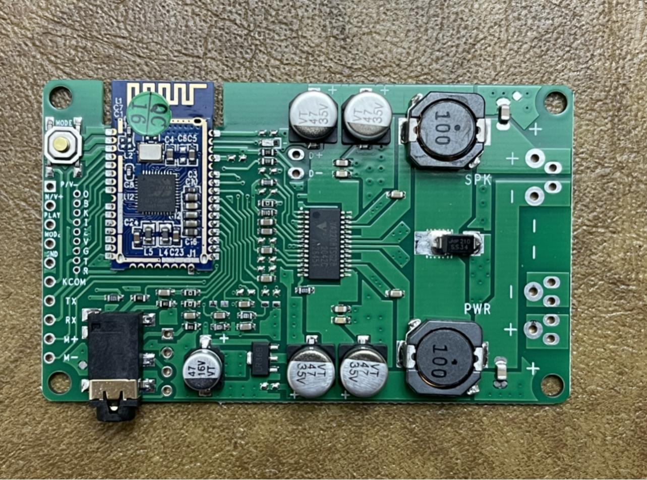

Do a YT search for “stereo audio test”. It will have stuff playing left or right and panning.I have now confirmed that each board have a mono output of left/right on each respective board with a classic, Money from the dark side of the moon. The pan from left to right makes it obvious.
Because playing a system tuning track that literally say righ channel left channel is no sport..

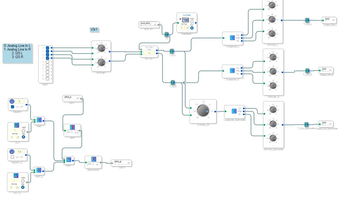

The TinySine has built in DSP crossover? That’s really cool.The single audio channel can be routed via crossovers to all the amp channels. I'm currently using TinySine TS7800B (Apt-X) boards (2 X 50W plus 1 X 100W) in 3-way speakers. Each board has the same crossover network which divides the single audio channel into woofer, mid and tweeter outputs.
Which Analog Devices DSP chip is this board running? ADAU-1702? I am very familiar with Sigma Studio.

TSA6014 - Bluetooth Audio Receiver (TWS/Apt-X) is a possible solution for your application
The AIYIMA is mono and can play left or right in stereo once paired.Hi all,

Am I overlooking the board options available from TinySine, or is there not one that would fit my requirements of 2-way DSP with aptX? I want to build a pair of wireless 2-way bookshelf speakers.

the EQ setting should be good because Arylic uses the same chip for its wifi streamers - it has the same USB interface for setting up the tone and other features.I have received the boards, and it has some cool features. I chatted with the seller and got their version of ACP-workbench sent to my mail. Same software as Acrylic? As soon as you plug the board in the computer it switch to usb sound card mode. The software is responsive and I had no problem to make a correction eq for a pair of headphones I made.
One button to switch between Bluetooth, line in, usb sound. And for a few seconds ago the seller finally told me how to put it in TWS.
Turn of Bluetooth on the iPhone in my case and press the button on the board three seconds on both board at the same time. Then the boards will present themselves as right and left channel.

You can use the TSA7800B (2 X 50W + 1 X 100W) and not use one of the 50W channels. A little wasteful, but it works.Am I overlooking the board options available from TinySine, or is there not one that would fit my requirements of 2-way DSP with aptX? I want to build a pair of wireless 2-way bookshelf speakers.
Not that I have found. One could use two Tinysine TSA6014 for the TWS at $16 a piece, and use them to feed two Dayton DSP-250 for Sigma Studio DSP and 2x50 watts at $36 a piece. $52 per side plus power supplies.Am I overlooking the board options available from TinySine, or is there not one that would fit my requirements of 2-way DSP with aptX? I want to build a pair of wireless 2-way bookshelf speakers.
