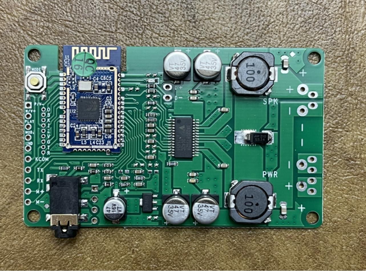

They just play mono and you can use either of the outputs. I suppose for safety, one should add a 200ohm 5W dummy resistor on the unused side. This is also useful for a two way speaker where you biamp the woofer and its crossover separately from the tweeter's crossover.

I’ve been playing with these boards lately and have been impressed honestly by how they sound.
I had two of them connect at once the other day, but didn’t play anything to see if they were in accord with one another.
Bluetooth Audio Receiver board Bluetooth5.0 MP3 lossless decoder board Modu$s | eBay
They are based on the Jieli AC6925C receiver chips.
a) Are these TWS boards, they dont mention TWS anywhere?
b) As I understand, in TWS setup the source BT side transmits a stereo channel (typically a mobile phone) and on the receive side there are 2 TWS modules each acting as separate L and R respectively. Thus one can just buy 2 of the modules and make a BT stereo speaker system with it. Is my understanding correct?
From what I've read when in TWS mode one chip acts as the master and one as a slave. The master receives both L and R and transmits one channel to the slave. To overcome latency the master and slave send packets back and forth to determine the round trip latency. The master then sends one channel to the slave, delays 1/2 the round trip latency and then processes the other channel.
I just tried to repeat the dual-connection once again, and while two units will connect at the same time, only the last one paired will play.

On mine, you have to press the SW1 for 3 seconds to enable pairing with a new device. Once paired it remembers and you can have several different devices connect to it.
Nice looking board there. I wonder if it would work to bridge each board for more power, or access to a dsp to allow use as a crossover?
I verified that it puts out the same mono from right or left channel of the same board. I suppose the output could be paralleled to allow driving 2ohm loads (pseudo PBTL?). Not sure if the amp will like that though without changing some other switching parameters. I am only using one channel. On second thought I should have put a dummy resistor on unused channel as Class D amps can blow out from back EMF on inductor when there is no load attached.
There is no DSP on this amp that I am aware of as TPA3116/3118 do not have built in DSP.

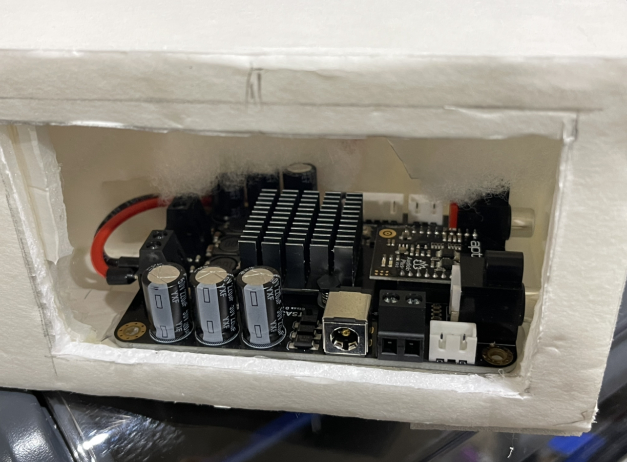

I just got the AIYIMA TWS amp boards. They look well made but components are smaller and leas expensive than the Tinysine boards. They are mono which is nice. And supposedly to pair TWS you press the button on either board but it becomes the right channel.
