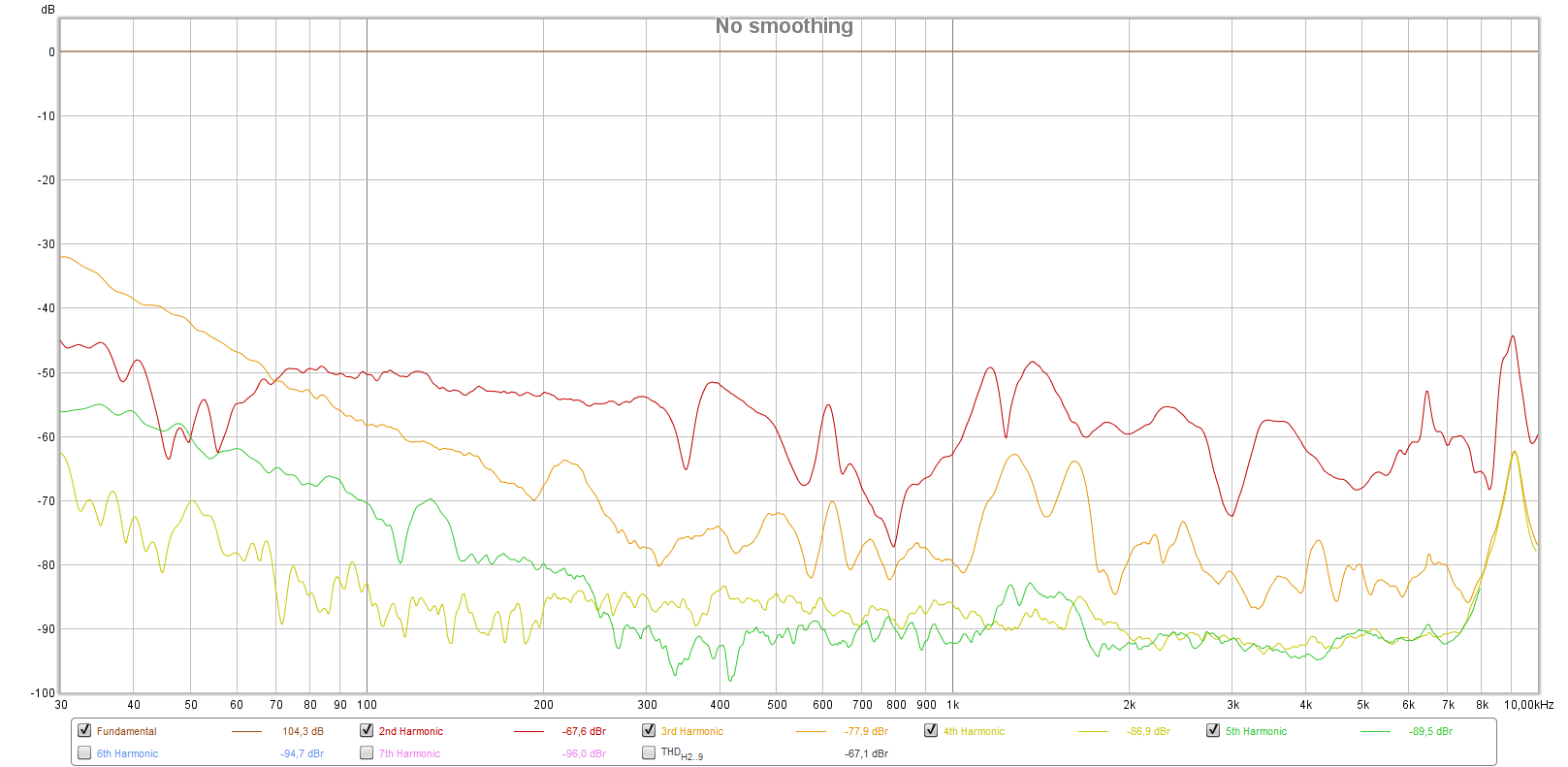

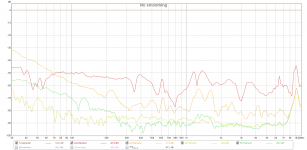

Probably not popular opinion, but here it is...... This is often discussed topic and and I see people looking at the graphs disregarding certain driver just for this resonance. I used 18WE as midrange in 3way with T34B in WG and 32W revelator. 18WE 1300Hz resonance manifests itself in distortion graphs, and in waterfall as well. But the distortion levels are veeery low, and distortion at 1300Hz can still be considered veeery low as well, so is the resonance really that bad for the ears? Decay ridge at 1300Hz also does not look terrible. There are drivers with clean performance 1000-200Hz though I still would take 18WE over them. I take it that SS made design choices, and with cone edge treatment they mitigated the issue. Speaking from "hands on, ears on, mic on,..." experience with SB17, Satoris, Illuminator, W18NE, Peerless NE line,......
Are distortion really that low? No, and it shows on measurements. But I can agree that 2nd harmonics are perceived as ok'ish. I don't see anything special about the 18WE except for nice engineering/looks and price tag.
Test Bench: Scan-Speak Ellipticor 18WE/4542T00 Midbass Woofer | audioXpress
My measurements attached, 2,83V, 30cm mic distance, Earthworks M30. And again, ears on experience is as same important (actually more, thinking of it) as measurements to me. I do not disregard the importance of measurements, I measure a lot.
That Audioexpress measurements are....well at least something, but they should bring it to new century, see Hificompass for comparison.
