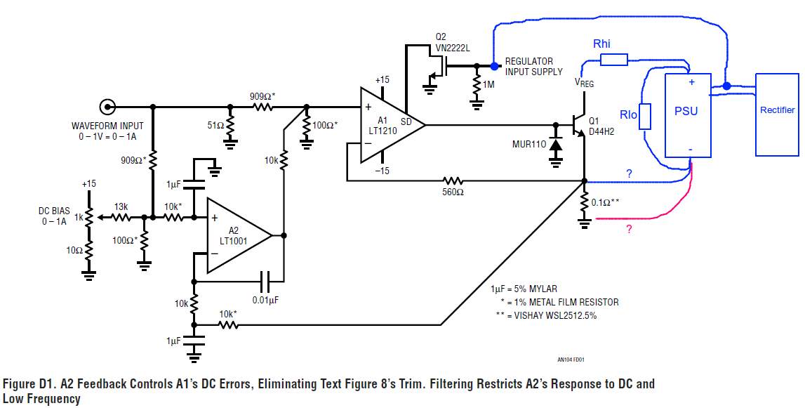

For transient load test, between two current values, i use a Jim Williams design (him again !) describe in application note AN104 from LinearTech.
This design allow more than just makes load test between two value, but allow to test the output of PSU with any current waveforms.

Transient load tester looks fabulous. What circuit you are built: from fig.8 (pg.4) or Fig D1 (pg.15)?
Hello,
Prasimix, the schematics of the short circuit tester is very simple, i think we can guess it just with the picture !
If not, you read below it's full schematics with my high-end CAD;
Else, the transient load tester is based on D1 schematics in page 15 of AN104, using no trimming and a bipolar transistor.

AN104-15 question
Hi Frex, I have one more question regarding transient load tester from AN104-15: when you conducted testing where minus/gnd terminal of PSU module was connected: to Rsense (blue line) or to the tester ground (red line)?
I presume that you have two load: Rlo that draw Ioff when switch is off and Rhi that in combination with Rlo draw Ion.
Huh, it seems that I was pretty tired yesterday to ask such obvious question . It should be red line otherwise current cannot be sensed on Rsense. Sorry.
