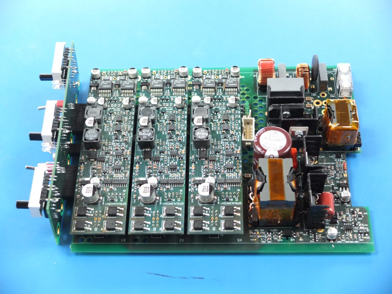

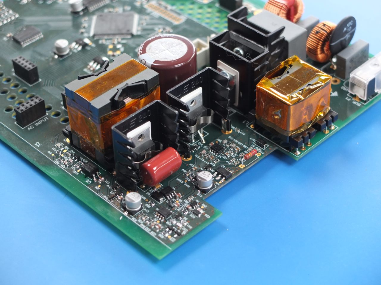

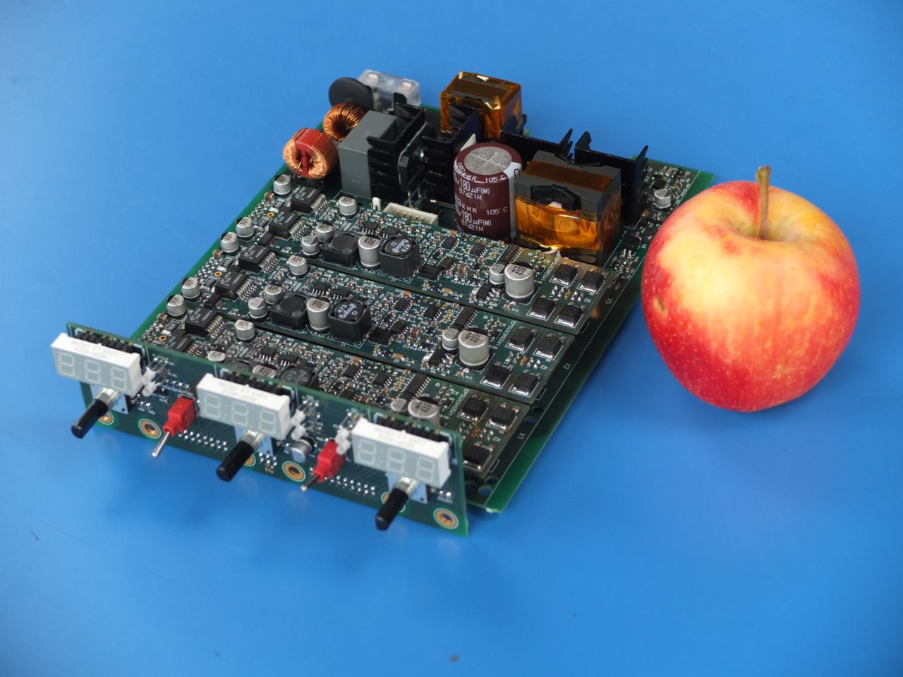

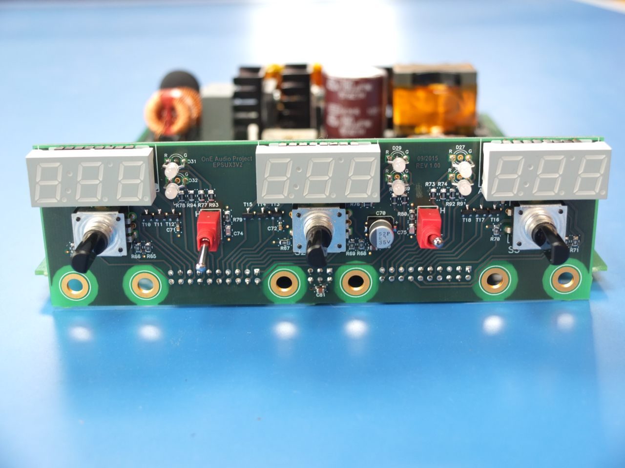

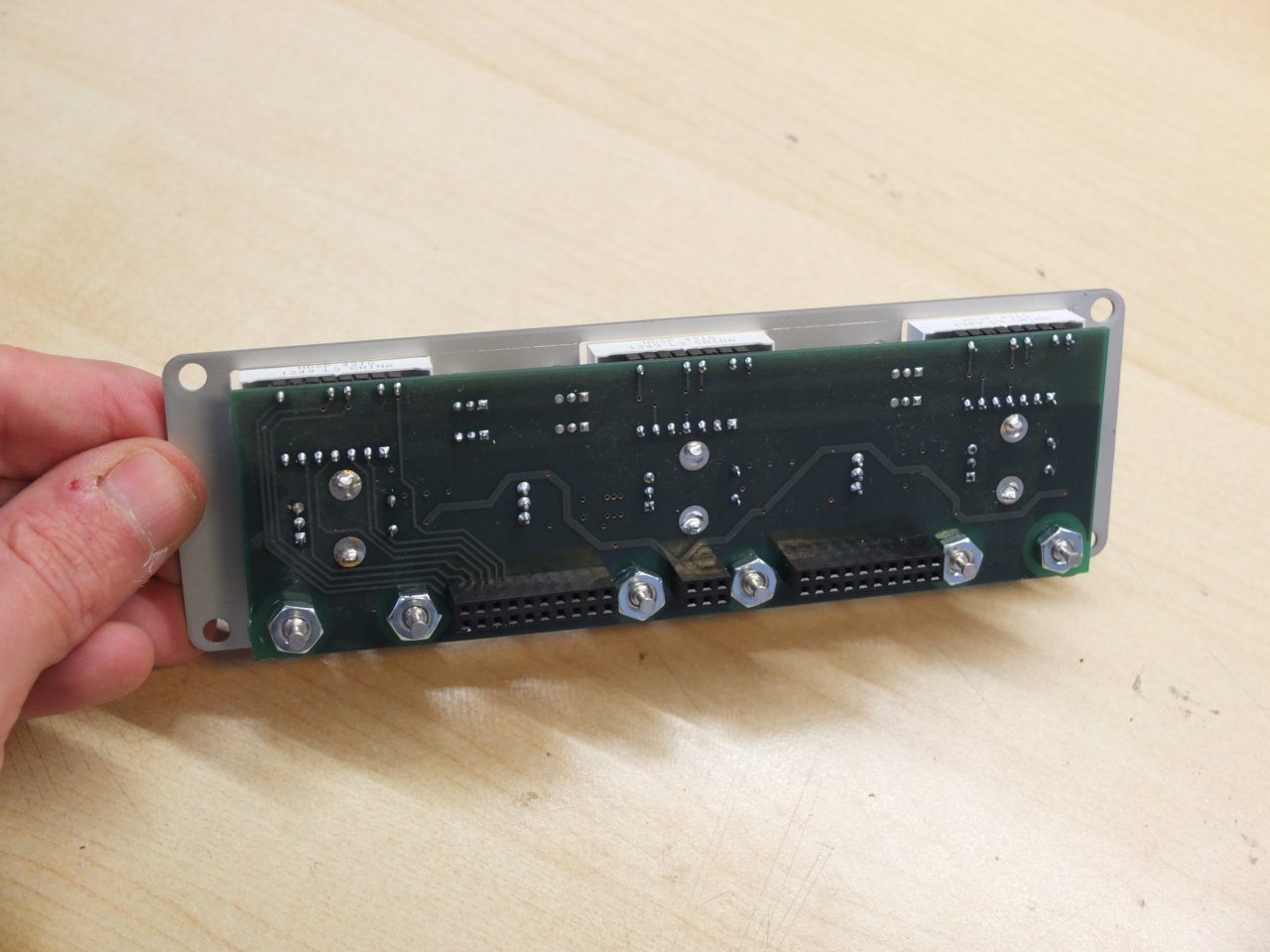

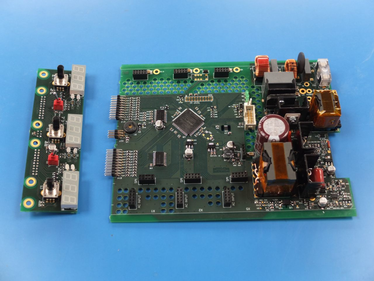

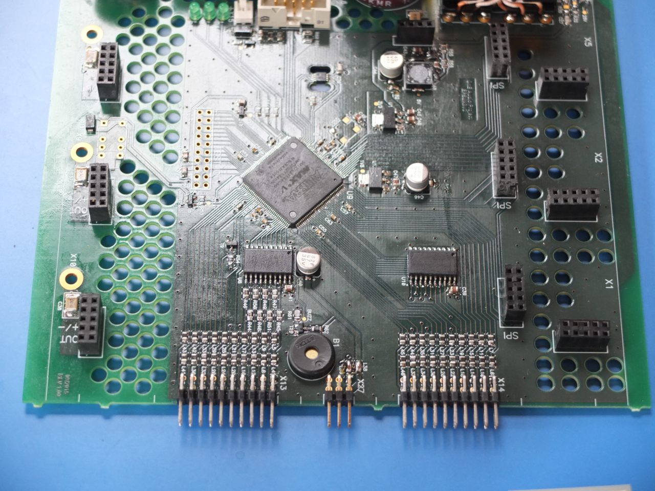

EPSUX3V2 all boards wired.
Hello all,
From my last post some work has been done.
The two circuit board (main and front panel) has been fully wired, smd and through holes parts.
The magnetics parts has been also newly wound, and i wrote a full winding procedure for LLC transfomer and PFC inductor including many pictures.
I've also work on moving to Quartus II version allowing MAX V device i use in board.
Many tests are in progress. I 've started to supply the logics with extrenal PSU, and 5v/3v3 and 1.8V are ok. I've also tried to program the CPLD with a test software successfully. At this point i have seen a "fu..ing" pcb routing issue...
I've inverted the signals coming from the two right angle 20 pins connector of the front panel board...**** !
So, all pins coming directly to or from CPLD can be input or output as i program them inside. So, many ot them can stay in place with only CPLD software changes.
So, for others pins coming to HC540 buffers, i need to add many "on the fly" wires to route them in correct way. I think to do that nicely.
I need time to continue all tests that are very numerous here !
The mechanical has seriously progress too. All circuits boards fit very well in the enclosure, and i cut out prototypes panels in thick carton to check all holes placement before to machined the real aluminium panels.
Some pictures of the wired boards :
Some others pictures with circuits boards in the enclosure will be posted soon.
To follow...

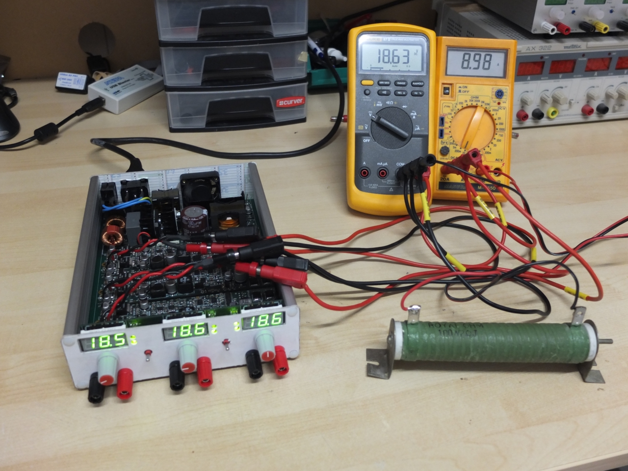

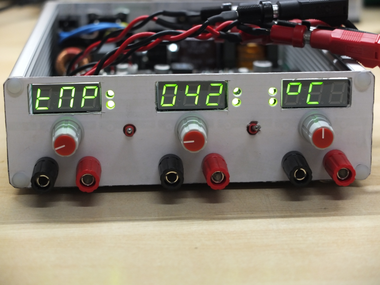

Hello all,
The CPLD Rev 1.0 is fully programmed and functional.
All needed functions is implemented and work fine.
A big step has been reached today, i tested the EPSUX3v2 as a whole :
The off-line primary smps (PFC+LLC converter) powering
all three regulators boards (EPSUX3REGv1) as expected.
And the result, all work fine.
You can see below a panel picture when we use the temperature sensor measurement.
On this other picture, you can see the EPSUX3v3 operating
with slave mode of channel 2 and 3 (master CH1), where
all channel are connected in parallel to get 9A at 18.6V ! ( 166W).
My big 2R 100W resistors has started to smell bad very faster...
It is possible also to combine all outputs in series to get more voltage (60V 3A).
Now, i must drill the enclosure and panels.
After that, i will send design files to make beautiful Lexan panels.
I start also to write the "preview" manual, describing how to use it and to
summarize technical specifications.
To soon.
FRex

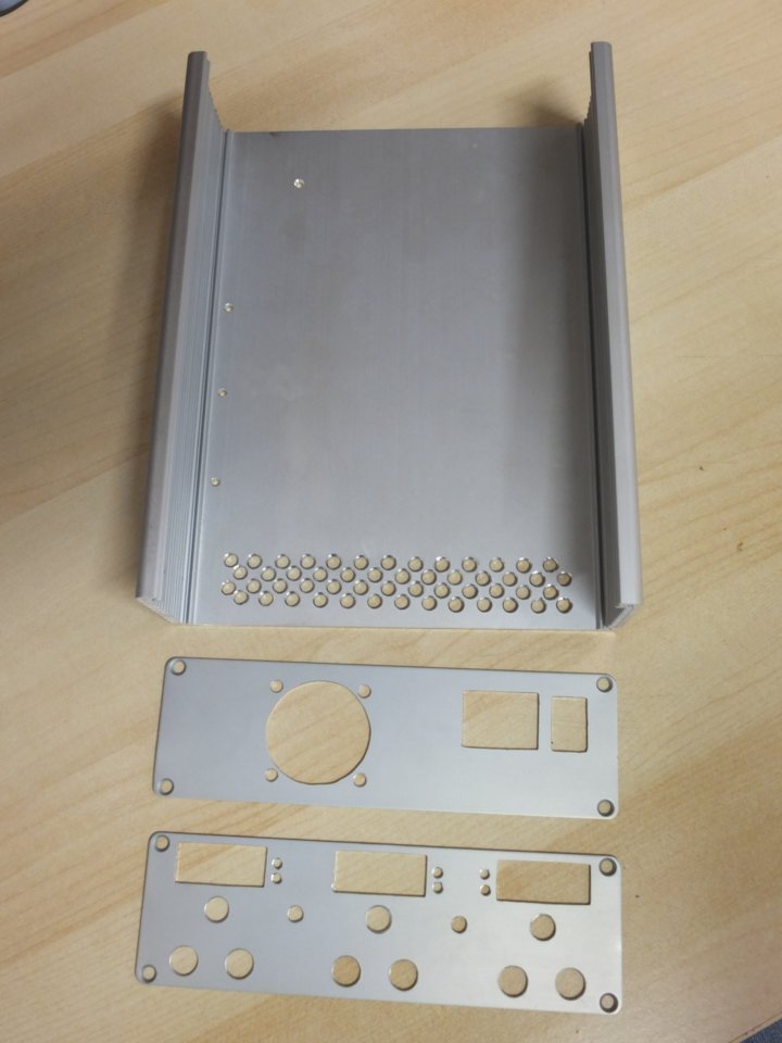

Hello,
Thank you Turbon !
The work is in progress again...
This week, i've made all panels and the base.
All has been manually drilled and filed down.
Take some time and patience! 😱
This week-end i will try to build all of of that.
That begin to take shape... 😛
I've also work a lot on writing the preview manual, i try to post it
these days.
For finish, a small picture of the newly made panels :
Frex.

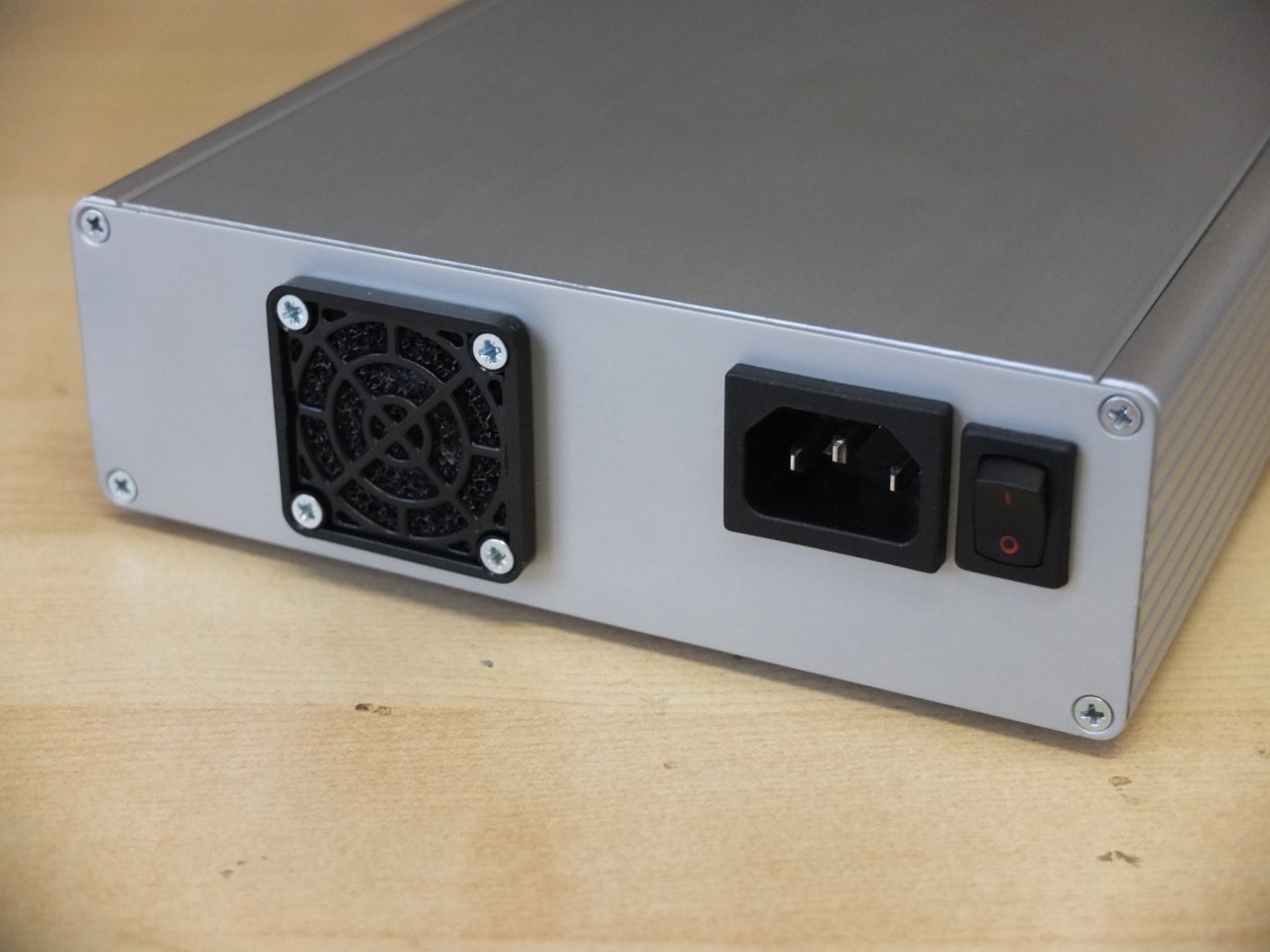

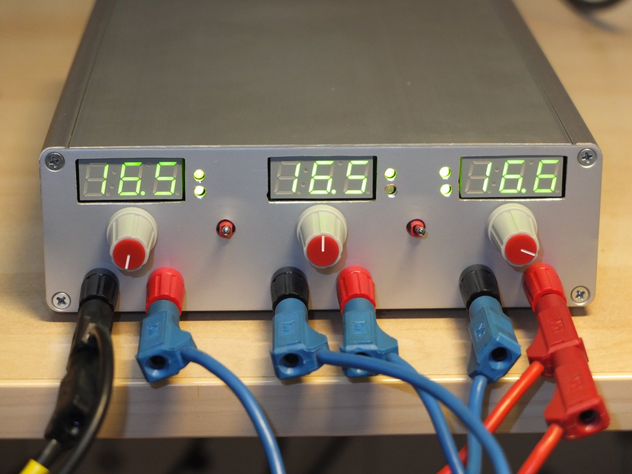

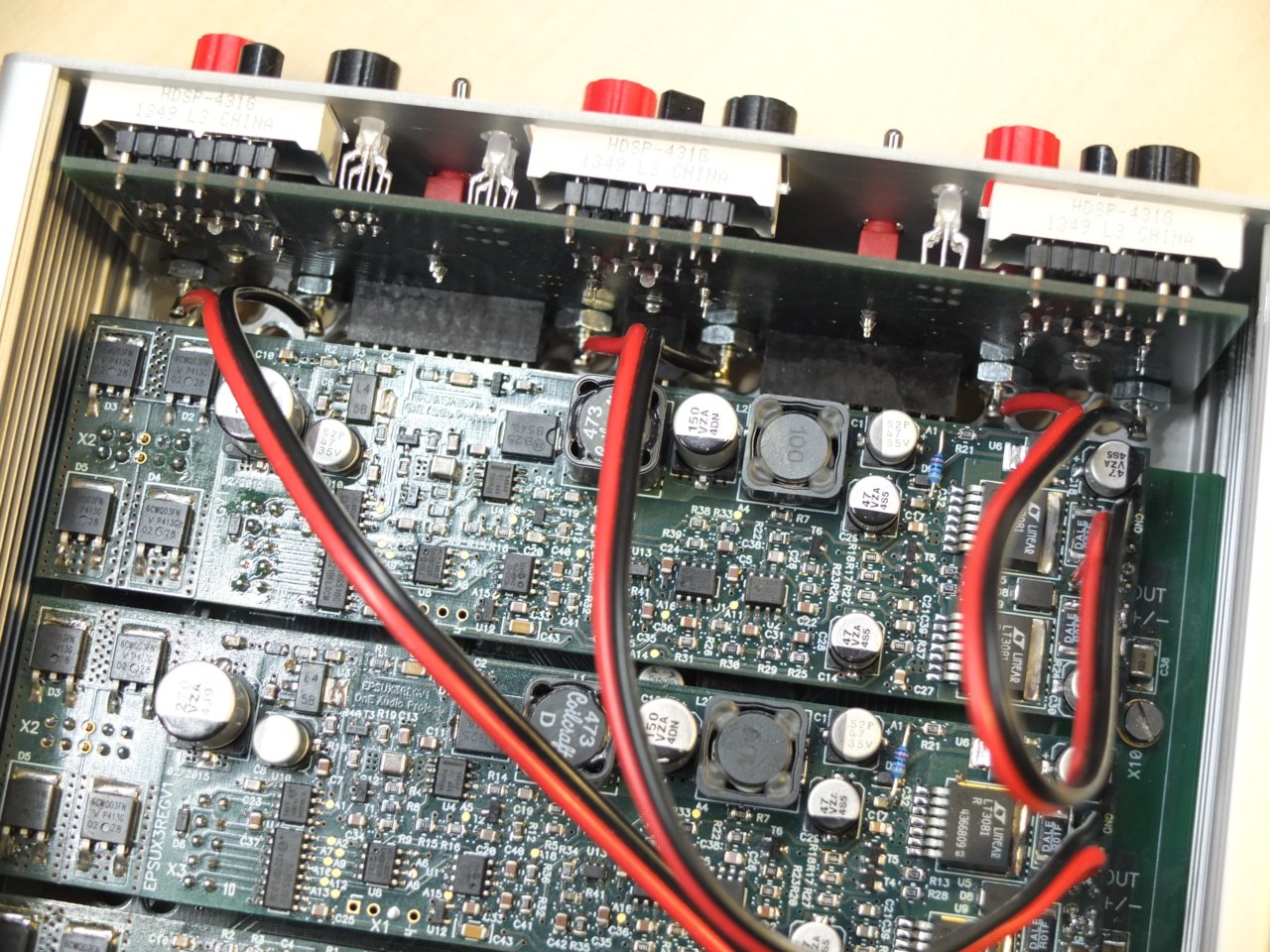

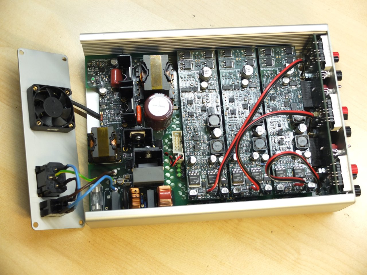

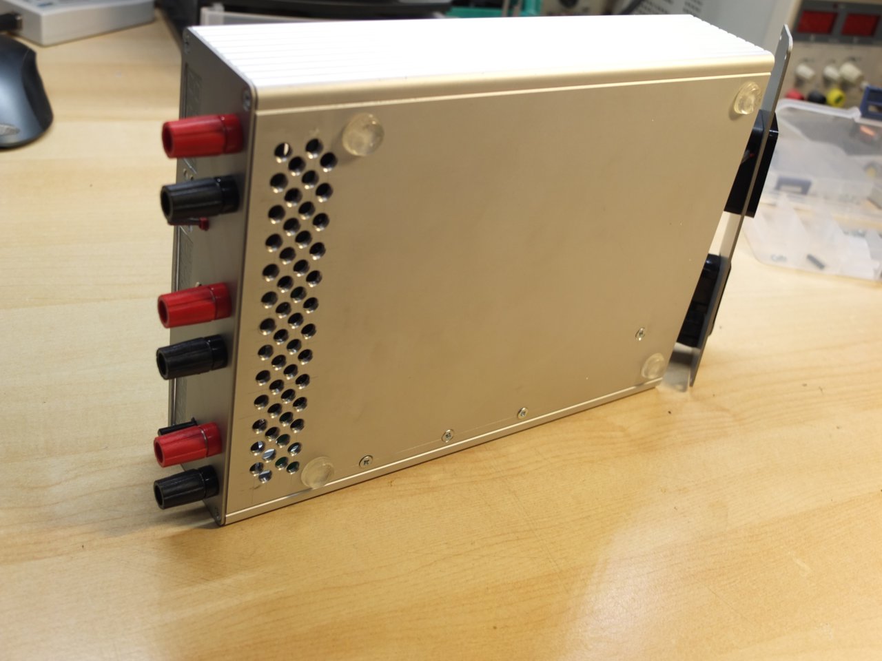

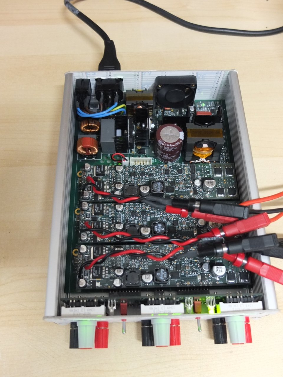

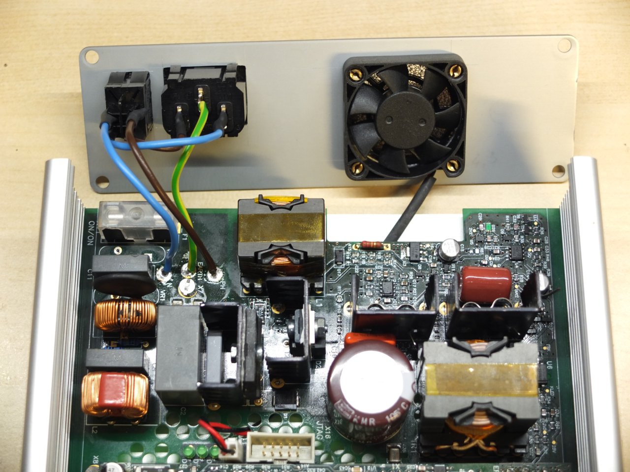

In the box !
Hello all,
All circuits boards are now mounted in enclosure, and all fits very well.
All internal wiring has been made also.
After these mechanical check, i did a thermal test at maximum power
(three outputs in series at 16.6V and 3.2A for 160W at output).
This test lasted for 4 hours at full power successfully, and the internal
temperature has reached 52°C (Tamb=22°C). At this temperature,
the fan is not at full speed.
I'm very happy with that result, the forced air flow seem to work well.
Of course, bottom front openings are very important...
Some pictures below of the mounting and test.
From now, i will continue on working for Lexan panels designs,
and also on some CPLD improvements. I think to switch wirings of CH1 and CH3
on front panel to avoid long output wires and keep them more away of all
magnetics parts that could be coupling with outputs wires.
I plan of course to do some extensive measurements on finished PSU.
Frex
Hello all,
Frex
