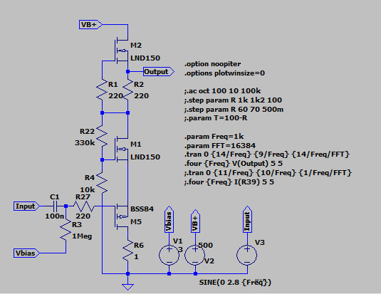

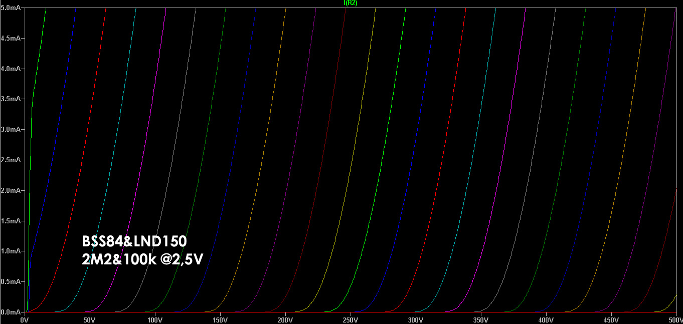

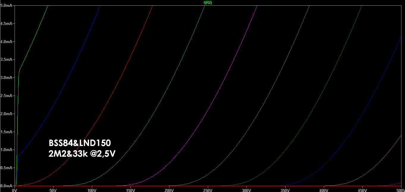

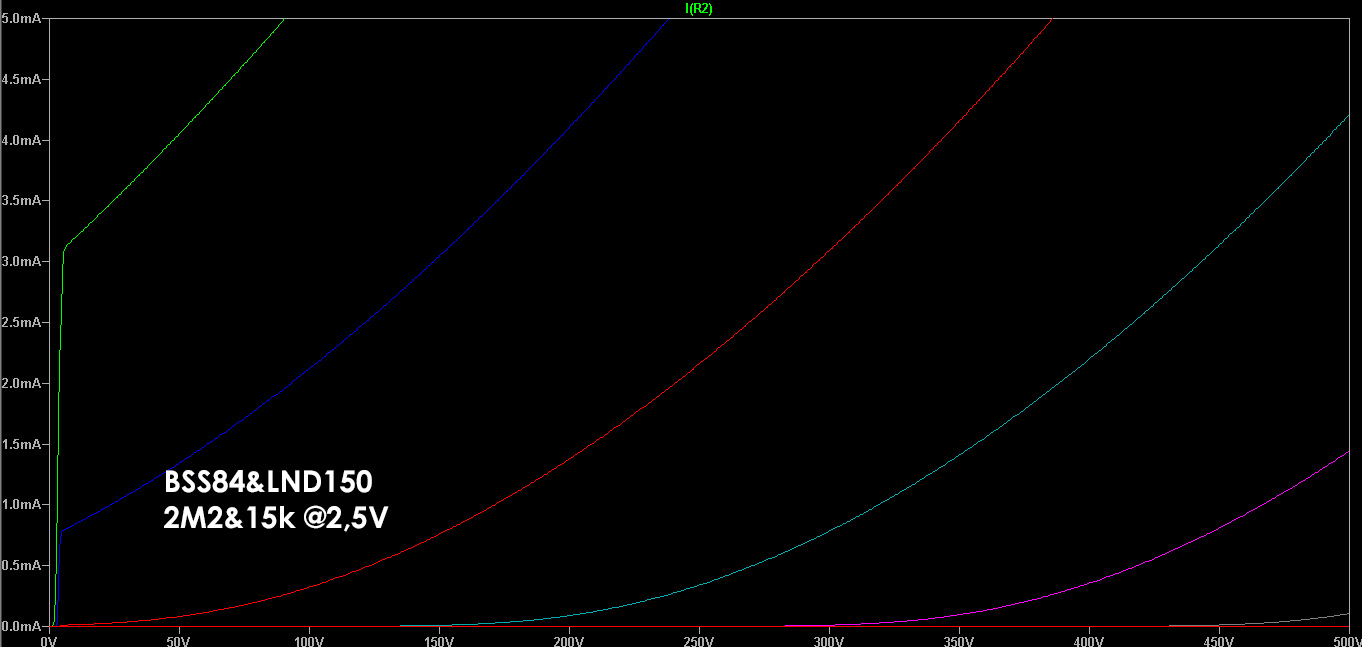

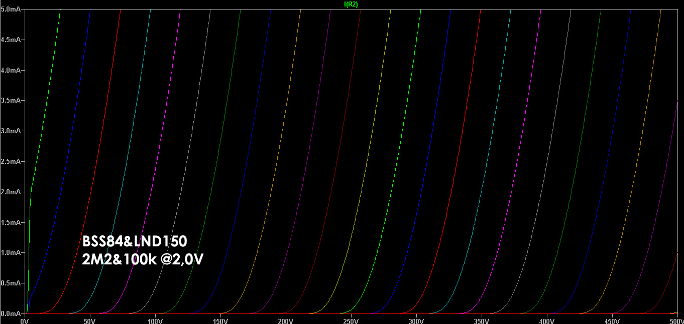

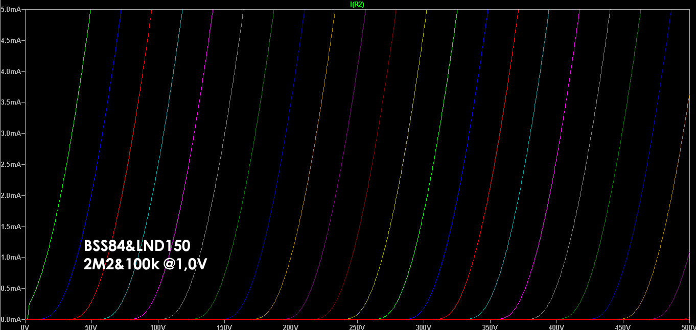

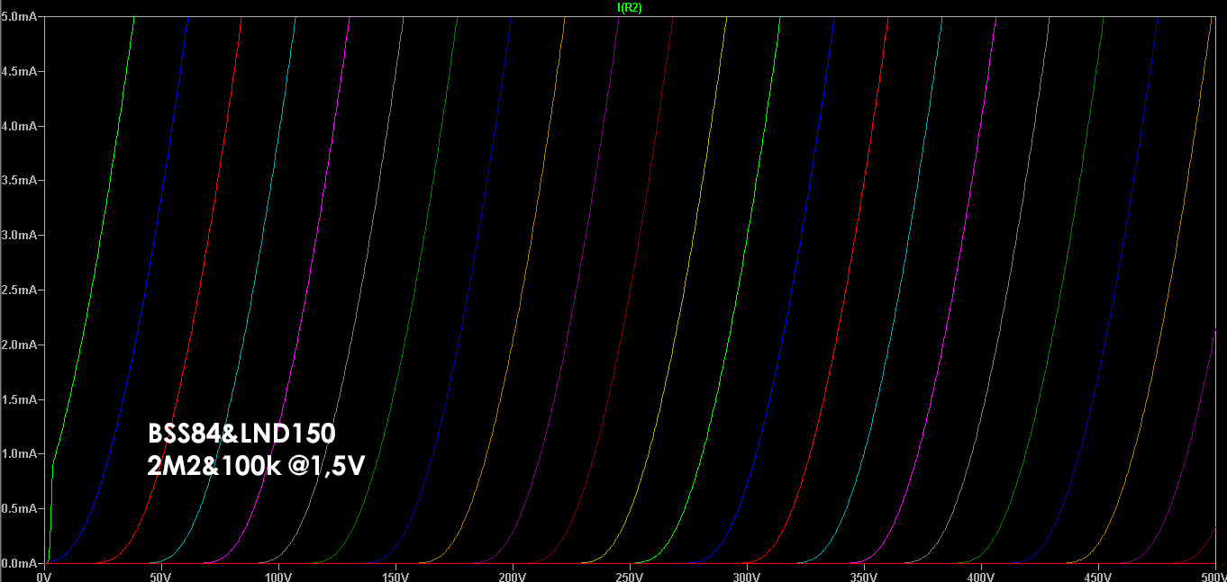

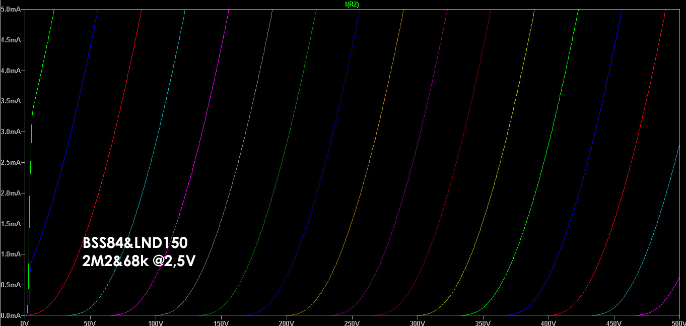

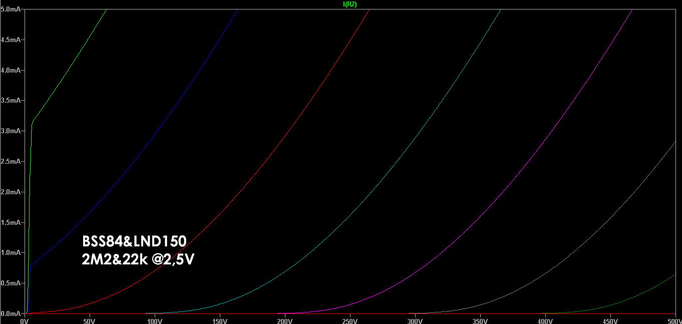

Hi, waiting to test the sound of the amp in reality, I post here some curves of the item in different configurations (as shown on each curve):
late to game ...... Boyz in tube Forum beat that Issue to death, our brave George was certainly one of them
Trioderizer arrangement is well known, while fact that you're driving it with/to Source (with "upside-down" mosfet) is Cherry on top
in fact, Papa's DEF circuit, (as origin in thinking of ) in my SET amp - where depletion mode part is replaced with Schaded mosfet, is sorta same arrangement - drive is pretty much hybrid of gate/source drive, at least when thinking of Schaded mosfet modulation
in any case, nice thinking
just use - in simulation, load value of much lower size, that's more like it is in real life
if preamp stage is in case, think of no more than 50-100K, as usual Rin of next stage (amp)

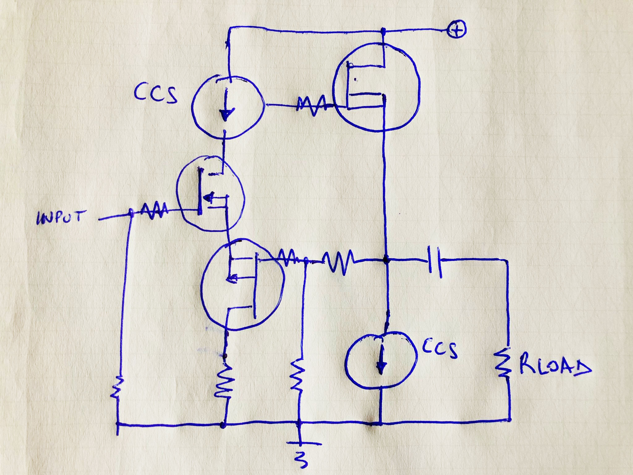

This one: https://www.diyaudio.com/forums/att...-curves-channel-dmos-triodized-gain-stage-jpg
Top nmosfet need to swing 50V and 10A, bottom pmosfet can swing just 10V and 10A with a small Ciss. Then of course a reliable CCS, but should be easy to be found.

Do you think it would be easier to implement the second circuit ( https://www.diyaudio.com/forums/att...triode-curves-channel-dmos-zintolo-se-amp-jpg ), so that the gain stage can manage some orders of magnitude less of current (so also be easier to drive), and then DC coupled to one or more DC coupled and CCS loaded source followers to manage the current?
In that case I'd drive the n-mosfet and the p-mosfet would give feedback.

Driver could be a LSK389 as matched nmosfet with another small pmosfet on bottom and a resistor as load, then a big source follower to drive the speaker.

What is the benefit of a nmosfet with CCS to the negative rail vs pmosfet with CCS to the positive rail?
The reason of my question is that I have the CCS to the positive rail on the preamp (so good rejection to PSU noise) and I would keep the same to the "power follower" to improve the noise rejection. Of course I would ground the negative rais (as in the schematic) and refer the speaker to ground as well.
That would be fine! The main point is to have the speaker in parallel to the active transistor, not in parallel to the current source. N-channel FET’s are cheaper and more available though, and might be

amp itself is not feeling difference of where load return is , as long it is functional GND
be it "real" one or virtual
any enough unmovable potential can be used as "GND"
so, speaker return can go to real GND or to other rail , as long rail is stiff enough
resulting noise and ripple at speaker terminals is separate issue
