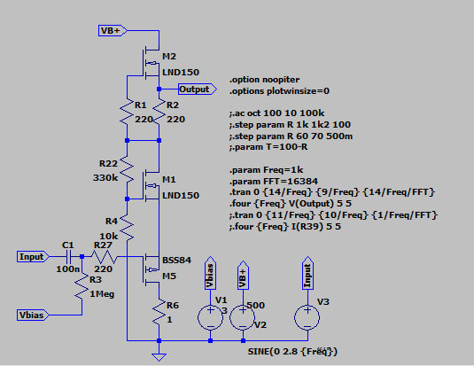

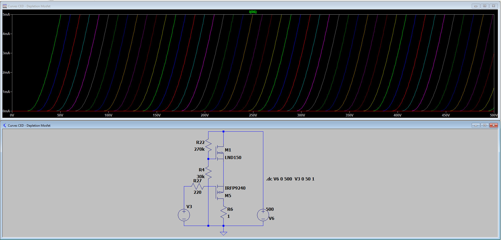

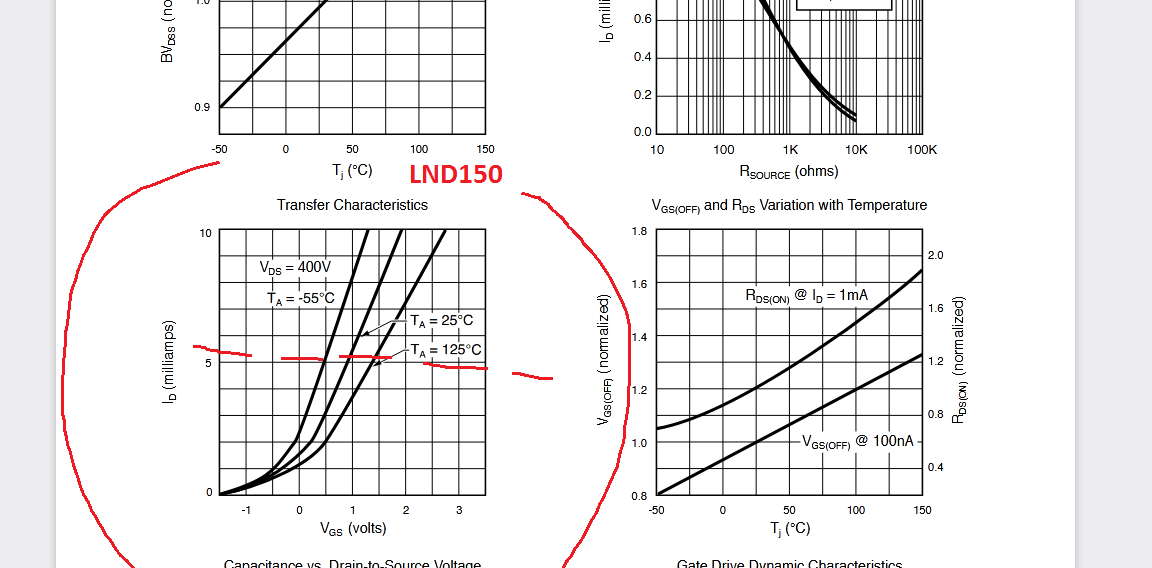

I would like to ask your comments on a design I've implemented on SS starting from George (Tubelab) UNSET (see details on dedicated section of the forum).
Driving a N-channel Depletion-mode DMOS (I've used the LND150 because they work well with high voltages, available where I want to implement this circuit) from the cathode through a pmosfet and giving local feedback through a voltage divider from drain to gate to ground.
Curves are very promising, and of course the local feedback (and so the reference gate voltage of the pmosfet) can be modified accordingly to change the curves of the two mosfets.
Of course the same concept can be applied to other SS devices too.
Thanks in advance for your feedback,
Kind Regards

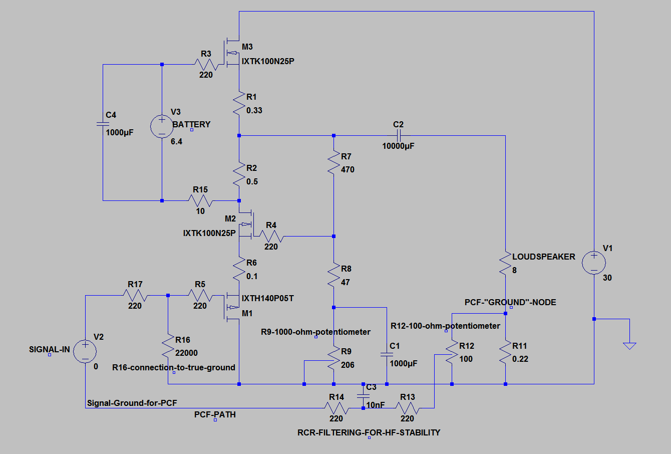

Hi tikiroo,
the pmosfet comes directly from the circuit I use to test the same UNSET feedback on output pentodes. I haven’t adapted to the specific DMOS, also because it can be used with more powerful mosfets too.
The two mosfets have to be considered as a single device, input at gate of pmosfet, load on top o of depletion.

This is the schematic of a possible application as a preamp with 2Vrms at input and 60Vrms at output: a CCS loaded gain stage.

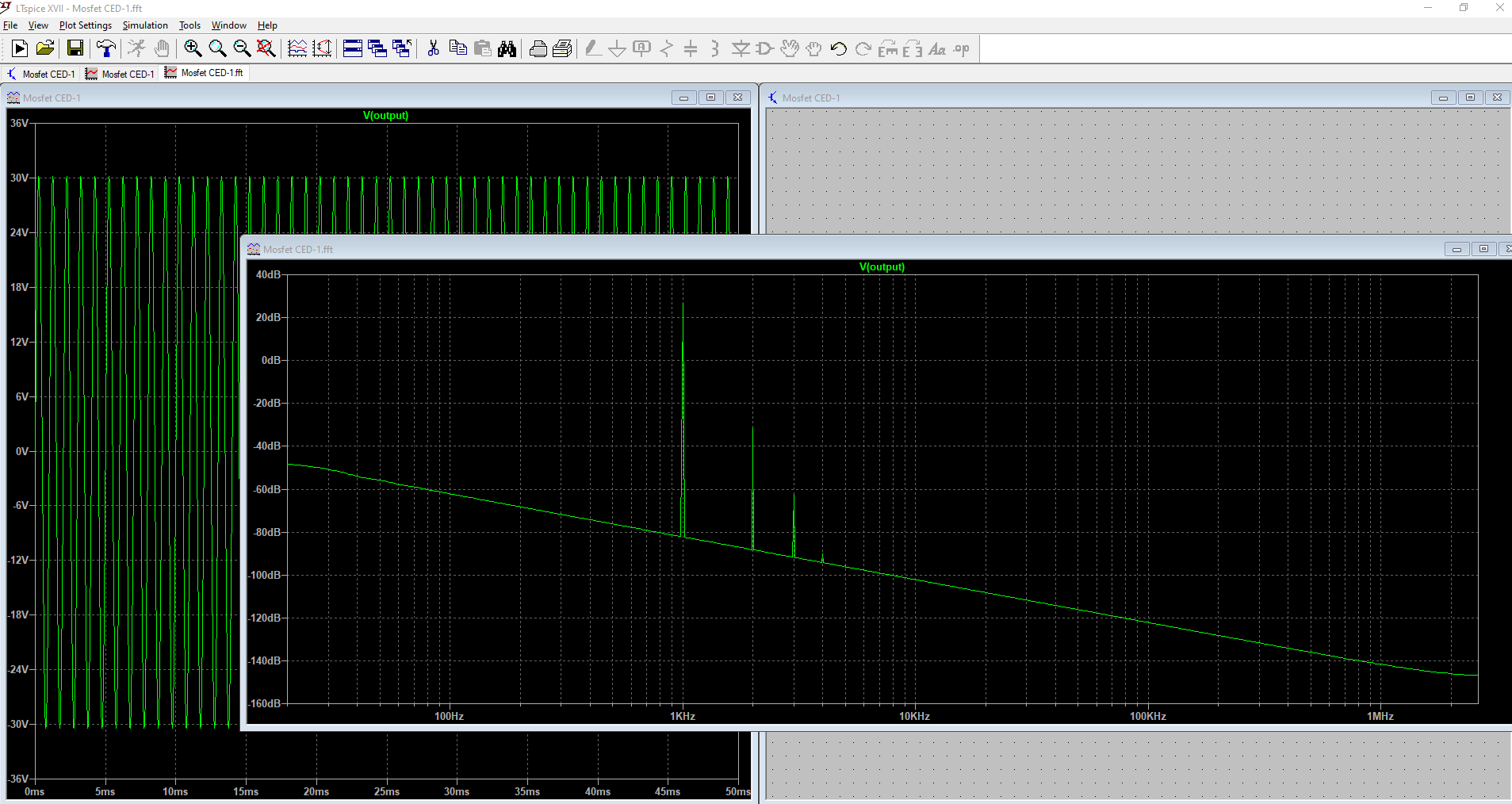

This is the simulation I've got, absolutely not optimized.
What I will try to put together is a single stage SS power amp, class A in SE: more current and way less gain, so more local feedback applied to the upper device compared to the schematic above.
Code:
Harmonic Frequency Fourier Normalized Phase Normalized
Number [Hz] Component Component [degree] Phase [deg]
1 1.000e+03 8.488e+01 1.000e+00 0.09° 0.00°
2 2.000e+03 1.209e-02 1.424e-04 89.25° 89.16°
3 3.000e+03 5.595e-04 6.592e-06 19.19° 19.10°
4 4.000e+03 2.118e-04 2.495e-06 142.84° 142.75°
5 5.000e+03 1.162e-04 1.369e-06 -166.19° -166.28°
6 6.000e+03 5.473e-05 6.448e-07 -170.36° -170.45°
7 7.000e+03 5.211e-05 6.139e-07 179.11° 179.02°
8 8.000e+03 4.552e-05 5.363e-07 -178.95° -179.04°
9 9.000e+03 4.055e-05 4.777e-07 179.16° 179.07°
Total Harmonic Distortion: 0.014260%(0.014236%)

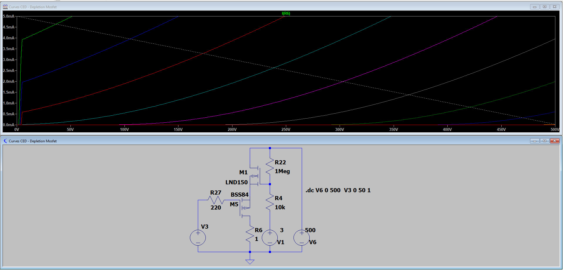

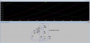

This is the result changing the local feedback voltage divider to 2M2 - 39k, always with 2Vrms at its input and now an output of 110Vrms with a THD of 0.015577%:
Code:
1 1.000e+03 1.544e+02 1.000e+00 0.09° 0.00°
2 2.000e+03 2.403e-02 1.556e-04 89.36° 89.27°
3 3.000e+03 1.085e-03 7.028e-06 17.99° 17.90°
4 4.000e+03 3.850e-04 2.493e-06 143.15° 143.06°
5 5.000e+03 2.118e-04 1.371e-06 -166.45° -166.54°
6 6.000e+03 1.003e-04 6.495e-07 -170.27° -170.36°
7 7.000e+03 9.481e-05 6.139e-07 178.39° 178.30°
8 8.000e+03 8.365e-05 5.416e-07 -179.69° -179.78°
9 9.000e+03 7.412e-05 4.799e-07 178.77° 178.68°
Total Harmonic Distortion: 0.015577%(0.015555%)
I can see it working well as a voltage amplifier, although there is still no actual load on the circuit in post#6. The LND150 has very low input capacitance. As a single stage power amplifier (choke or transformer loaded?) I wonder how well the resistor feedback will drive the high gate capacitance of a decent sized mosfet, this is the big difference to deal with compared to a pentode.
Then you would need to see if there is any advantage compared to just driving the gate (will be low impedance due to local feedback) via a source follower.
Thanks for your feedback tikiroo,
the local feedback voltage divider can be scaled based on the voltage and current capability (and input capacity) of the n-mosfet: with 60V and a device able to deliver 15A, the divider can be 330-33 Ohm.
The advantage of the p-mosfet on bottom is that the p-mosfet shares part of the power in class A (proportional to the feedback ratio), so the system (p-mosfet plus n-mosfet) can run at higher currents with the same voltage supply.
yes you are right, its output Fourier components are surprisingly similar to a linear triode, at least inside simulation.This is the schematic of a possible application as a preamp with 2Vrms at input and 60Vrms at output: a CCS loaded gain stage.

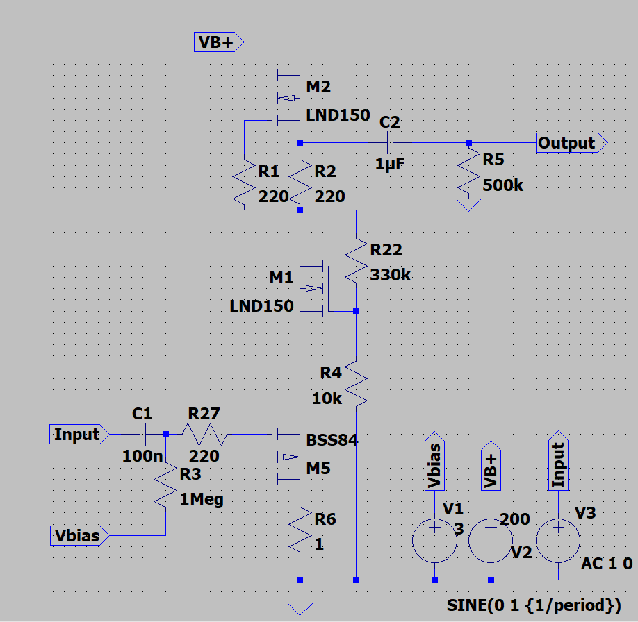

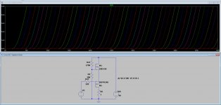

Thank you sulcorebutia,
it is like "Shade's" local current feedback, but here in voltage.
The first advantage is that the input impedance is very high and with a very low capacitance, so it is very easy to drive it.
The second one is that by changing the voltage divider ratio you can "select" the triode characteristics.
R22 can be connected to the left side of C2.
LND150 seems a good candidate for preamp, LND250 could be for higher current ones, but others should work as well.

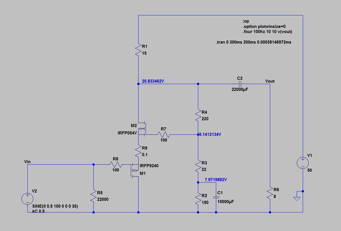

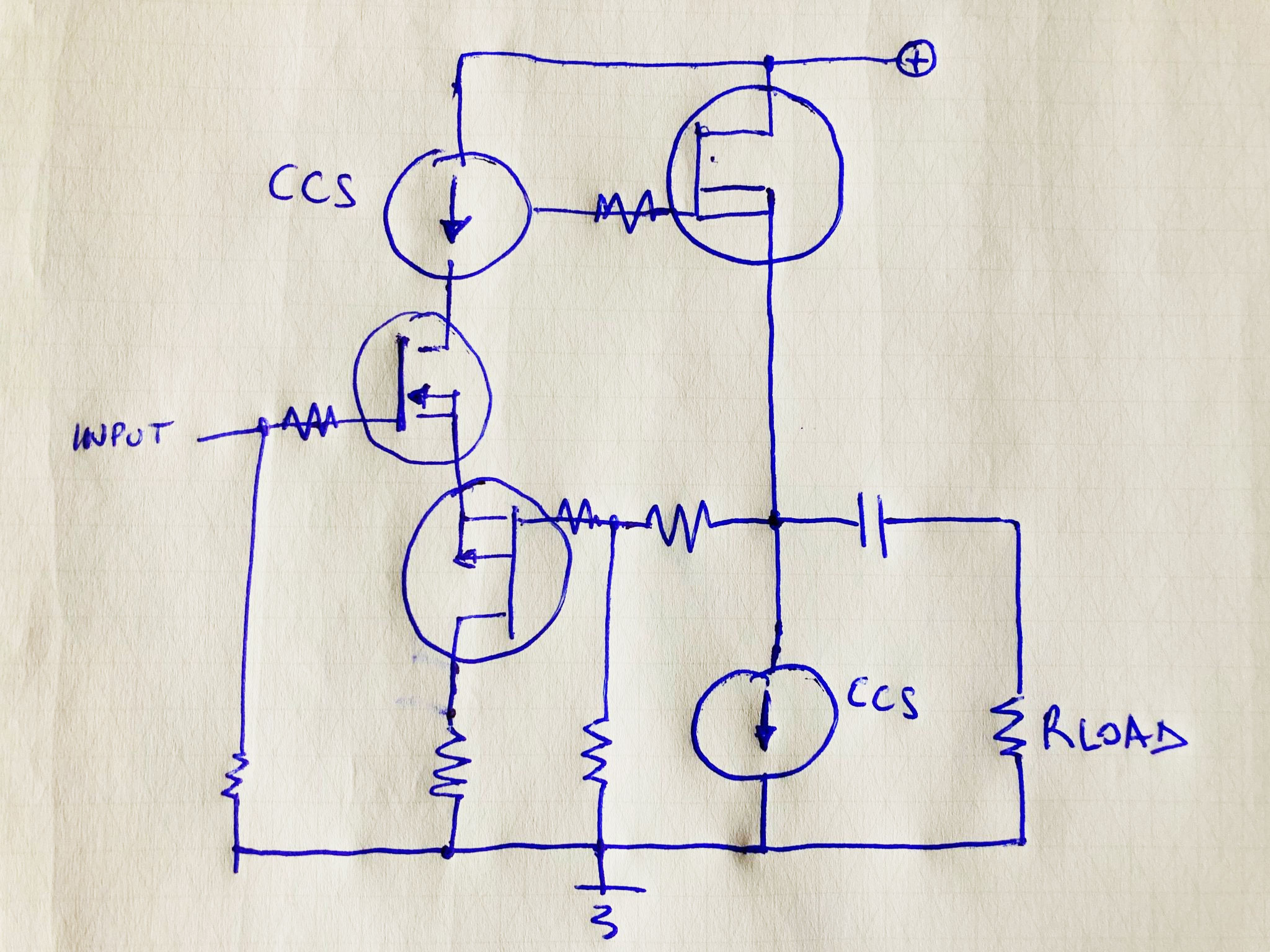

Again during my morning shower I think I've found how to make it a single ended amp, keeping the same configuration but inspired by SpreadSpectrum's Corona amp (Corona: An Ultra-Low Distortion A2 DHT SE Amp Prototype ):
So the nfet is driven directly to its gate, and loaded by a CCS to have a very high gain. DC coupled to this there's a CCS loaded source follower (of course there can be more in parallel), and its output gives feedback directly to the pfet on bottom of the nfet driver.
It becomes a single gain stage amp with local feedback.
Being the gain of the driver very very high (a CCS loaded nfet), the amount of feedback is very high as well, guaranteeing very low THD.

One version I built.
This circuit is called a "bastode" and it is a diff pair but with dissimilar devices.
I explored this idea back in 2016 and it works great, with a very triode like sound character.
I used the bastode circuit to experiment with positive current feedback, but it sounds great without it.
There is a lot of information about the bastode circuit on tubecad.
Here is a much less complex version.
The resistor loaded version has a lot of distortion and does sound a bit "warm" and "thick". The distortion values gets much improved with a constant current source or "MU" modulated current source.
