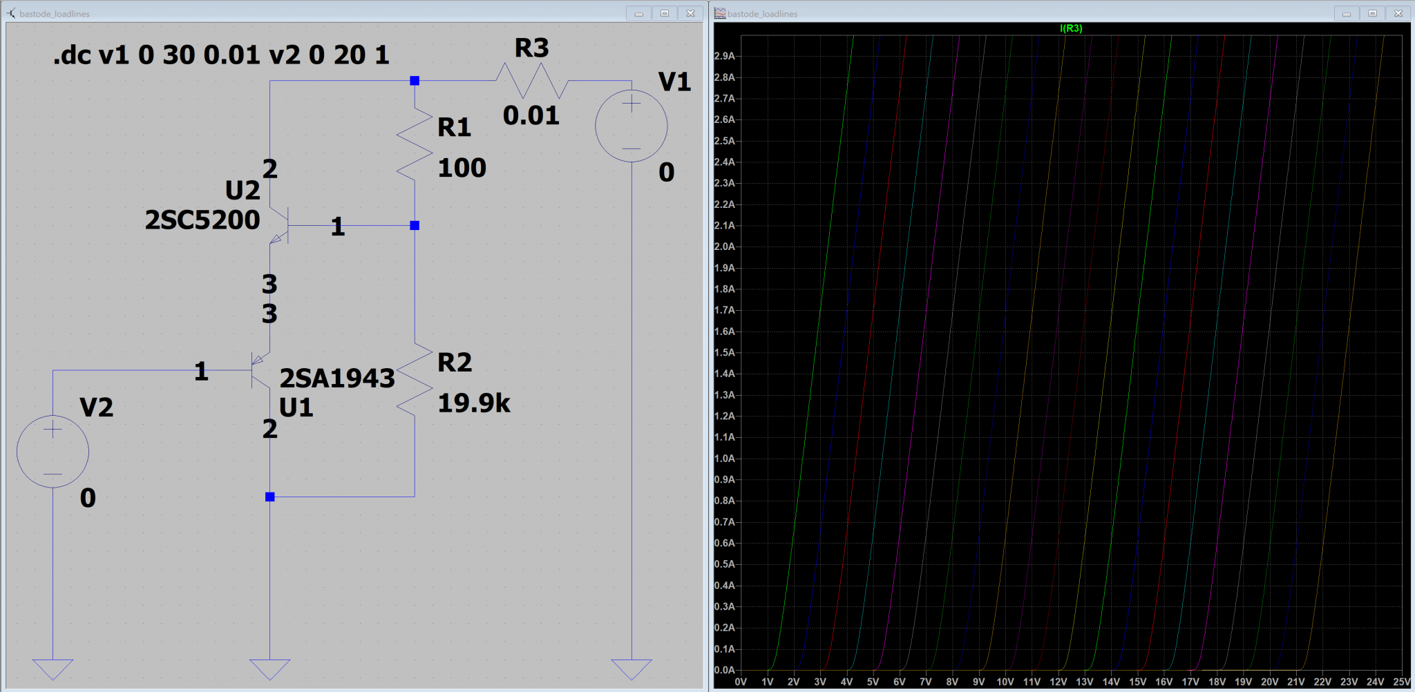

How did you manage the high input capacity of the mosfet?

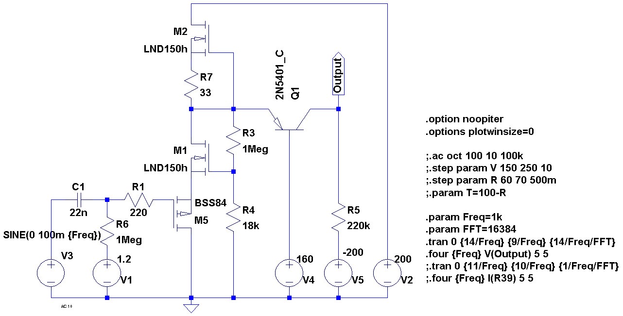

Hi sulcorebutia,
you can get more “real triode imperfections” and more gain by increasing the R1/R2 ratio.
The bottom p-mosfet needs to take care of the full current, but less than 10Vpp. It can indeed have different characterystics than top n-mosfet.
I’m indeed looking for a low Ciss p-mosfet able to drive a n-mosfet.

This is another option with strong 2nd harmonic and other harmonics 60 dB below 2nd.
It is inspired by Rod Coleman's shunt cascode and absolutely not optimized.
This is the result with 100 mVp at its input:

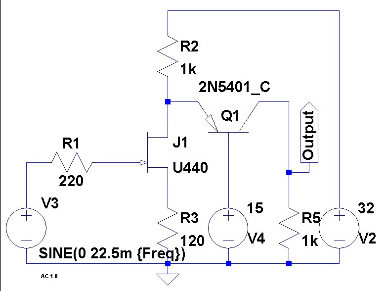

A semplification of the circuit above, with low output impedance and 14 dB of gain with a very predominant 2nd harmonic with negative phase.
The working principle, inspired by Rod Coleman's Shunt Cascode, is the following: V2 is fixed via a filtrered SMPS, V4 is fixed as well through a 7815, so this makes R2 a CCS.
J1 works with local current feedback through R3, that also contributes to its polarization. J1 drain voltage is kept fixed by Q1's emitter, and this increases the bandwidth of the gain stage. The current flowing through R2 must always be higher than the current that will pass through J1, because the output signal is due to the current flowing through R5 multiplied by the resistance of R5, so I(R2)-I(R3) multiplied by R5.
This means that once you have obtained the harmonic slope che you like, you can increase the gain by simply increasing the value of R5 and referring it to a negative voltage instead of ground.

This is the harmonic content at an output of 100 mVp:

This at 1 Vp:

This at 6.55 Vp:
