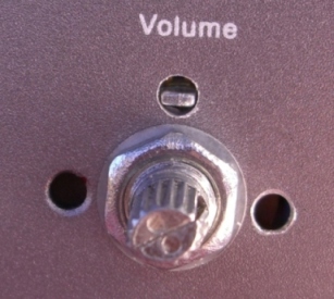

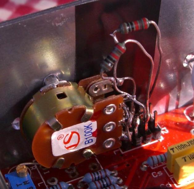

I tried the shunt pot mod on the 100K TA-10 pot today with mixed results. I drilled a couple of extra holes in the front fascia to give me some options with pot orientation. I was going to run separate inputs direct from the RCAs to the (resistors and then) pot, thereafter direct to the jumpers. However, in the interests of a quicker build, I just ran from the jumpers instead.
The thing about a shunt pot is that although the signal has a pretty direct path, the quality of the resistors used and, of course, the vol pot, will influence the final result. I used 10K MRS25 1% metal films which are known to be good quality (my first choice was Vishay Dale RN55 as used in my Alps shunt modded pot, but had none to hand).
I had a bit of a head scratch working out the wiring - seems to be a habit of mine!! 😀 🙄 Suffice to say, the first attempt had the volume pot working "back to front" and getting loud with very little rotation. I flipped the pot around and rewired the other way. OK, so the pot worked in the correct sense :angel: but still got very loud very quickly. Hmm - I've got something wrong here. :clown: Suffice to say, though, that the sound lacked the sparkle or my Alps pot. 30 seconds with the iron later and the mod was removed and it's back to the original power amp config.
Here's a couple of photos - perhaps someone else would like to give it a go? IIRC there is a Panasonic pot that is similar size - is it available at Farnell? Could give that a go. Plan X was fitting the Alps shunt modded pot into a larger case with the TA-10, but it would be a shame not to have a smaller sized case. I still have to investegate whether there are enough CCs available in the TA-10 enclosure to fit the Alps in there, even if it means a new (big) spindle hole in the front face. A new faceplate from the Front Panel Designer outfit might be the way to go here.

............and the other pic...........
You'll be able to work out the wiring fron this, I hope. Input jumper - resistor - pot - output jumper. The earth is tapped from the small pad in the front corner of the PCB by the pot (left side of pic, just visible behind the trimpot).
