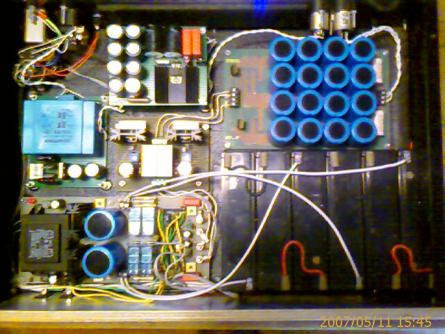

Yesterday I suddenly remembered that I have still got a battery powersupply in the closet wich I made once for my CD player. Haven't used it for years and it seemed that the batteries where still o.k. after a full recharge. It's not a fully battery supply, in fact it is a pack of six 6V/7Ah SLA batteries wich make a +/-18V raw battery supply. This is fed into two discrete stabilasation circuits to make a +/- 12V supply and finally there is buffertank of 16*4700uF caps.
Did it sound better then the SMPS, well to be honest, no. Is it worse, well not in everything. It defenatly sounds completely different than the SMPS. The smps sound a little mored edged (still the biggest problem of the whole Trends amp) so you might think that the battery/stab/cap supply is better, weel yes in that area it is but it's also a lot slower and more closed in sounding then the smps. The smps has more air around it and much more detail and dynamics.
Maybe things will change the next couple of days, i will just let it play this way (if I don't get the urge to switch back to my triode amps) so these are as always only early conclusions.

Why are you using the stabilasation circuit if you could run the 6v SLA's in series to get to the desired 12V -14V. A voltage regulation is probably not beneficial for the sound, but I could be wrong. Could you try it without the voltage regulation but leave the buffer tank in place and report back to us if it makes things better or worse?
Greets,
Klaus
That was exactly what I had in mind.
The stabalizoers where in there because the power supply was origianaly made for my cd player a couple of years ago and I didn't wnat the hassle of the batteries running out while listening to music. I listen to music for about 18 hours a day when I'm at home all day so I wanted it to last longer than that. With the charger on the voltage goes up to about 22V wich is too high or the CD player but I realy wanted it in a way I could listen to it even with the charger on.
The stabalizer isn't soo bad when fed from batteries. Stabs like a clean DC at their inputs as well, just try a CLC network before any typical LM317 or 78xx stab and you'll know what I mean.
In the next days I will try to refit the power supply in a way that the Trends is fed directly from the batteries, with and without the buffertank. At the moment I only wanted to see if it made any difference at all, yep it does, experiment succeeded so far. I will report back.
The never ending story continues,
Yesterday I have tried several different options with the power supply. The batteries with stabs and buffertank is not very good, still much more closed in then the Trends smsps. So I have tried the batteries without the stabs. Better, but still lack of air and dynamics. With the bufertank it's only worse. So I have tried a small buffer of 2200uF Panasonic FC, better, but still. I have to play with it for the next days I guess. So far the battery power is a little bit more quiet than the smps wich is a little edgy but there's one thing missing in them and I would call it the lack of speed. That's about the same conclusion I have had a couple of years ago with the battery power supply on my CD player.
Conclusion so far is that I like the smps better, although it is far from perfect. have to tweak some more here. One thing is very clear and that is that the Trends amp is very sensitive to the power supply as well as other surrounding components.

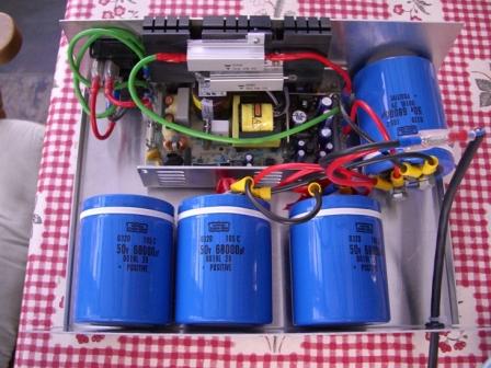

I can only confirm what SJEF says. I have a modded Trends with the stock power supply. Unfortunately I also have chronic voltage sags which the T doesn't appreciate. Obviously there's some work to be done here to provide a nice clean steady supply.
It's a lash up at the moment. I've run out of terminal rings, so can't make up the fly leads for the fourth cap. I've just finished it, and haven't powered up, but it's 3 x 68 000 uF Nippon Chemicon Stubbies off a Skynet 8080 SMPS. I need to rig up the DPDT switch to the big bleeder resistor - in the mean time, I'll be watching these caps!! :hot:
I tried the SLA and SMPS on the scope, but need to have another go to note down the ripple voltage. What a hoot! 😀
