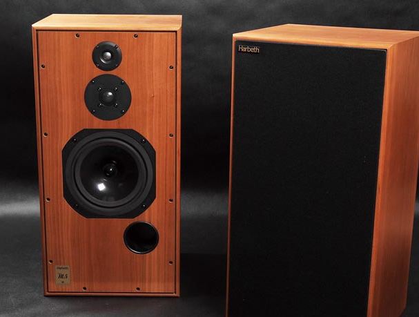

I am not at all phased by complexity or build difficulty, nor is Alan Shaw of Harbeth.
This Harbeth is one of only two ways to do a three way AFAIK:
The other way uses a 4-5" mid cone.

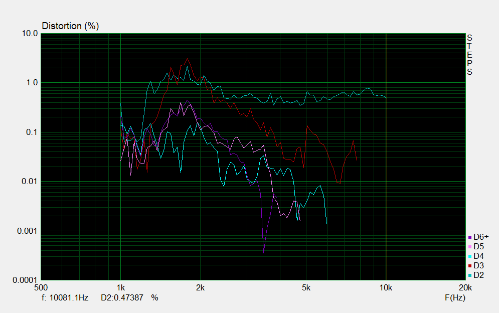

Hi guys!
I decided to try an 18sound ND1090 + XT120 CD/horn combo. After a provisoric setup, I like what I hear. Today I did a distortion measurement and found some strange behavior at one of the tweeters.
The measurement contains the completed filter for the tweeters, acoustical LR4 at 2 kHz, their frequency responses are the same, sound level is fairly loud. There is a big difference in the harmonic distortion, I think this is not normal.
What do you think about that?
Thanks!
Thanks!
It may be worth noting that this nulls off-axis contributions and so ignores those variations. Sometimes treble quality is best judged when it has a well tempered midrange behind it.
This.

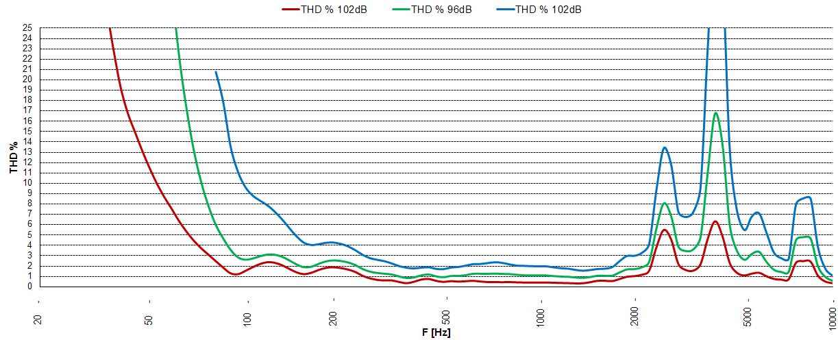

Your 4KHz midrange breakup will have a 3rd order HD peak ~ 1.3KHz. Smack bang in the sensitive upper midrange.
I blamed a Seas 27TDFC tweeter for a similar problem to yours - but it is backed by a Seas L15 with nasty 2.7KHz 3rd order HD. This definitely contributed to the belief the tweeter is "peaky" on some recordings, when it was actually the L15 breaking up. Paring it with a more "muddy" peerless woofer, crossed slightly lower, flatter and with shallower slope did not have the same treble issue, confirming it was the midrange.
I'm not saying your midrange is 100% accountable. Nor the tweeter. but the combination should be evaluated. Leave yourself open to investigate problems elsewhere.
PS: Do you have any particular albums it is more apparent on? PPS: Avoid "greatest hits" and compilation albums. They seem to have the dynamic range beaten out of them with the mixing engineer prone to "amp up" the treble in the mix.

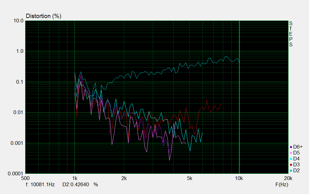

This one looks terrible:
This one, not so bad:
I think you've got a rubbing voicecoil on the first one. Simple as.
Thanks system7!
Yesterday I disassembled the bad looking unit, refitted the diaphragm carefully and the distortion became as with the other unit, the problem went gone.
But today I measured again and the problem reappeared! : D What the hell? What's going on?
The measurement is at high SPL, the lifted distortion is not recognizable by ear.
@ Dave Bullet
I'm not surprised that something was wrong with the L15's voice. Even at 90 dB there is a more than 5% HD peak in the mentioned region. My midrange driver have slightly more than 0.1% there.
Have you tested for consistency between measurements? It is not proper to just trust a piece of equipment, the operator, the controls or the circumstances.What's going on?
I am still full of 'Flu, and slightly delirious, so maybe don't take me too seriously. 😱

The latest measurements are for the newly acquired ND1090 + XT120, not for the SS Illuminator.
@ AllenB
Multiple measurements, same results. The other unit doesn't produce that type of strangeness.
@ AllenB

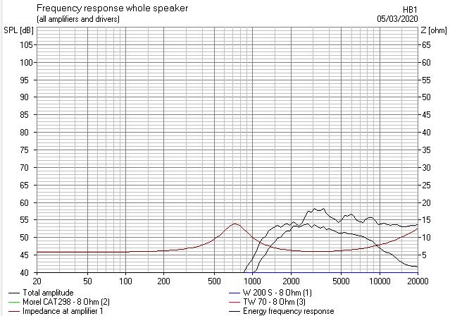

I have done a bit of electrical Impedance correction work on the Morel CAT378:
By the best of my estimates, we need an LCR of 1mH, 47uF and 10R here. Plus a Zobel of 7.5R and 2.2uF.
