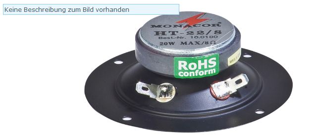

Much better was when I worked my 4th. order crossover magic on a cone tweeter:

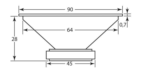

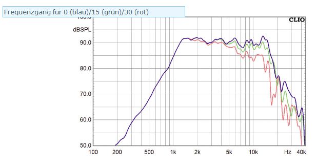

A few details about the Monacor HT22-8 cone tweeter:
Musical to the max. No fuzz and distortion. Gets you in touch with your inner "Barry White". I don't know what to call it. Slam and attack?
